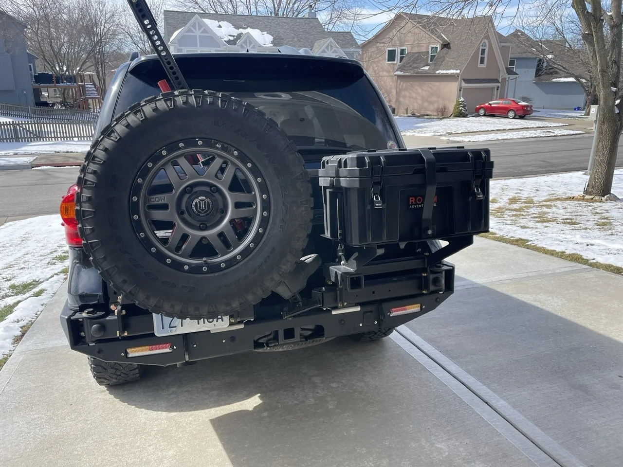

I like my new Dissent rear bumper and am getting ready for a trip next week and was looking at where I could lift on with my hi-lift. I don’t see any good options. All the surfaces on the bottom are angled. I wish it had integrated t-slots in the side wings. I can use my sliders to lift a rear corner but I’d like other options. Anyone with a Dissent rear bumper see something I’m missing?

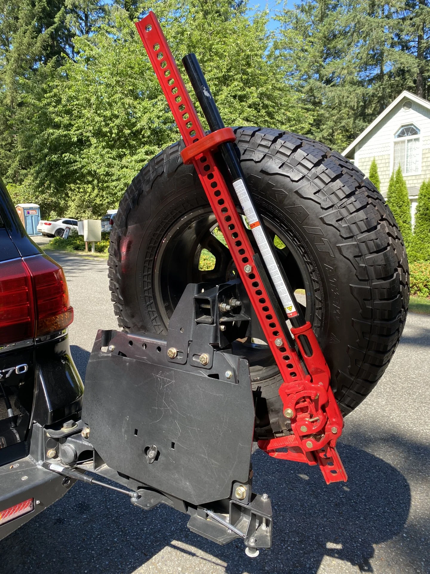

...and any tips on mounting to Dissent rear swing arm? I'm not trying to reinvent the wheel here.
The dissent swing arm comes with a high lift jack mount.
Yes, I know. Are folks just using a bolt with some washers and then a wingnut? Again not trying to solve a problem that everyone else may have already.

Taking the base off makes it much easier. I just tossed it in one of my drawers. I added some jam nuts on the mount to move the jack a little further out since my tire is a 295

Mine is mounted like @tbisaacs and I take it off every time I put the truck in my garage on the city (it normally lives a life if leisure in a big metal building at the lake). I keep my small impact in the back with a 19mm socket on it.
The recovery situation you brought up is real though. I had such a situation pre-Dissent rear bumper install so it wasn’t really an issue as I could open the upper hatch. However with the Dissent bumper and swing outs I would’ve been unable to get into the back. My solution is an accessory box that I keep my recovery gear and tools in mounted on the accessory swing out. I may throw my little impact in there one on the trail.

Got it mounted. Also used and offset to make sure it wouldn't hit my tire. Plan to keep a 19mm wrench in my wing to make sure I can get it off if I can't get my rear/drawers open.
