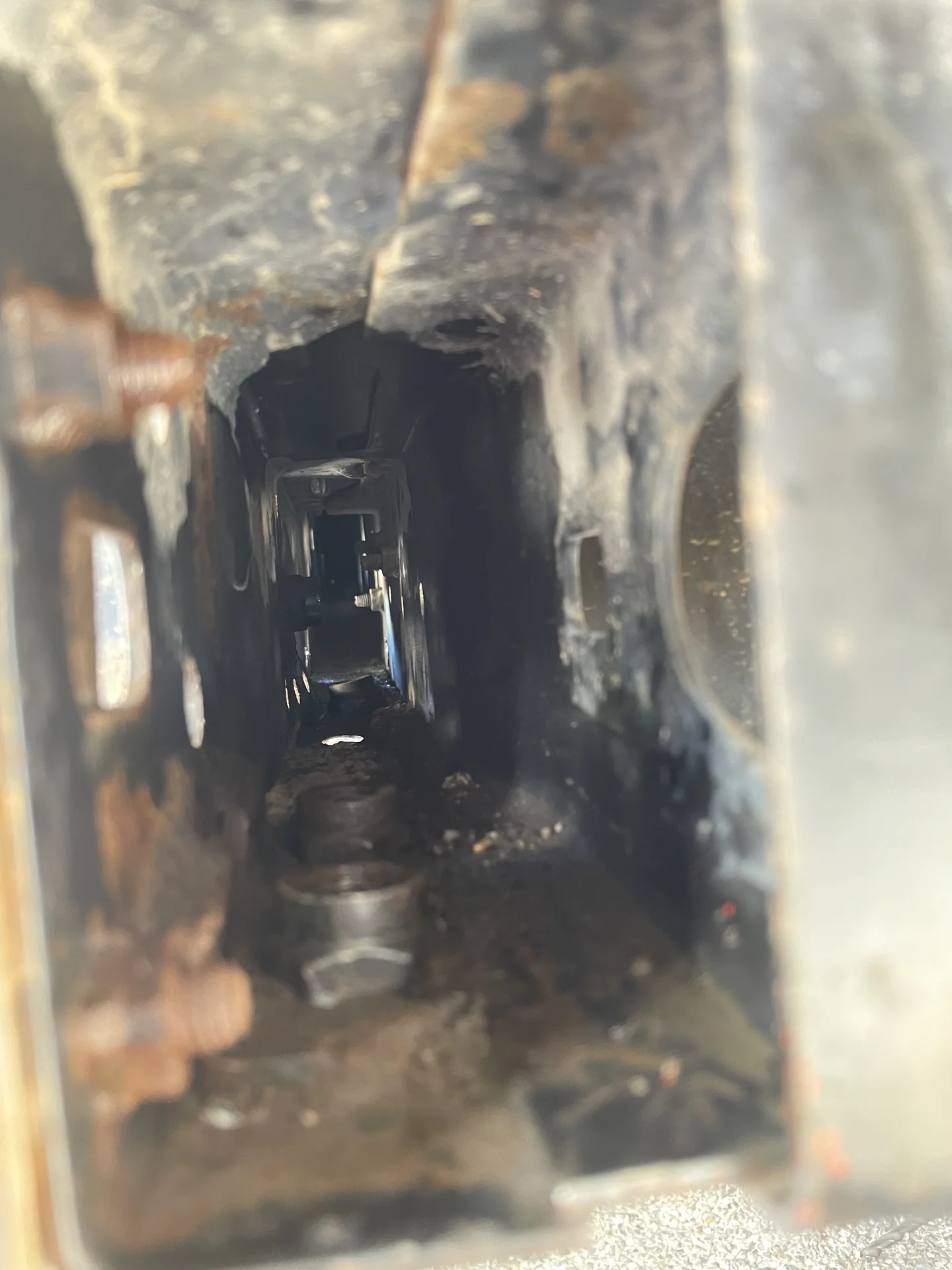

I'm currently in a bit of a situation where I'm trying to install the wings for the Dissent Offroad rear bumper on my Land cruiser and one of the captive nuts came off. I don't think there's a way for me to install the wing while holding a new nut in place on the inside. It's the third/last one that is closest to the front. Does anyone have any ideas on a solution if I want to put a bolt in this w/o a captive nut?
I was thinking maybe while the others go into their nuts upwards, I could place a bolt downwards and put a bolt on the bottom side of the wing instead. Not sure if the best solution but it was the only thing I could think of that didn't involve welding the bumper to the frame.

This happened on my 99. My solution was to weld a new nut (2 actually) to the frame just like Toyota did. Helped that I had a friend with a welder and some skill.

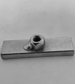

I like that other flat bar idea too. Though, I suggest if you can weld, just weld a nut to the frame.
Cut a hole the size of the nut into some flat bar steel using a step bit. Weld nut to flat bar and insert into frame channel. Had to do this on my. 4X4Labs’s bumper.
