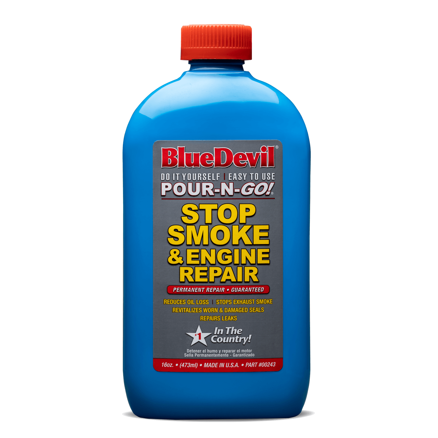

Our 2000 LX had a little blue smoke at start-up when cold when it was about 10 yrs old & 185,000 miles. It is now 21 yrs old & 315,000 miles and doesn't smoke at all on start-up. Not sure how it "fixed" itself, but it did.
You know, come to think of it, I did add some type of stop leak or something. It might have been Blue Devil, but I don't recall. It hasn't smoked in over a hundred thousand miles.

A few have suggested Blue Devil or At205 treatment. Could this hurt anything?

I wouldn't use Blue Devil on something you want to keep driving for a while as it is just a band aid and not a fix. It does work, I used it in the engine of my snow plowing truck and it sealed it up.
AT-205 is a seal conditioner and in my experience works great.
Blue Devil is for head gasket treatment. I used it once and no issues except it killed the water pump seal prematurely (like around 50K miles for an AISIN water pump on my Prizm).
AT-205 is for oil seals and not for ANY form of a gasket. AT-205 will bring back the flexibility of an oil seal so it can flex better than before.
