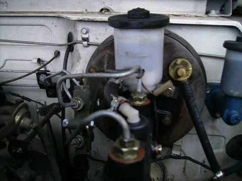

I agree with Sawtooth, in my case I test 2 configurations , 1. 97 4Runner master and booster, works like 3 months(master and booster gone) it work very good but, be carefull if buy it used, 2. 87 fj60 with fj55 booster, currently in duty, added a valve last week :banana::banana:, and work awsome.
here is one pic of the master and booster
