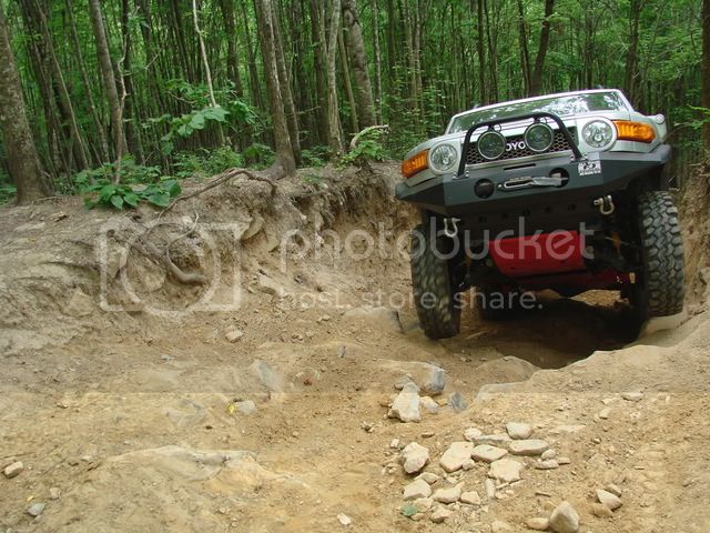

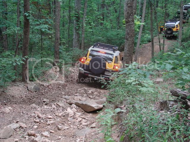

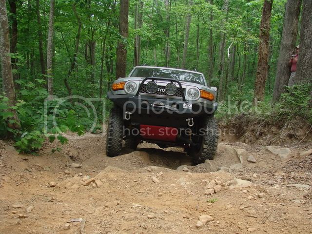

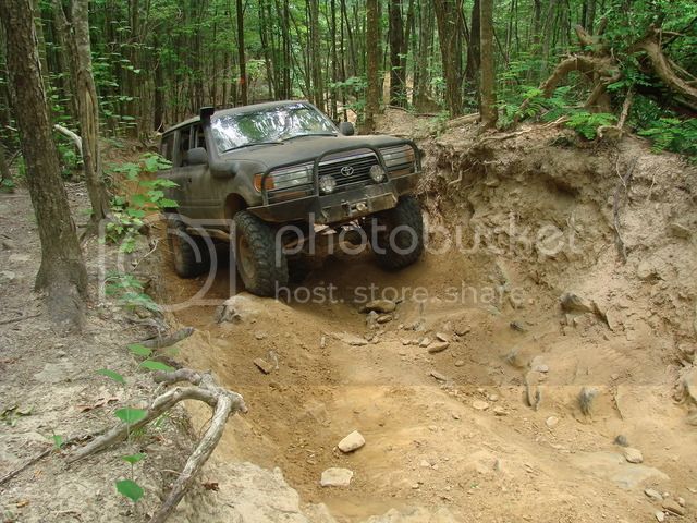

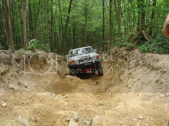

These pics are of the trails before we found the hard one. When this place is dry, the trails are really enjoyable. But when they're wet--I've heard its murderous on vehicles. We had mild weather, a little overcast but no rain.
It started off as a pretty rocky trail and then quickly as the incline got steeper the dirt got looser as we approached the top. About 300 yards from the top I was taking a line that didn't seem terribly difficult terrain, but ATRAC was not getting me over the hump. I tried the locker on and bumped the spot a few times then POW! Something was not right in the rear diff and we suspected the locker was not disengaging. So we winched up to a flat spot just beyond the small ledge I was trying to pass. We pulled the locker actuator to see if we could pull the fork out of engagement. It seemed to be fine but it did move a little with some manual help.

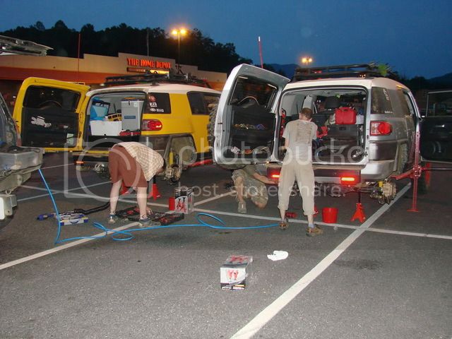

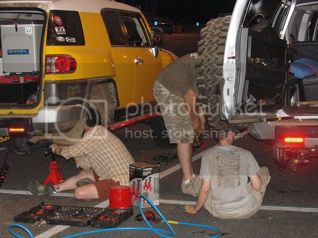

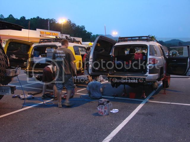

I went through a series of winch pulls and tow strap sessions up the rest of the hill. Then we continued down the trail out and back to town. Me and Lab limped back to the Blairsville Home Depot and purchased jack stands and proceded to tear the rear ends apart. FJCRUZR took off to find gear oil and then the wrenching began. DanKunz directed the activities after getting K9crazy and subsequently the Central FJTT on the phone to get some guidance. We had to drain the pumpkin, remove the wheels, discs, hubs and axle shafts. Inspection of the axle shaft splines didn't show any damage and we pulled the third member out next.
The third member is a real b!tch to pull, as you have to disconnect the sway bar, remove the locker actuator and remove about a dozen 12mm nuts on the case. Then you have to pull a 40-50lb chunk out of the front of the rear diff assembly without breaking your arm or losing a finger. Once that was out DK disassembled the carrier and removed the ring gear, then reassembled the third. I'd lost about 8-9 teeth on mine and Lab lost about 5-6 on his.

In the post with the FJC's in the HD parking lot.
What is attached to the High Lift Jack on the silver FJC? Or I should ask how is the High Lift used on the FJC in that location?
I don't think there is anything attached. It's just under the slider. But the door needs to be open or the High Lift will bang into the door panel. It kinda looks like something is attached, but I think that's because Rick has RED sliders.
