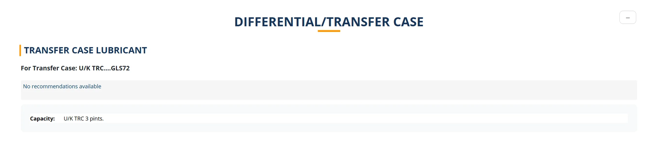

Has anyone done their diff and transfer case oil? trying to get most of the parts now.
So far I got
12157-10010 - Fill plug washer both rear and front
12157-10010 - Drain plug washer for rear
90430-24017 - Drain plug washer for front
OIL
08885-81060 - 75W85 LT
Seem to not be able to find it in toyota parts store. Was wondering if anyone recommends a 3rd party oil
Looking into Motul Gear 300 LS 75W90 - does anyone have experience with this oil?
let me know if I'm missing anything.
thanks :)
