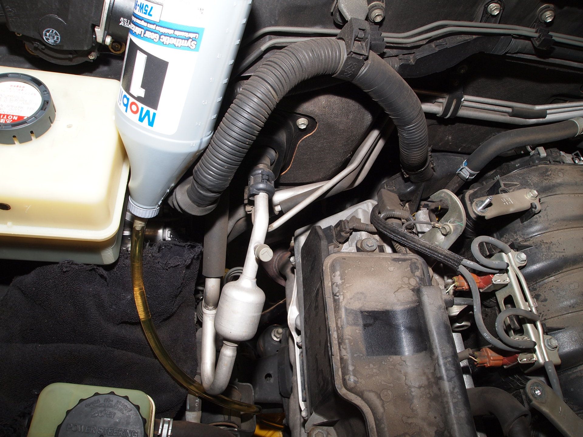

Here's transfer case. Socket is a 24mm which is used here and on rear differential.
PITA pump works just slow.
I like to use my 3/4" drive breaker bar when ever I can to break nuts & bolt loose, make easy work of them.

After filling and letting lube settle for 15 minutes, I check level. Minimum is 5mm below drain plug, or just top again until runs out. Just make sure to let it stop dripping before torquing in plug with new washer/gasket, so not to overfill.
