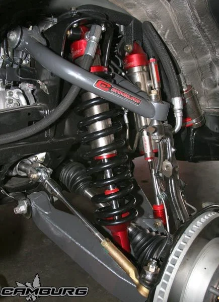

I know I am dreaming..... But, I do enjoy dreaming! I also realize this comes up every year or two. But with all the vendors we have now pushing the market and products....It just doesnt seem that far off to get a long travel system at this point in time. We have the UCA's, we have, the upgraded shocks now... It seems we could take what we have and what has been done for years with the Tundra to get there.... You know like this (minus the coilover):
attachment.php
I mean if you look at the equivalent long travel system for the Tundra:
Total Chaos Long Travel Suspension System for 00-06 Toyota Tundra
I already have the TC UCA's & Radflo's
If you re-index the T-bars to get more lift, then all that would be needed for a long travel system is:
  • Lower A-Arms
  • Tie-Rod extensions
  • Extended Brake lines (already available)
  • Limit straps?
  • Extended Axles to retain 4wd or a diff drop that retains a more stock alignment (1 1/2 - 2" drop vs. 3/4" currently available)
It seems this would give us the lift and travel we want with out all the added spacers and brackets that a standard "lift kit" would have.
