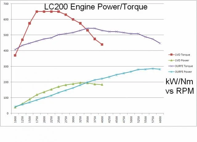

What are the HP and torque numbers for the diesel?
I'd love to see an overlay graph of the two engines dyno'ed.
Not dyno'd, but here's an overlay of the claimed factory figures. I created it and posted it on page 7 of this thread.
attachment.php
