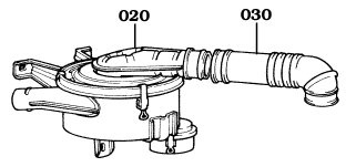

Besides being just plane wrong and insulting , how bad is it to mount an fj40 diesel air cleaner on a 2f?
It’s an air cleaner, there’s zero harm. They are all the same aside from how they mount and the piping. The cyclonic boxes with dust collector is common design shared on gas and diesel trucks for ROW.
Question: why? Diesel parts are significantly harder and more expensive to source, and it would require making extra brackets to mount it
The diagram looks like a 60 series not from any 40 series. They did make a cyclone air cleaner for the 40 series 2F.
These were primarily used in Australia on 40 series. The one pictured above would probably be fairly easy to use on the 3FE in our FJ62.
View attachment 3251014View attachment 3251013
The one I assumed the diagram pointed to is the bj4x. It sits nicely on the passenger side with the same style inlet hose.
My vote goes with the ROW air cleaners for 2F, they are far better (like @Living in the Past posted).
I was looking to do this on my 40 when I was going through the rebuild process, I never found o e for a reasonable price, plus I think there were other mods that would have needed to be done. If I remember right the battery would need to be relocated.
I wound up finding a middle eastern filter housing from a 43 a few hour drive away.
Amayama shows different brackets to mount in a BJ42. The cyclone is very hard to find outside of Australia.for a 40 series. The engine I pictured I bought and is still in Australia. It was purchased to get the air cleaner. By the numbers on the diagram posted this is from SOR's online catalog. Guess if your in Southern California could stop by SOR and maybe inspect what they have. Besides the dust can on the bottom they have a wing inside.

Instead of a BJ42 might try for an FJ60 cyclone air cleaner. Those are made to fit the carburated 2F.
