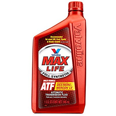

I use valvoline maxlife atf after it was recommended to me by my Toyota mechanic friend although even they(toyota mechanics) debate whether or not you should use atf or power steering fluid. He says Mobil1 is also good but twice the price. I just use a big plastic syringe and remove what's in the reservoir and replace during an oil change and drain and refill what comes out of the transmission plug around every six oil changes. I don't recommend flushing either one. autozone usually has the valvoline for $20 a gallon

I use valvoline maxlife atf after it was recommended to me by my Toyota mechanic friend although even they(toyota mechanics) debate whether or not you should use atf or power steering fluid. He says Mobil1 is also good but twice the price. I just use a big plastic syringe and remove what's in the reservoir and replace during an oil change and drain and refill what comes out of the transmission plug around every six oil changes. I don't recommend flushing either one. autozone usually has the valvoline for $20 a gallon View attachment 1509497
You can do four times better if you want, remove the upper power steering hose from the reservoir, stick it into a empty gallon jug, washer solvent bottles work great.
Jack the font end off the ground, have your gallon of MaxLife, and stick a funnel in the reservoir. Have a friend start the truck, let it idle, have him turn the steering wheel lock to lock, you keep the reservoir full, once you are out of new fluid have your friend shut the engine off.
Button it up, top off if needed, now you have all new power steering fluid and it's good for another 50k.
This not only helps prevent leaks it help the power steering pump lasting longer. Pumps fail because they are either ran low on fluid or the fluid is worn out, either one will fry the bearings.
