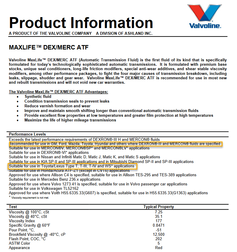

@Jimij - RTFM - read the fine (owner's) manual. I don't know what 'dextron vl' is - but if it's Dex IV, Dexron (not Dextron) III is not considered interchangeable with Dexron IV.
I run Dex III in the trans and the power steering in my '99.
Dex vI is Dex 6, Dex Iv is Dex 4. Roman numerals.
Dex 6 is the replacement for Dex 3, at least in British Columbia Canada Dex 3 no longer exists and has been replaced by DEX 6 (VI).
Yes Dex 4 is different and can not be used.
