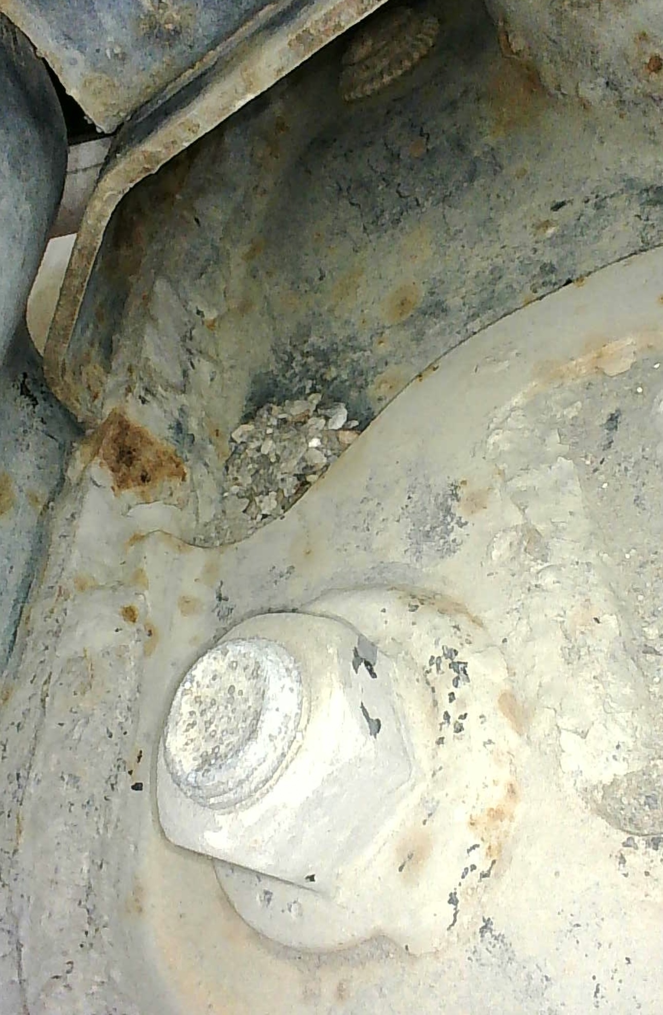

I do use a recovery hitch into the tow bar, I’d like to just get this functional the best I can though, and the wheel carrier probably needs it too. Apparently timeserts are stronger than helicoils so I might go with that approach.
I personally wouldn't go that route without first confirming that the threaded insert can handle that modification.
The threaded inserts I have seen (though not from a 200-series) are not at all like a threaded hole in a plate of steel, or even a hex nut. They were more like a "t-nut" with a little extra steel. Meaning threaded walls far too thin for either operation. Which makes sense, when you no longer need the hex sides of a nut to hold the fastener for tightening. All you need is the minimum steel to keep the bolt from pulling through.
So as not to get caught up around the helicoil/timesert trades... that part of the operation is completely optional and extra, and only to be able to use OEM sized hardware. As you're running a rear bar which requires different hardware anyways, just skip that part. It'll make the job easier.
You're going to need to cut threads a size up anyways. Just use hardware a size up, which will exceed all factory specs.
The only unknown part is whether there is enough meat to do so and I believe there is given what I've seen of frame hardware. Cutting threads is easy and you can always decide if you need to do something different after you do that step.

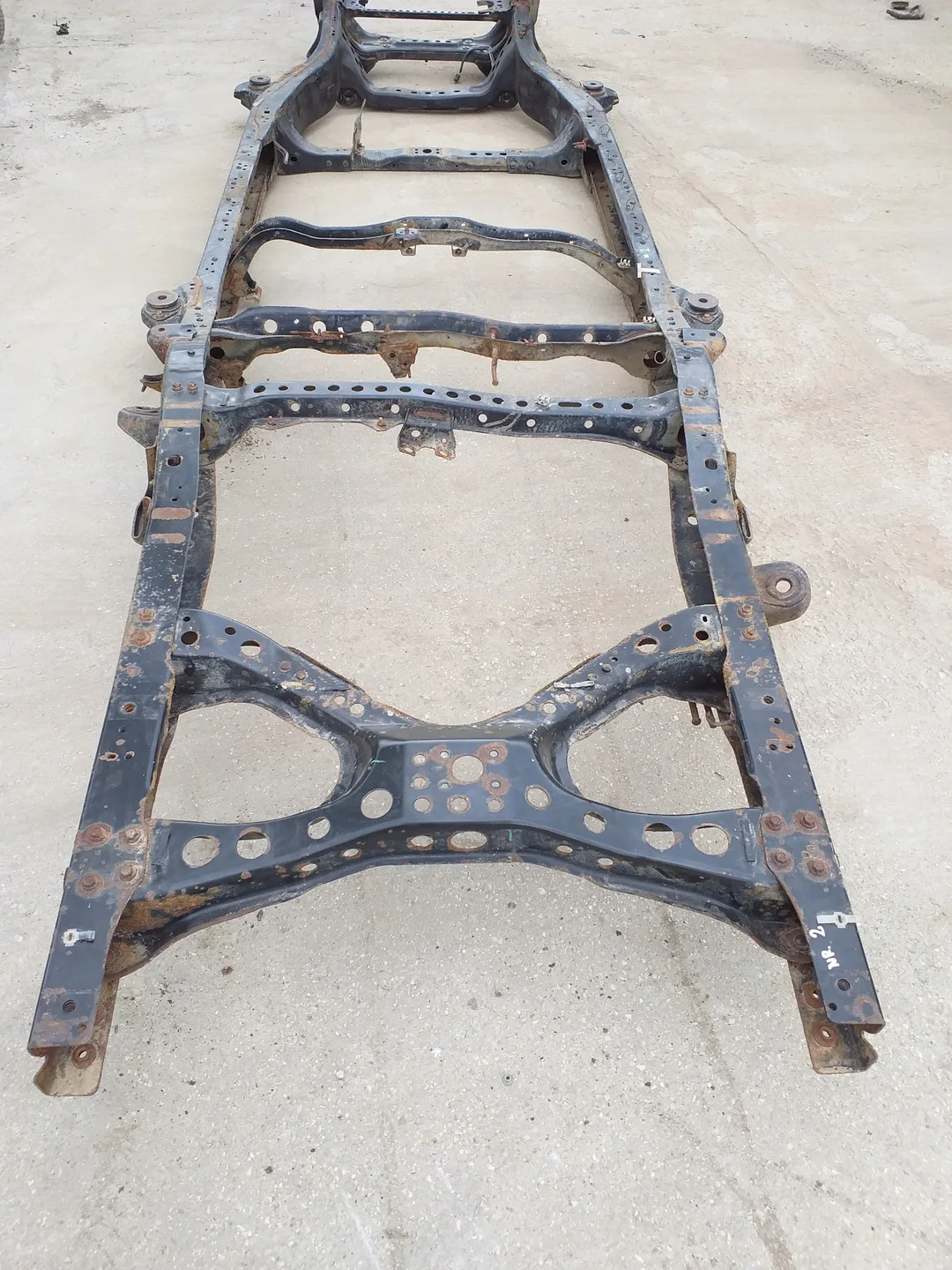

Here's a 2nd gen Tundra frame. The nuts you can see in the c-channel at the bottom are likely exactly the type the LC200 uses being the same generation. Large flange type nuts which is typical of Toyota to better spread loads into the frame.

Nicely done and great to have that confirmation. The open C of the Tundras was the only way I could find a useful pic online knowing our frames are fully boxed.
Good to also see that these captive nuts have more than a slight weld tack.

Decided to go down the helicoil route for now. I’ve just been practicing on some nuts I’ve been drilling out and tapping with a repair kit made by champion. I have a lot of trouble being able to knock the tang out without having the coil also become uneven which just won’t do because it can damage bolts. What might I need to adjust for my technique to not have that problem?
If you’re able, you could also use a longer bolt after heli coil, and put an additional washer/nut on the back side of the fixed nut, for a little extra insurance
Maybe BudBuilt will sell some lollipops that they use to bolt on their sliders?
So reading through the manual, it looks like that point is not supposed to ever be towed off anyway. I put a 13 mm Champion brand helicoil in there. Probably just a not too large but it did work. Bit of a pain because theres a narrow channel prevented proper usage of the provided insert tool, needed to carefully use pliers for that. And because the coil was too long the breakoff tool wasn't going to work - I had to make two hooks out of coat hanger to brake the tang. One was to pull the tang forward, while the other held the other side of the coil in place to stop it from being dragged through.
Anyway got one of them fixed. Will probably fix the other one with a thread chaser since it is holding the old bolt in but the threads are a bit malformed.
