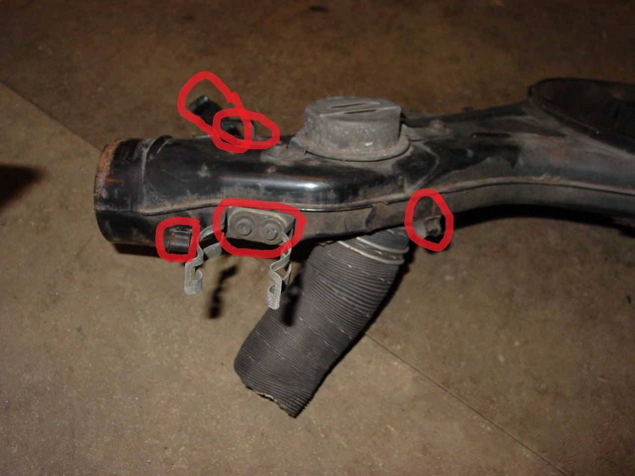

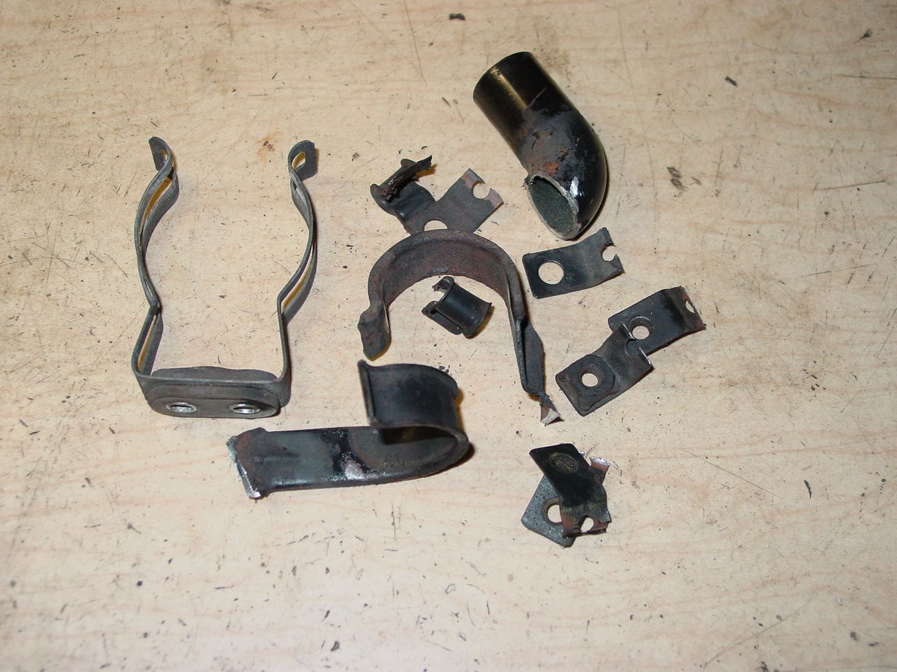

I have read many threads on this topic but no one really covered this. The most I read was "remove unused brackets." Can anyone tell me if any of these brackets are needed? I want to remove everything that's not necessary prior to paint.

I'm referring to the vacuum hose brackets. Can't figure out how to draw arrows with my phone.
In the "how to desmog an fj60" manual it definetly shows some of these brackets being removed I just can't tell which.
The only one you don't need is the elbow on the front.
That is perfect! I might have to tack one back on I got a little excited. Thanks Jim! Do you have some pulleys ready?
