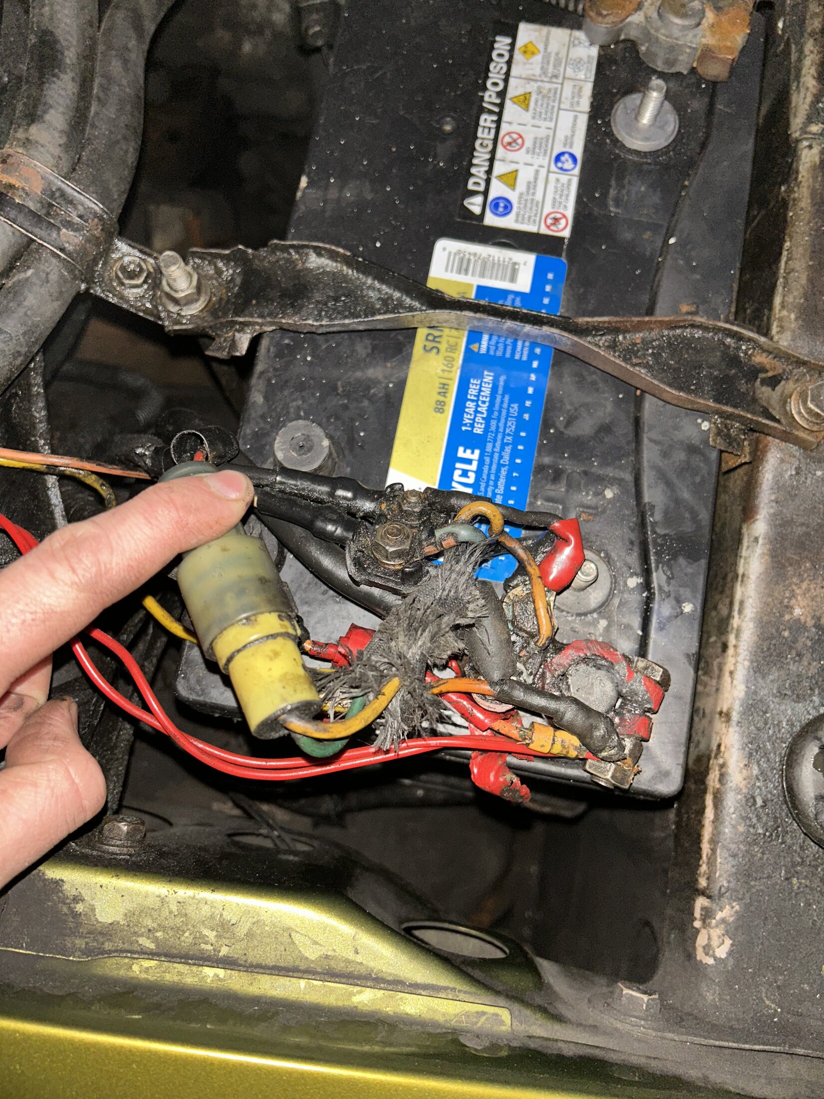

Hello, I am new to the Land Cruiser world and I have a 1986 HJ60 in Canada. I am experiencing an electrical issue that I believe is related to the fusible link A wire, but I am unsure where to locate it. Byt the battery is just a big mess of wires from the old owner. I do not have any power to the headlights and the horn. There also is no power to getting to any of those fuses in the fuse box.
Here is a picture of where I think the fusible link is, but I am not sure what it is or what one. Any guidance would be greatly appreciated.
I won't pass judgment on the previous owner. I will suggest you clean that up with a new clamp and some semblance of order...
The fusible link is the yellow and beige device, that your finger is touching.
