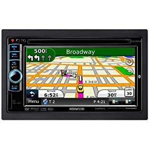

dnx6980
Since this is the definitive thread for Kenwood topo maps, I'll go ahead and add what I've learned.
- DNX5180 does not have any means of loading supplemental maps into the unit
More details here
- DNX6980 supports supplemental maps via the microSD card slot on the front of the unit
I used MapSource to select and download a set of Colorado topo maps onto a microSD card. MapSource created a garmin folder on the memory card, and created a gpsmapsupp file in that folder containing the downloaded maps.
To get these maps visible and functional on the Kenwood dnx6980, you have to power up the system first, and then stick the card into the slot (label facing left). At that point you'll see the Nav unit display the additional map set.
The only gotcha so far is that the maps don't seem to reload automatically when you power cycle the head unit. I have had to remove and reinstall the SD card each time I start the truck to get the supplemental maps to show up in the list. Not ideal, but I'll live with it.
