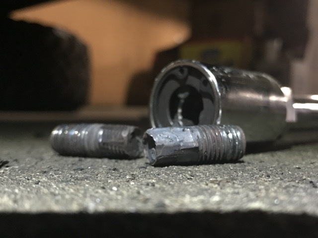

So I went and broke one of the exhaust manifold to y-pipe studs, and there's absolutely nothing to grab/weld to. I've never really dealt with this before, so I'm turning to the experts before I try anything stupid...
heat the flange and try to grip whats left of the stud with vice grips or a stud puller and back it out. that or cut it flush, get some very sharp drill bits and start drilling it out
Best the flange to break the bond on the stud. Then use these with an impact driver

I swear by these. If you have the right size grip, they only need 3/16 - 1/4 to grab
