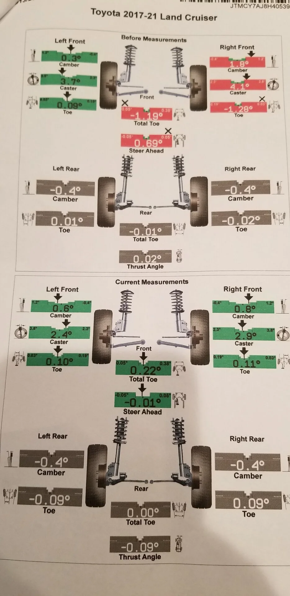

I got the LC back from the dealer with more of an explanation. The LC is now only off by a quarter of an inch.

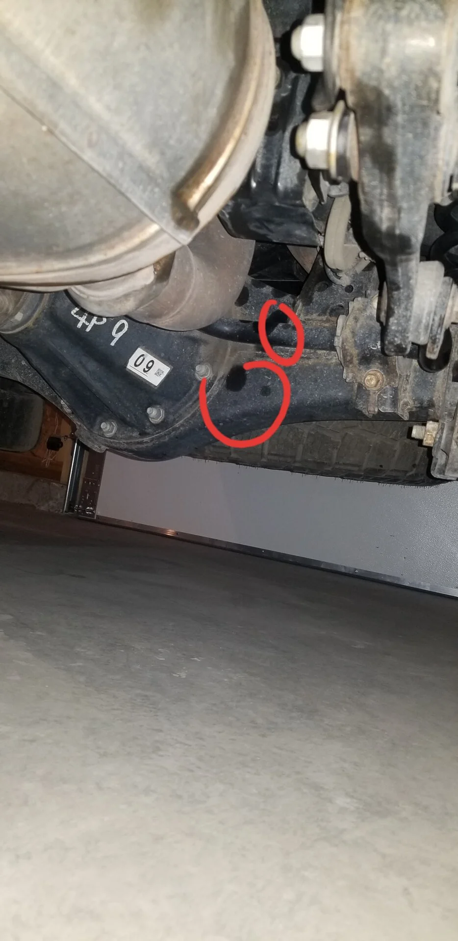

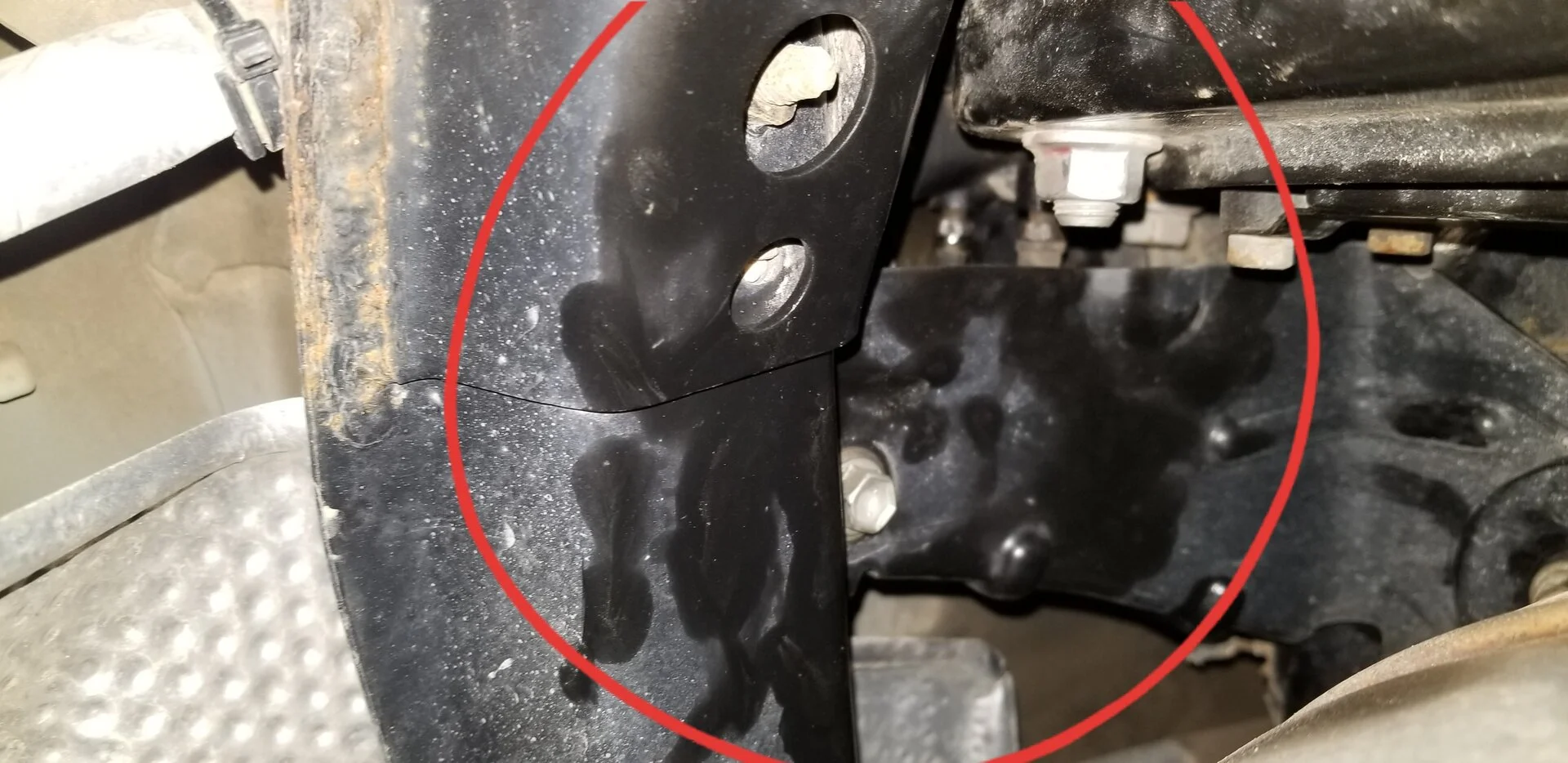

I looked underneath when i returned home. I did notice fluid on the undercarriage. Not much though.🤔
You have got to be kidding me - they opened the KDSS balance valves more than 3 full turns and allowed fluid out?
KDSS is a closed system - no fluid should ever escape it. The system ( if I’m not mistaken) is in excess of 500 psi and needs a special machine to re-pressurize once the system has been opened.

It seems to handle good now. I got under the LC and found what appears to be hydraulic fluid.
I call bogus on the quarter sized amount of fluid. Looks like they opened up the system and it sprayed out.
