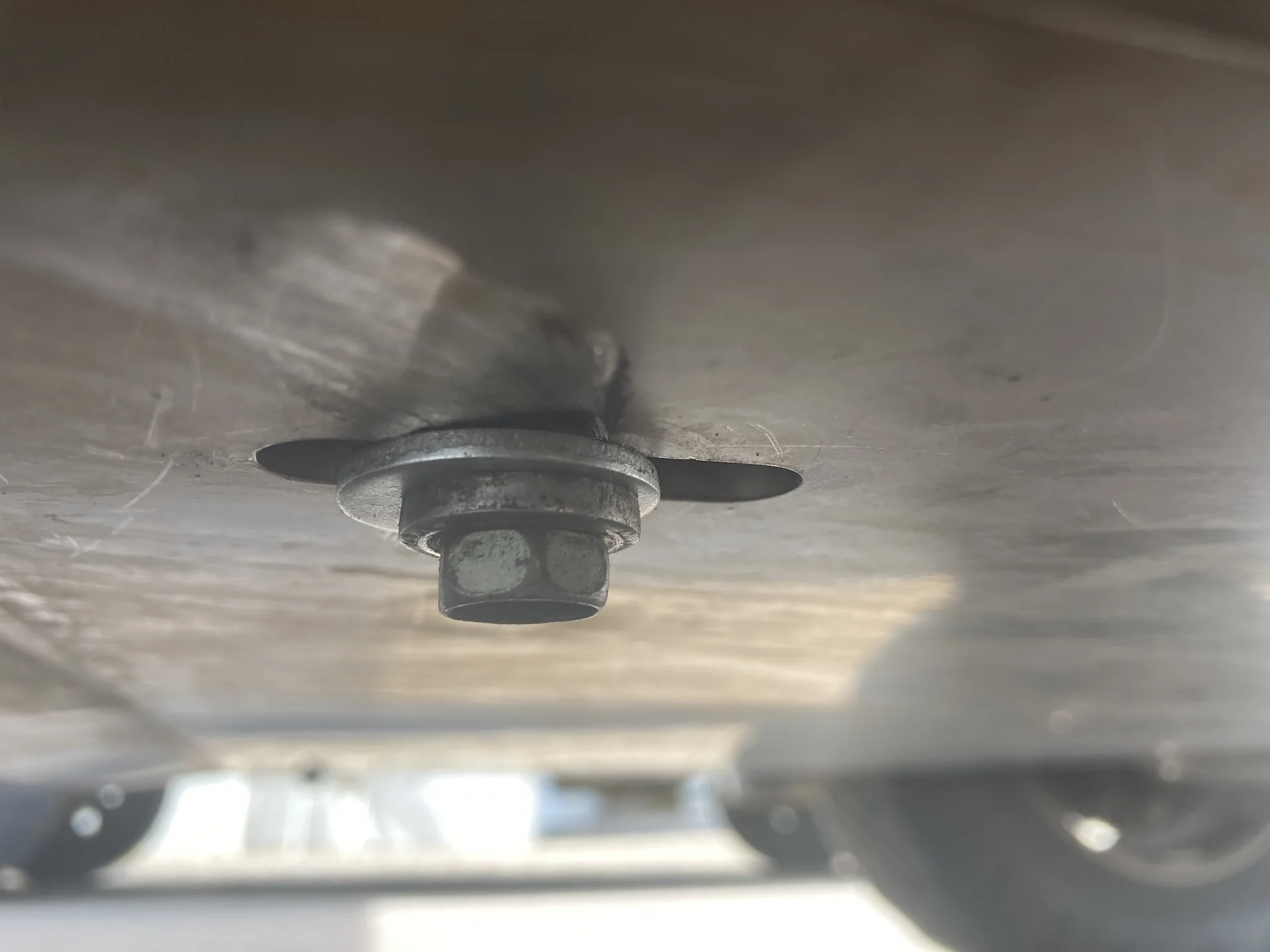

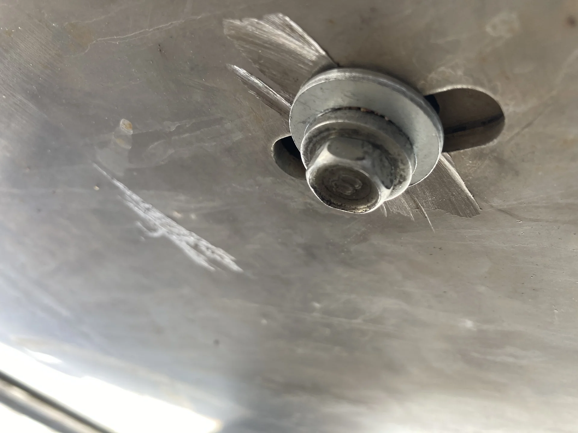

My LC200 has Budbuilt skids/sliders, which were installed by a shop that focuses on Cruisers. Enough said.
I recently took my LC200 in for service, and the dealer notified me that the skid plates (Bud Built) would need to be removed. They've removed them before on another vehicle, so I didn't think it would be an issue. The dealer tech, however, took a grinding wheel to two of the bolts to remove them, and damaged the skid plate. The bolts in question had round heads, and go up into the vehicle where a nut is attached & tightened. The dealership claims the bolts were cross threaded and installed incorrectly. The catch is, given who installed the plates, I simply can't believe that they would cross thread the bolts. As far as I know, this is the first time the plates have been off since installation. Should have removed them myself, but oh well.
I've asked that the dealer replace the plate, which they have denied so far. Is this an unreasonable request? My opinion is that in no scenario were the bolts cross threaded, and this is sloppy work. They might have been seized up, but I would have expected penetrating oil or something else tried first.
Ignore the replacement bolts - they were whatever were laying around the dealers maintenance bay. I have replacements on the way already :(

I could care less about the appearance - the grinding marks are at least a mm on the driver side and more on the passenger side. I haven’t removed the bolts to see how deep the grinding went. The washer is only touching on a few points due to missing material
so did they chase the threads out? or did the guy just cross thread the replacement back in?
Grinding or cutoff wheel on the round bolt head until they could push the bolt out. I don’t think the frame is threaded where these bolts go in.

You are correct on the what bolts should be in there and how they install.
Bents, dents, dings and wear on the plate would normally be in other areas, and not at the bolt holes. It can be tough in the pics to see, but it's deeper than just cosmetic. Is it deep enough to matter? Maybe, maybe not.
The shoulder of the replacement bolts, when they arrive, will not have full contact with the plate. I removed one of the bolts and best guess is that the washer on there now only has contact with maybe a 3rd of the surface area it would normally have. What will the shoulder of the carriage bolts do with reduced surface area? No idea, I'm not a mechanical engineer - that's why I bought these ;) and didn't make them myself.
