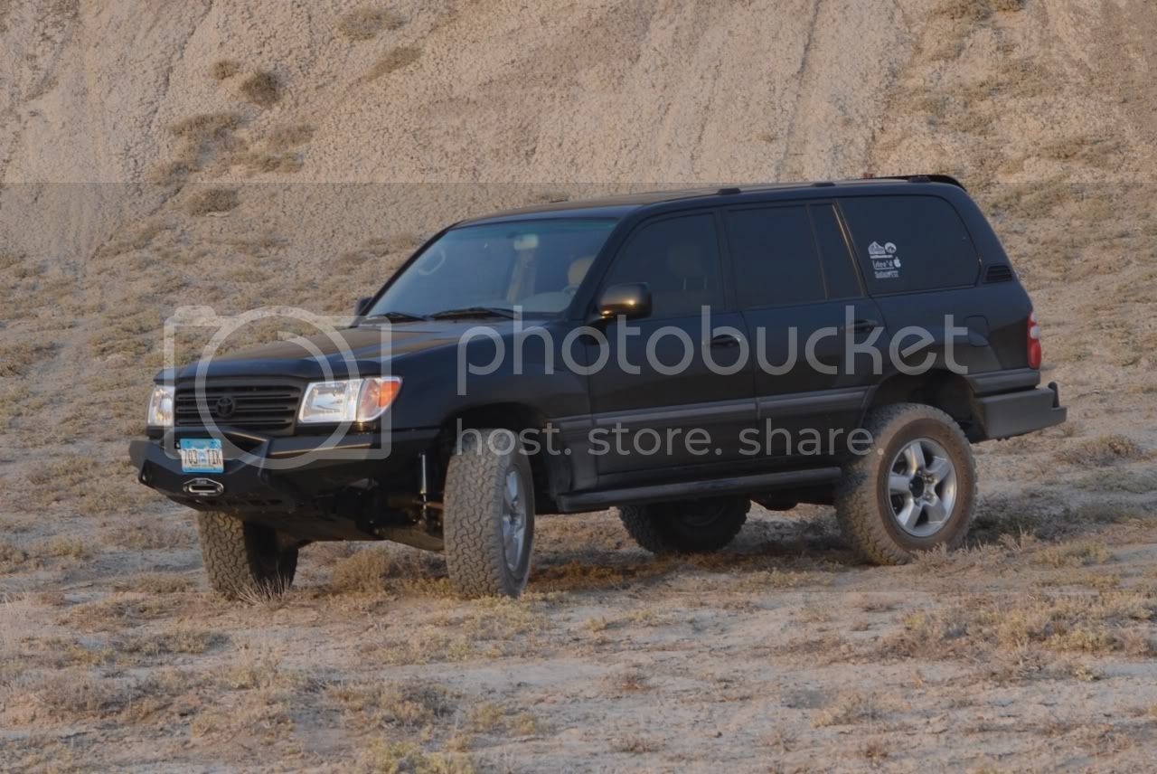

Dont know if you can see mine in this pic but here it is. I can take a better one tomorrow if anybodys interested.
I've had mine on for ~7 months now. Looks new. Note my truck is parked in a garage both at work and home.
pics are a few months old.
