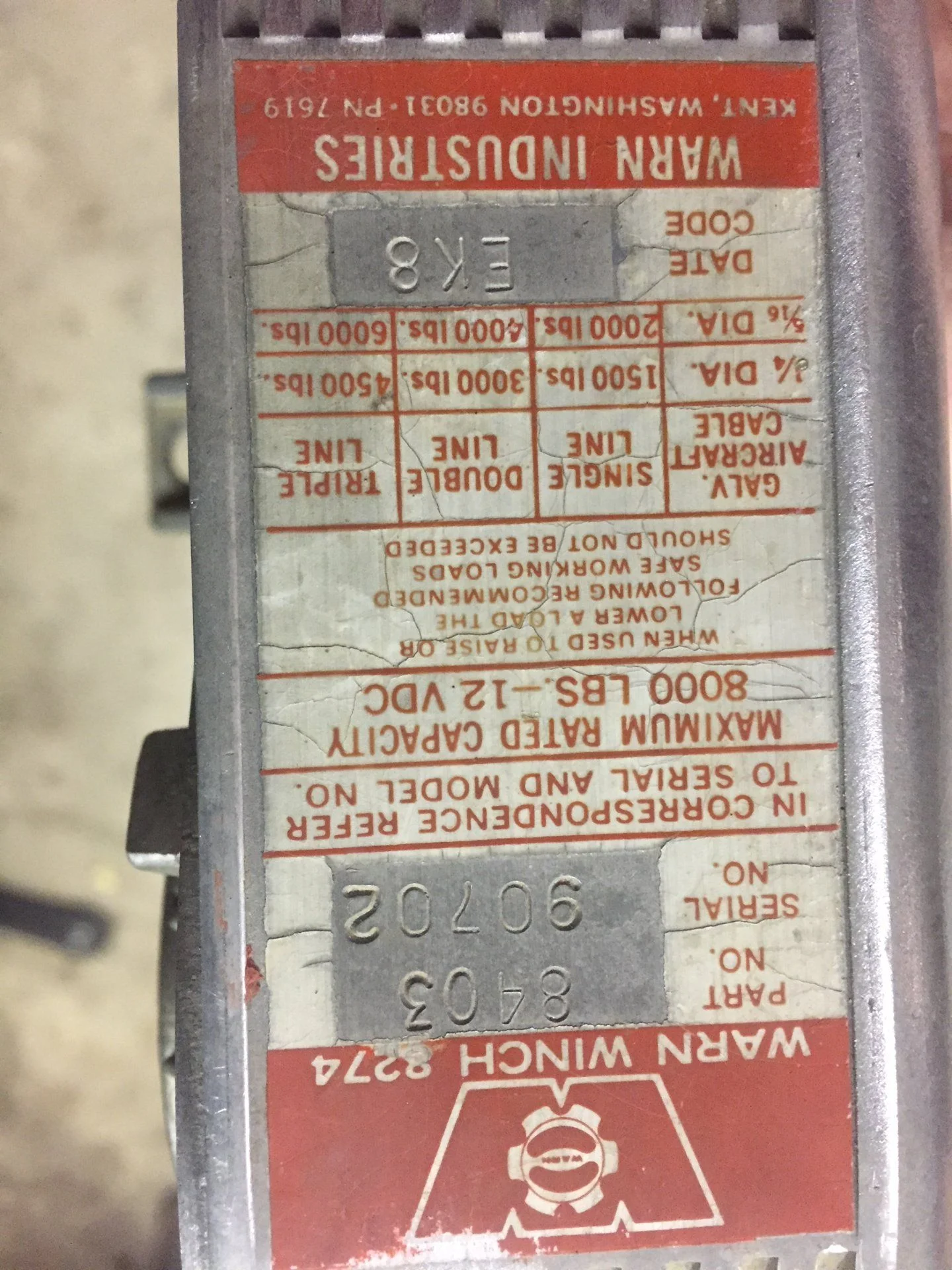

I have a Warn 8274 with the following data plat info and wondering how to date it.
SNL 90702
EK8
E = May
K = 11th working day of the month (i.e., not including weekends or holidays)
8 = the year; in your case almost certainly 1978 (but it could be 1988?).
So, May 15, 1978.
Warn Date Codes on 8074 or 8274 winches
I wonder why it has such a low serial number.
90270 is low?
May 1978 is the earliest it could possibly be; the first year for the 8274 was 1974 (hence the "74" in the model number).
1978 would be my guess also, I have a Dec 1977 8274 date code LA7 ser # 72755 with metal controller plug socket..(they switched to plastic in 1980ish)...I assume yours has the metal socket? Would be nice if someone set up a database for these to track ser# , date codes, small changes with photos we could upload
