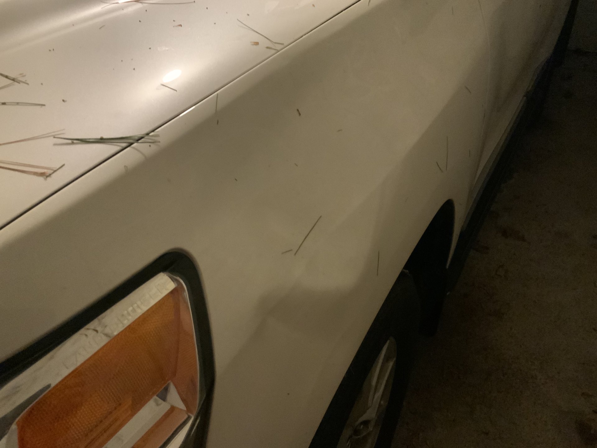

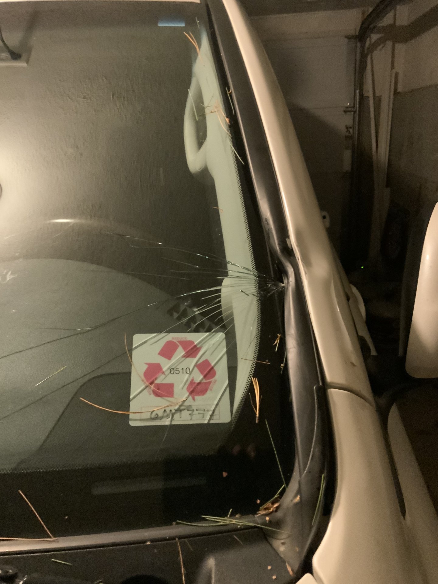

Hi all,
I just had a tree branch fall on my wind shield damaging the A pillar and left front quarter panel as I was driving. It sounds worse than it looks but I’m wondering how that repair takes place. Is the damaged A pillar cut out and a new pillar welded in place? It looks like the fiberglass covering the pillar is an extension of the rear quarter panel. Does that need to be replaced? Any info appreciated.

I’m ignorant about the body work, but keep in mind 1) there are airbags up there that you do not want to go off while you‘re checking it out and 2) water leaks in the A pillar area and windshield seal can be really bad news. Whoever fixes it needs to do good work and not just use silly putty.

That black trim pops right off, it is only held by plastic clips along the side and a metal clip at the top. They should be able to repair that easily. My guess is they'll probably pull it out, recountour with filler, prime, paint, and bob's your uncle.

A filler/bondo glob to fill that will likely sink and crack over time. This has happened to me from the previous owner of my 62. The last 62 I looked at I went over with a magnet looking for filler. And guess what I found :( Looked great but in a few years I would have been replacing panels correctly.
An old school shop that still does repairs instead of just doing high volume slap in new pannels type work could pull that without replacing (like this: Stud Welder Dent Pulling System - https://www.eastwood.com/stud-welder-dent-pulling-system.html). Not likely paintless but disassemble the interior, pull the dent, some hammering, final light bondo that is sanded to just a skim layer and paint.

You can get a new front fender from a dealer and have it painted but a good body man can fix all that and blend the paint and it will be good. New fender maybe easier and better and may or may not be cost effective.

Take a closer look. The A pillar is part of the entire side panel of the vehicle - yes, all the way back to the trunk and all door reliefs is one piece.
The 100 and 200 have some of the largest single piece stamped body panels of any vehicle sold.

Toyota makes a number of partial panels for weld in repair.

Both those dents are easy to fix (that does not mean cheap). They can be pulled/pushed out easy by most body shops without using excessive filler. Some filler will always be used to get that perfect surface. What you do not want is filling instead of pulling.
The harder part is the paint job. How to blend it so you can't see it. That's were the boys are getting separated from the men.

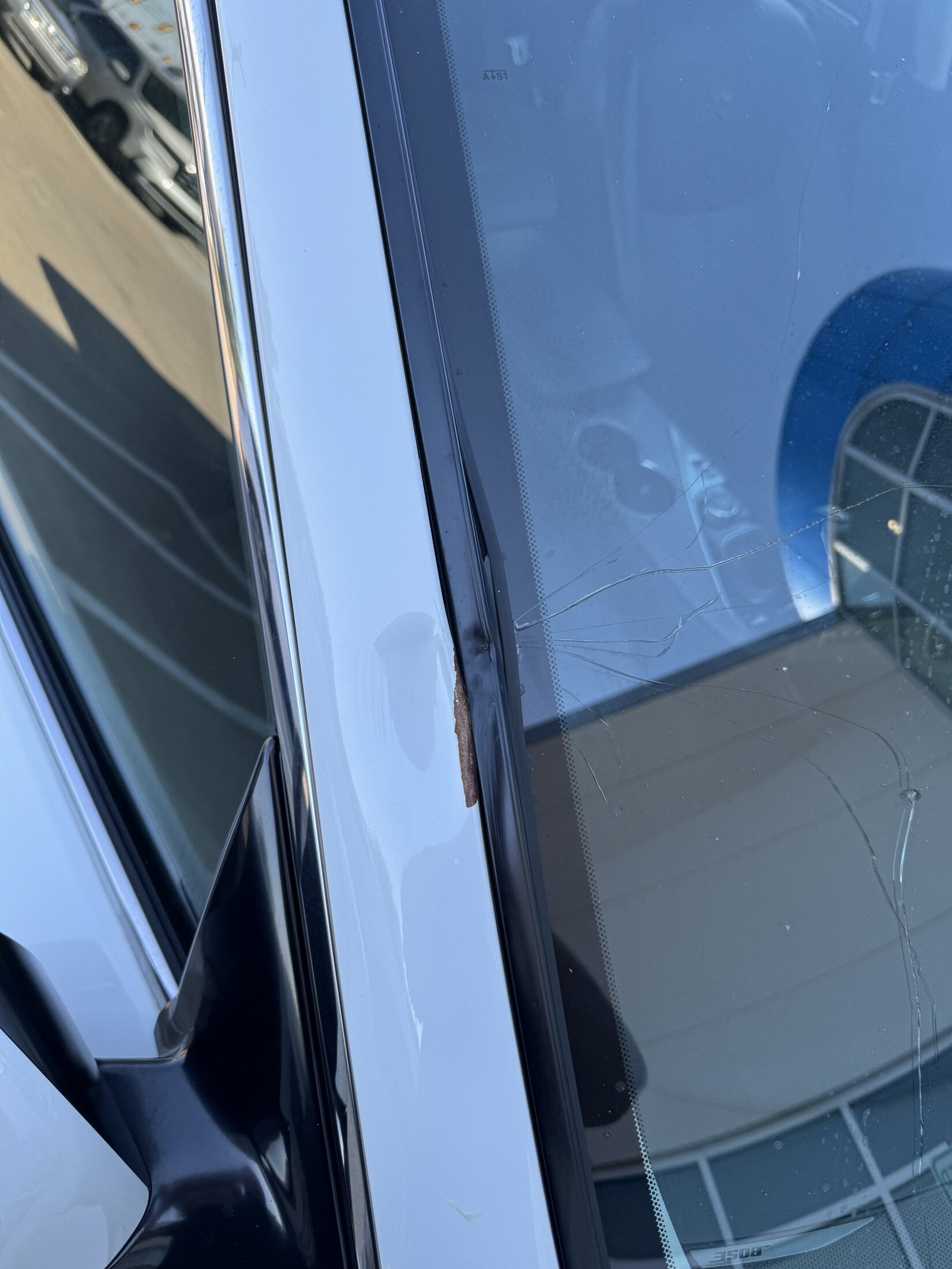

Hello I have a similar question about my car. My A pillar was damaged due to a baseball hitting it causing it to leave a dent and crack my windshield I would like to know if the windshield would be able to be replaced
