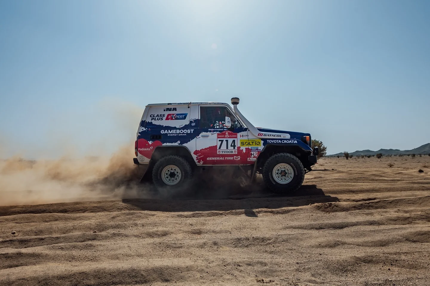

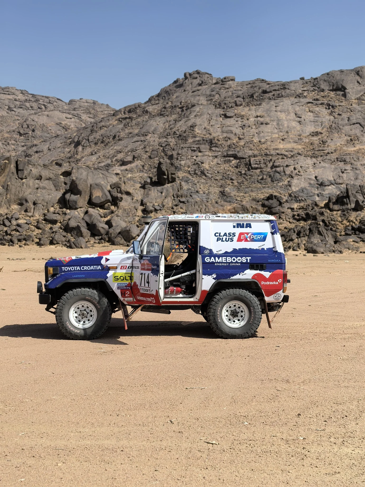

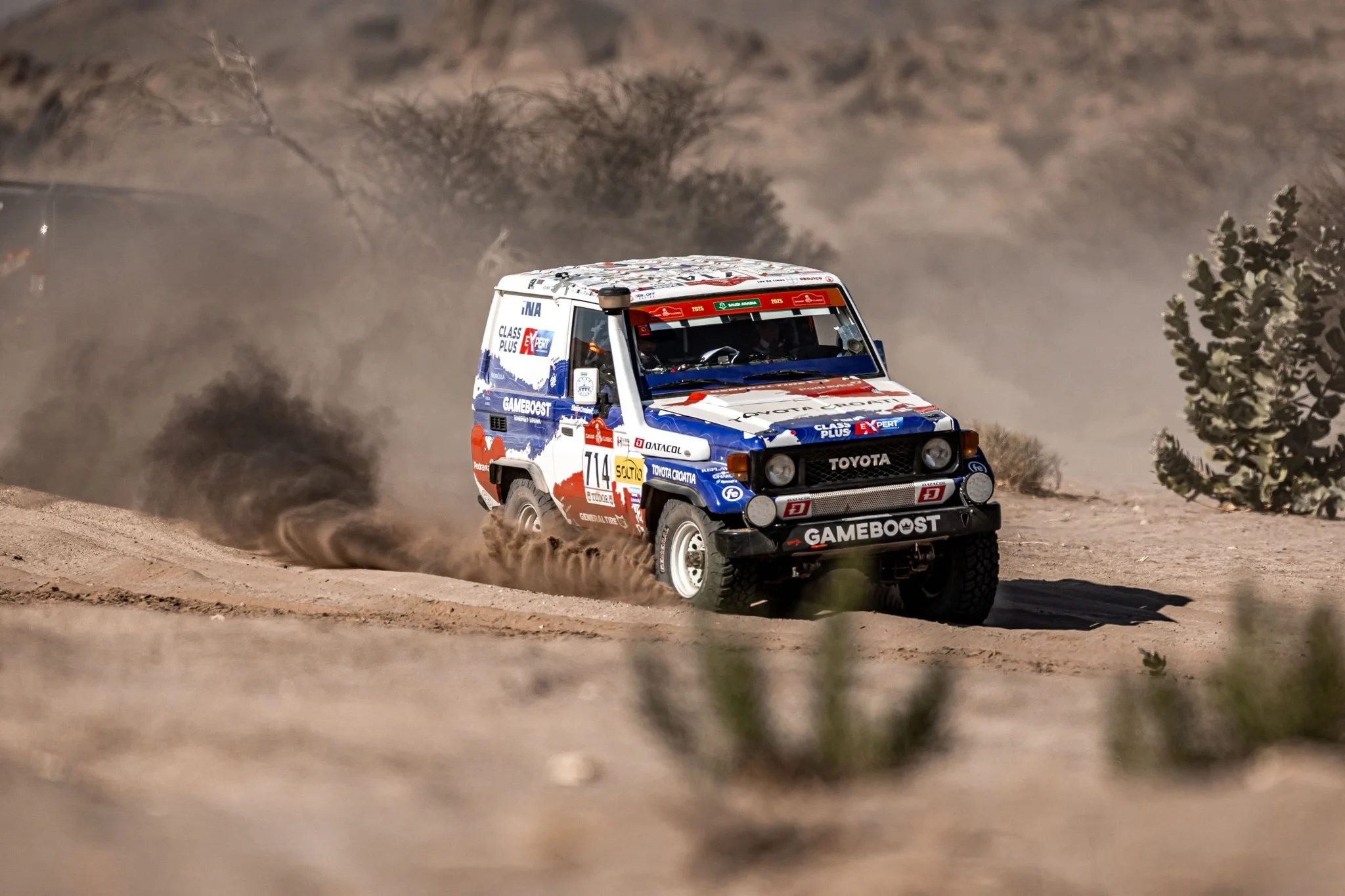

So here is my new to me 1988 BJ71 13BT Dakar classic rally car in the 2025 race. 3rd twice, almost third in 2025, I am upgrading and modding it to be safer, hopefully, more reliable and supportable for the future to compete in many more Rally raids.
We are doing Dakar Classic 2026 starting 3rd Jan.

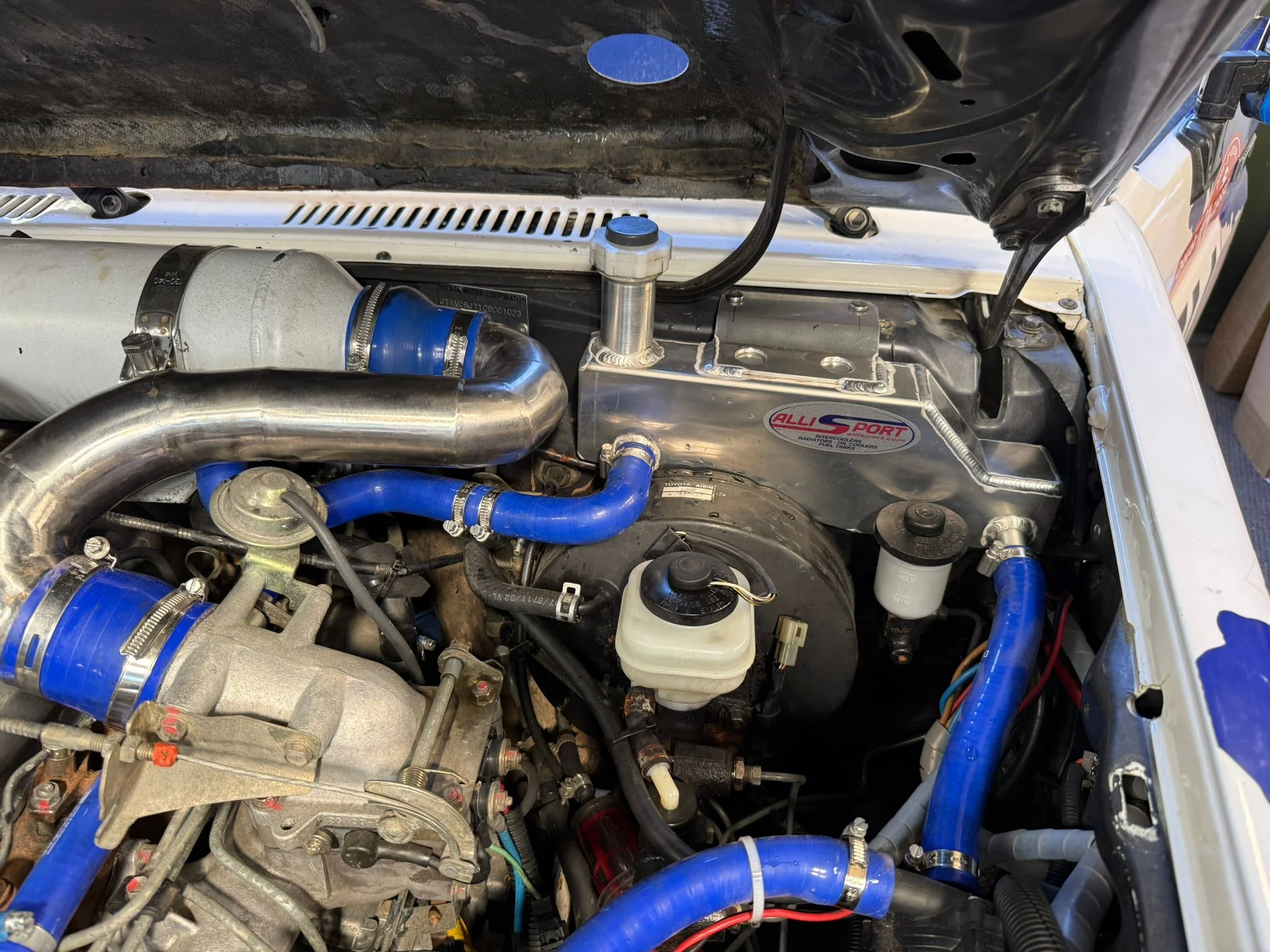

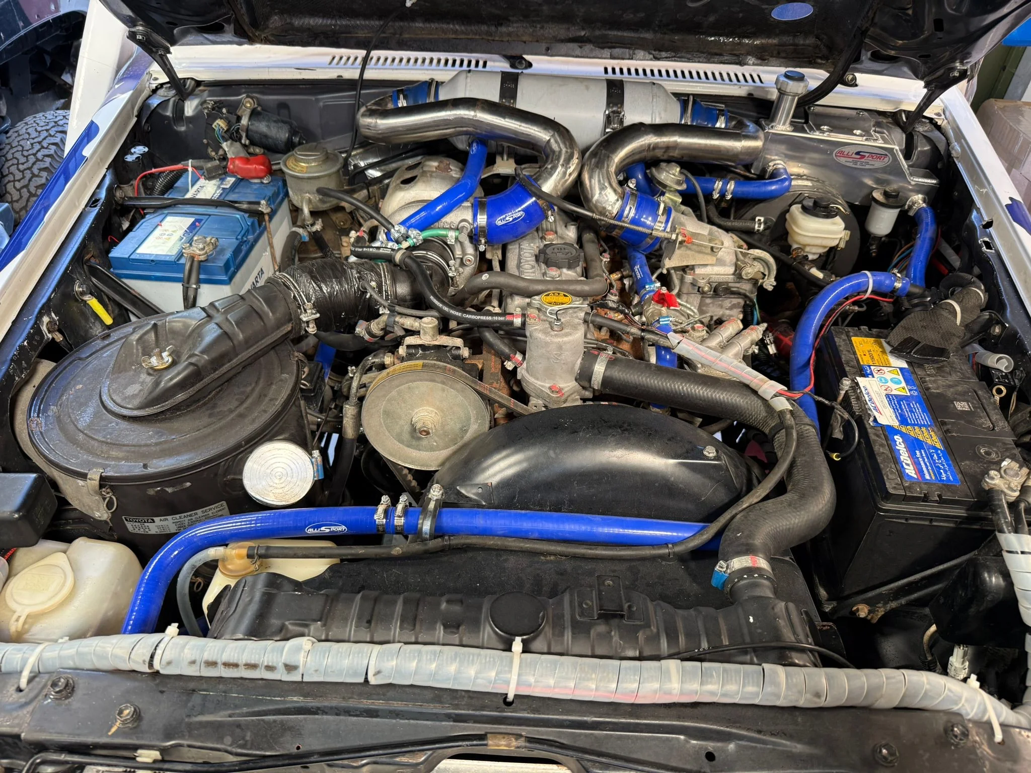

It has an upgraded hybrid turbo and an intercooler fitted, new remote reservoir Oram racing dampers, modded leafs, upgraded and strengthened axles, casings, CV’s and 30 spline shafts.
Awaiting Braid wheels and a clutch booster.
Hoping to swop out the current OEM brake booster for 80 series dual diaphragm and also to upgrade the steering box and to add an OEM clutch booster.
