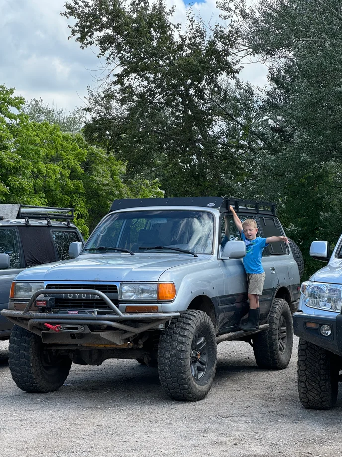

My son (5 at the time) was into Star Wars at the time, and renamed it the Millennium Falcon (AKA: The fastest hunk of junk in the galaxy) due to it's worn silver exterior and monster engine.

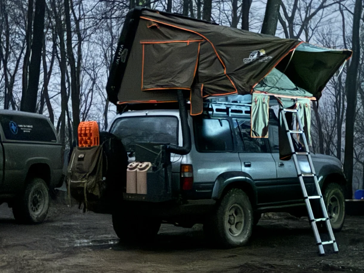

Once I got it running right, we took the Falcon on a bunch of adventures!
Friends-giving 2023, out first outing! Rushed to get a hitch setup to haul my teardrop, and basically ran it as-is. Camped the weekend on the Manistee River, down some forest roads.
Hocking Hills State Park, New Years 2024. Weekend camping with friends, shaking down the power system and cold weather setup.

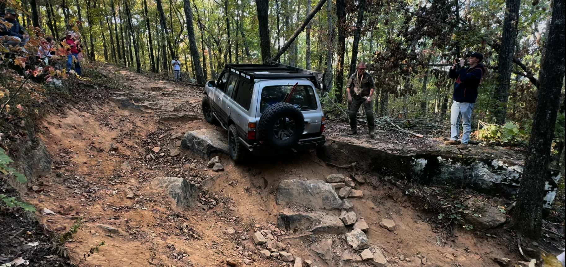

We went on to tackle some pretty good wheeling in the backwoods of AK.

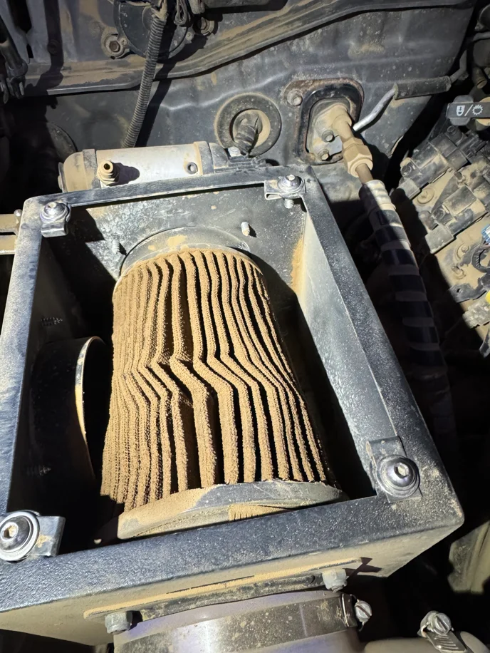

After wheeling for a couple days, the truck started to throw some airflow related DTC's. The Ozark dust had completely clogged the air filter.

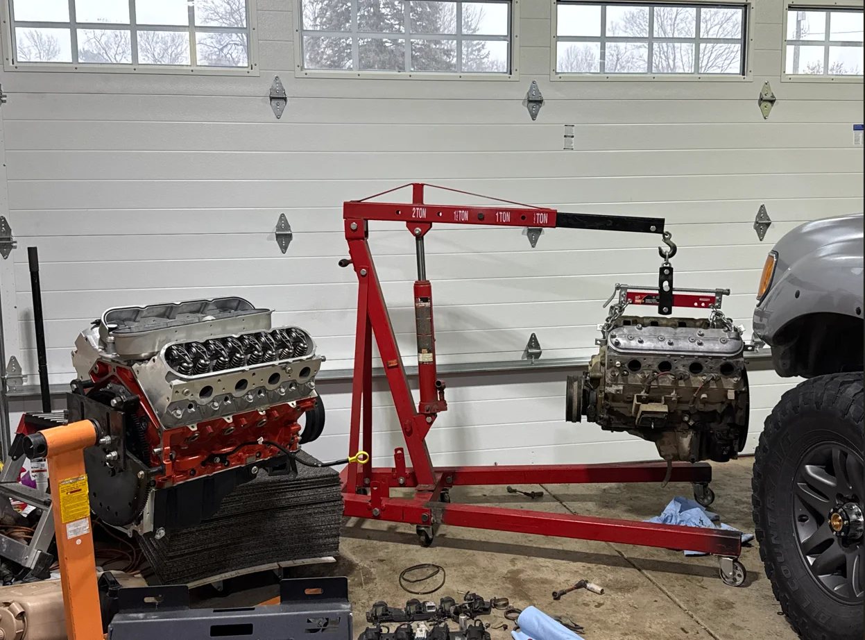

Obviously that was WAY too much work to accomplish, so why not toss a NEW ENGINE at it too.

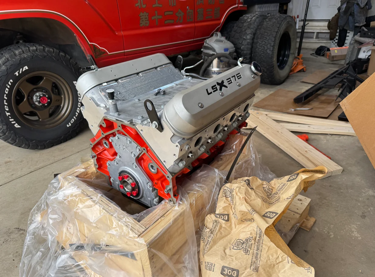

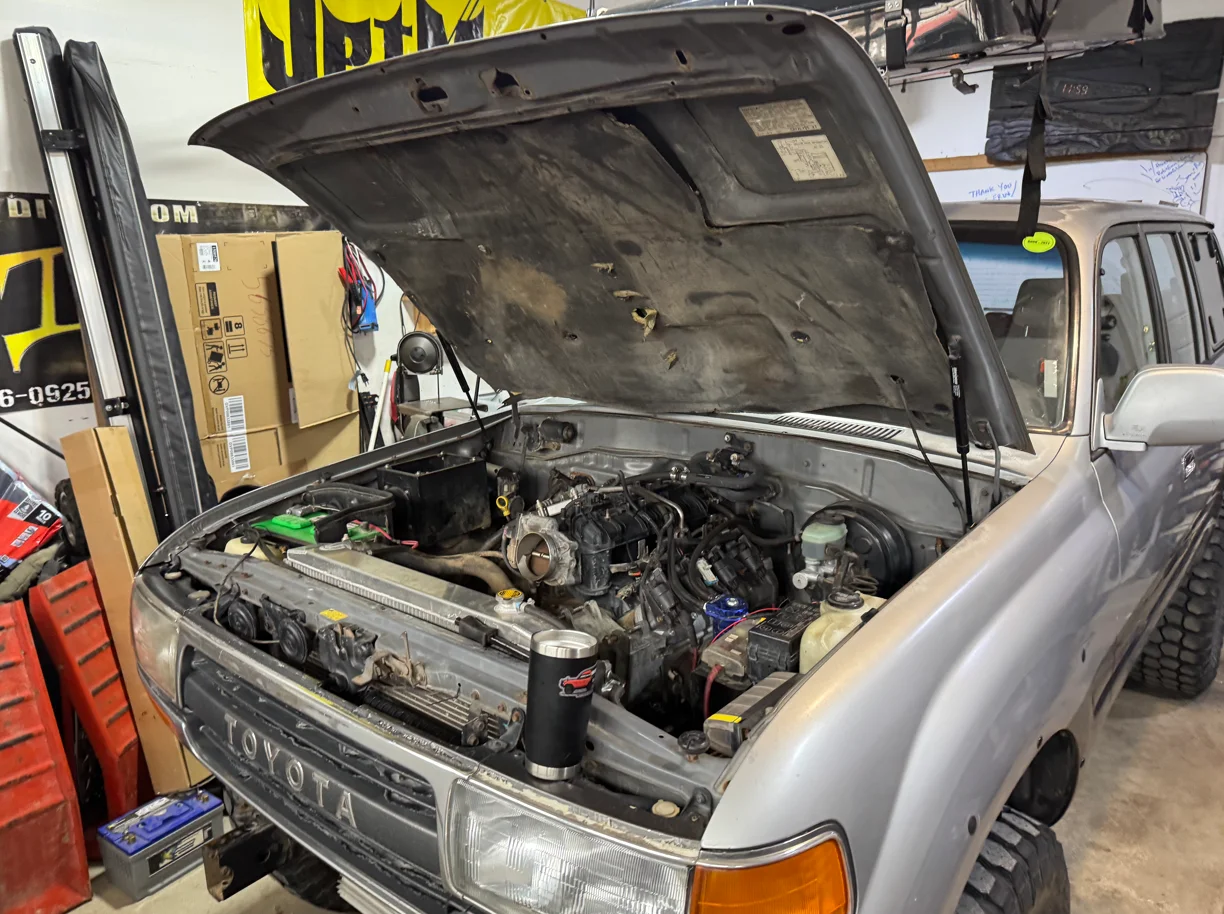

The 6.2L L92 that was in the truck had around 220k miles on it. It was tired, it leaked, it ticked, it burnt through a quart of oil in 500 miles. With Newfoundland on the horizon, I wanted to freshen it up. I originally planned to rebuild the current engine. I wanted to delete the VVT system with an LS3 cam, and refresh the engine. I decided that because the engine was 10.5:1 compression and only ran properly on Premium fuel, I wanted to swap to some dished pistons and build it to run on 87 at ~9.5:1 compression. Premium fuel is less available on the island (and other places I plan to travel to, Baja, etc...) so I wanted to avoid having to run it.
With that build in mind, I started collecting quotes, picked a machine shop, and joined the waiting list. It was going to be really tight to get the engine done, and in the truck before spring.
A couple weeks later I ran across an ad for an LSX376-B8 for sale. This variant of the LSX has the "Bowtie" block (Reinforced, revised oiling pathways, longer sleeves, improved in all the best areas) and is 6.2L, non-VVT LS3 cammed, forged piston, and 9.0:1 compression from the factory. They're primarily build for boosted applications, and are warrantied from GM to 8lbs of boost. All of my L92 accessories, intake and exhaust would bolt on, and the tune should be pretty close, since the heads and displacement are the same.
The total cost for the LSX was going to be about the same as my engine build, and this is a fully GM built long block, with a warranty, nearly exactly what I wanted to build. I jumped on it and had an engine dropped off in the garage the next day.
The only real downside I see to the LSX based engine is weight. The long block weighs about 40lbs more than the iron block LS, and 120lbs more than the aluminum block I was running. In both cases, I think the total weight is less than a 1FZ, so I figured it would be ok.

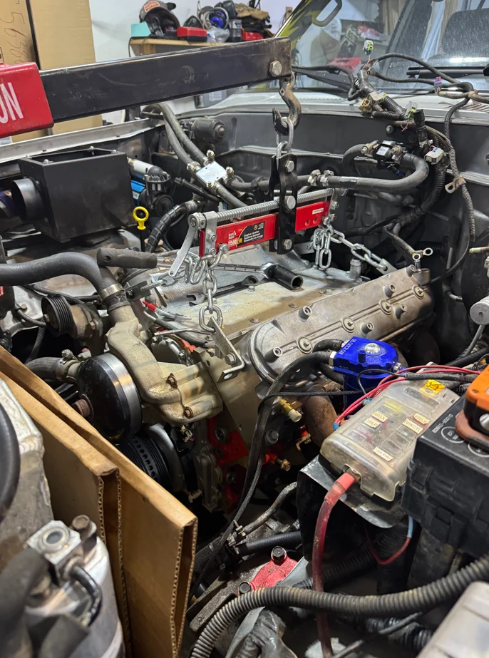

  • Swap the engine
  • Shake down the engine
  • Start prepping for the paint work
There were really no surprises, and the engine dropped in after a few nights of wrenching after work!
The tune was actually a lot closer than I expected it to be, and I started driving it to work for a few days to put the 50 / 500 break in miles GM calls for. The first two oil changes were perfect, with nothing unexpected.
The new engine felt GREAT. It had more power everywhere than the tired L92. Fuel economy seems unchanged so far (I'm currently 4k miles in). It runs on 87 octane, towing my teardrop, with ZERO KR, even lugging up a hill in 6th.

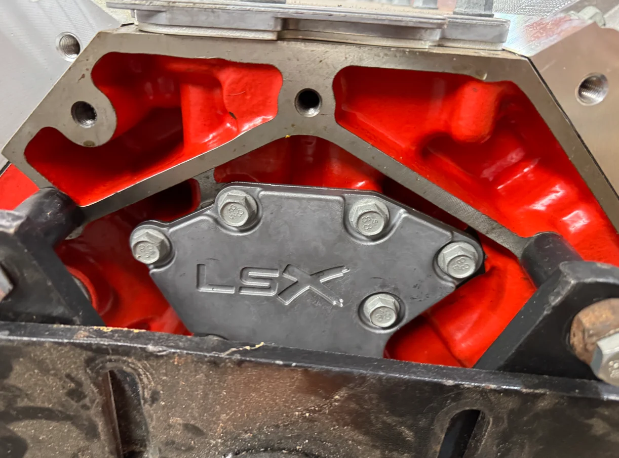

The LSX376-B8 looks like a big upgrade over your old motor.
The LSX376-B8 comes with a 6 bolt block but not 6 bolt heads?
I wouldn't say it's a huge upgrade over a good running L92, but mine was very tired.
Yeah, the block is setup for 6-bolt heads, but comes with 4-bolt in this configuration. They also make an LSX376-B15, designed for 15lbs of boost, that comes with the LSX 6-bolt heads.

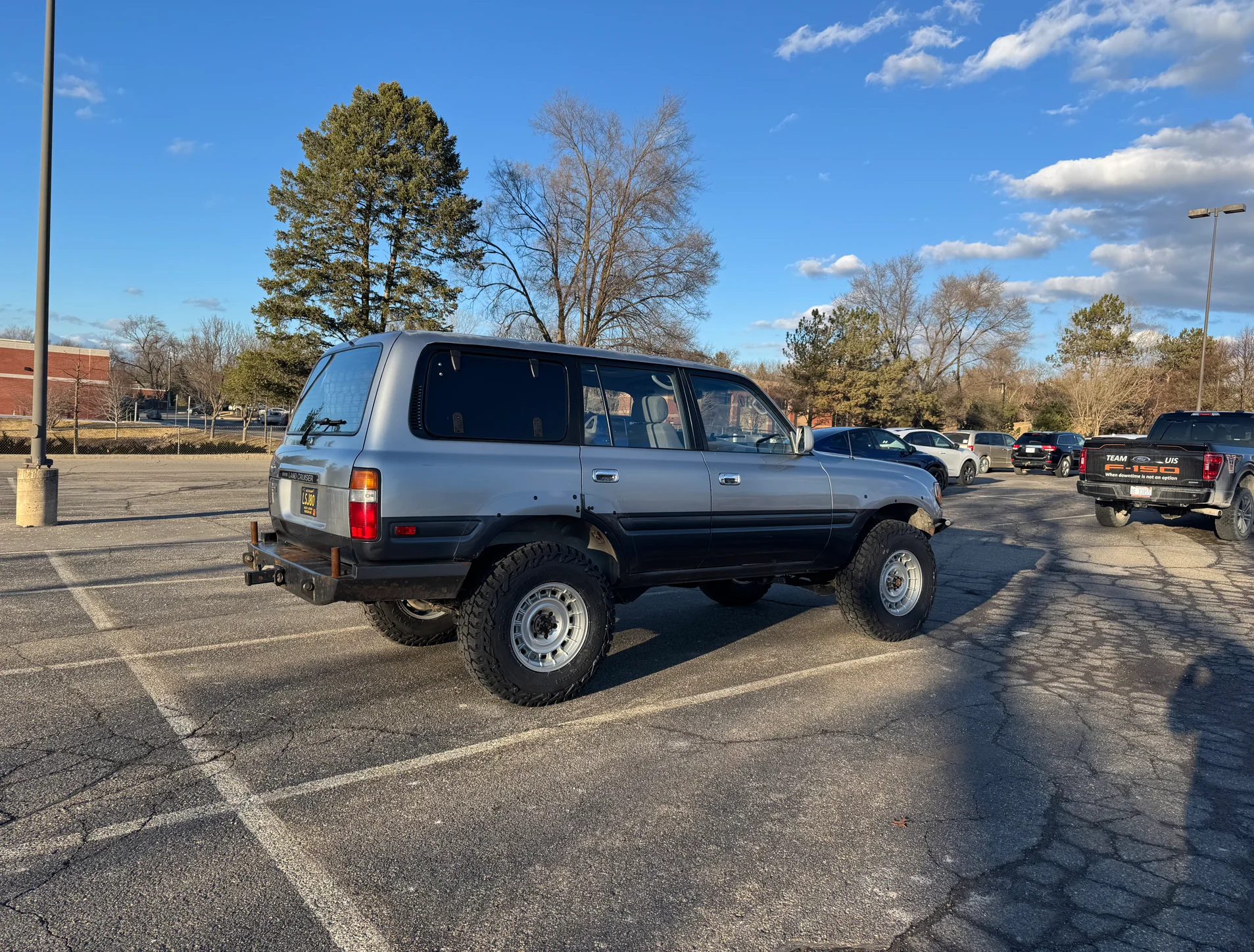

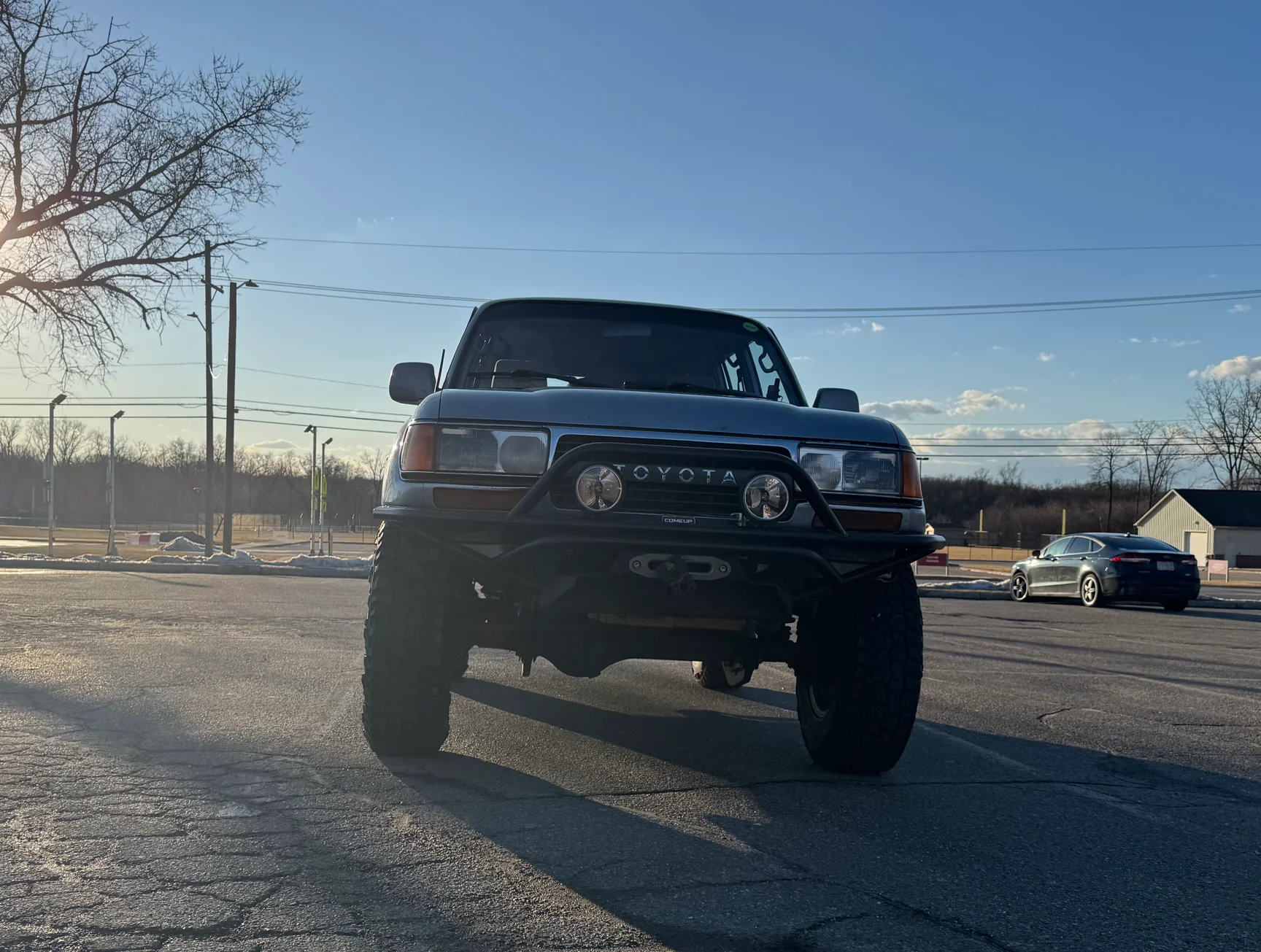

With the new engine running great, I wanted to switch up the tire setup as well. I loved the stance on the 17x7.5 ET15 Tundra wheels with 35-12.5-17's. I found that a set of 17x8.5's ET0 with 255-85-17 would put the outside of the tire exactly where the current setup was, but give me a nice tall / skinny tire look.
I picked up these Nomad Avro's from MUD, and went with the Baja Boss 255-85-17. The math worked out perfectly and the stance is exactly what I was looking for!

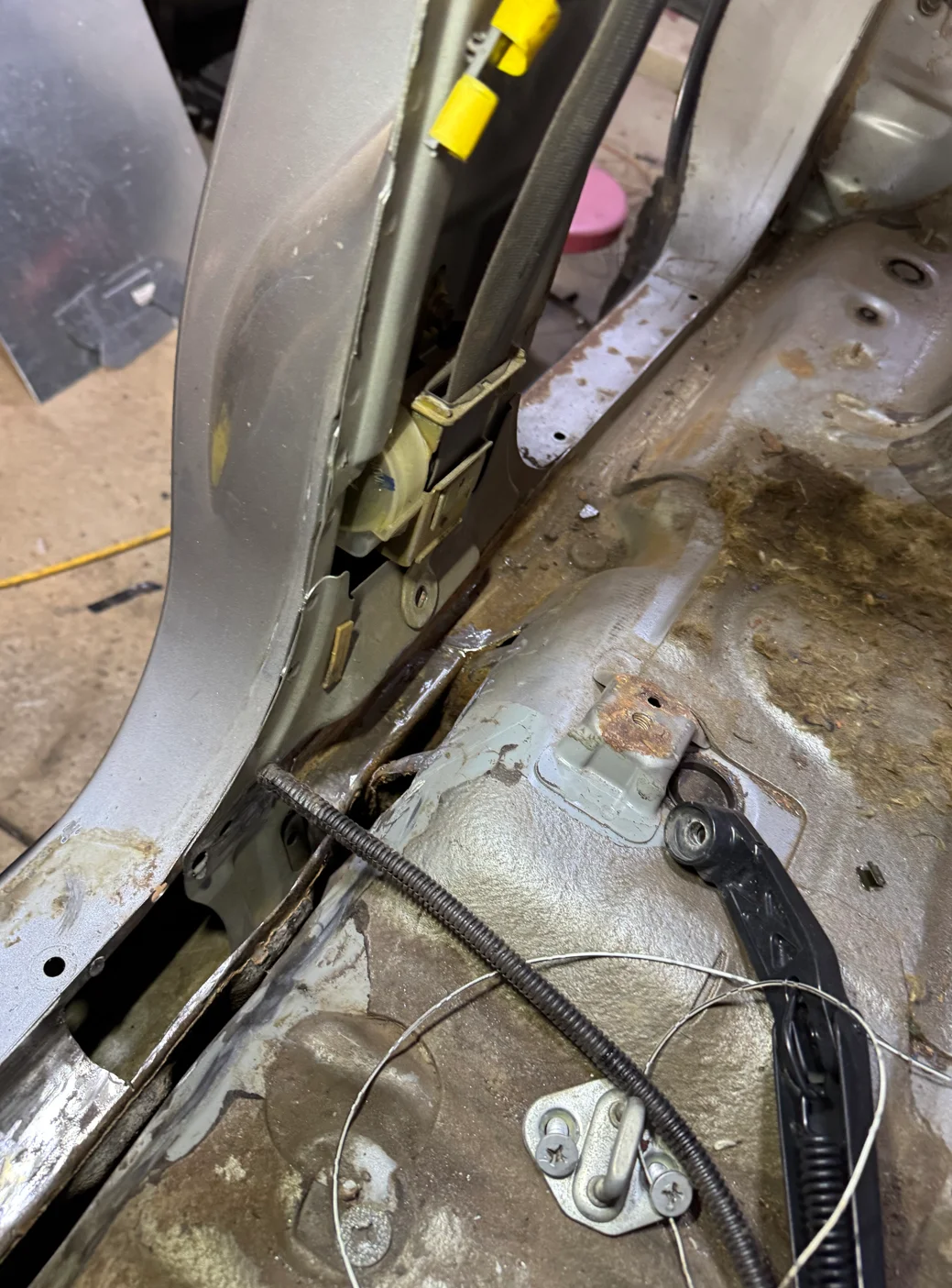

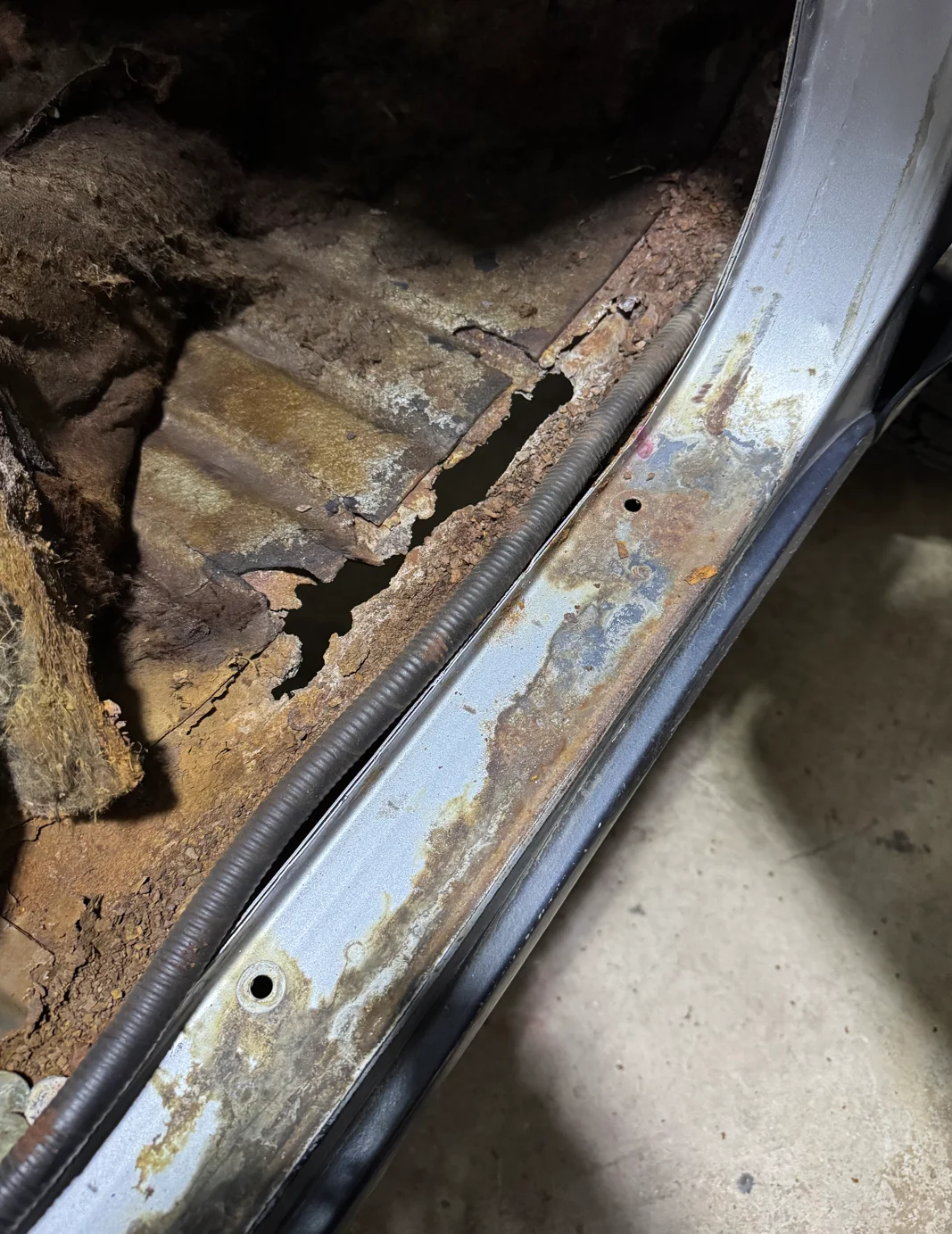

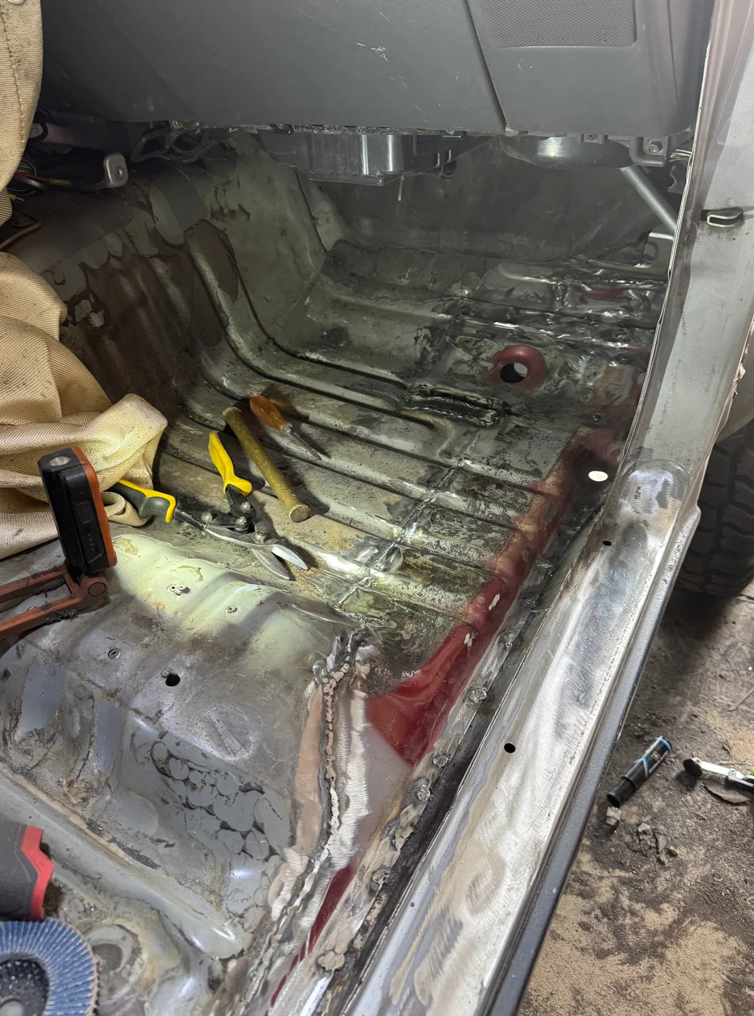

First step was to evaluate the issue in the passenger floorboard area. The heater core has been leaking for a while, leaving a lot of moisture under the carpet. I knew there was a soft spot, but I needed to see how bad it was.
Ok, a little worse than I thought, but not bad.
Let's keep hammering at it until I find clean metal... Up into the footwell, and back along the rocker... Ok, that's a little worse.
Time to start cutting. All of the rusty metal was cut out, spot welds were cut, and layers were separated. All in, it was a lot worse than I had planned...
At this point I started looking for a floor cut to replace a big section of the floor. I ended up getting a good cut from a MUD member, and patched in all of the bad areas with clean OEM metal.

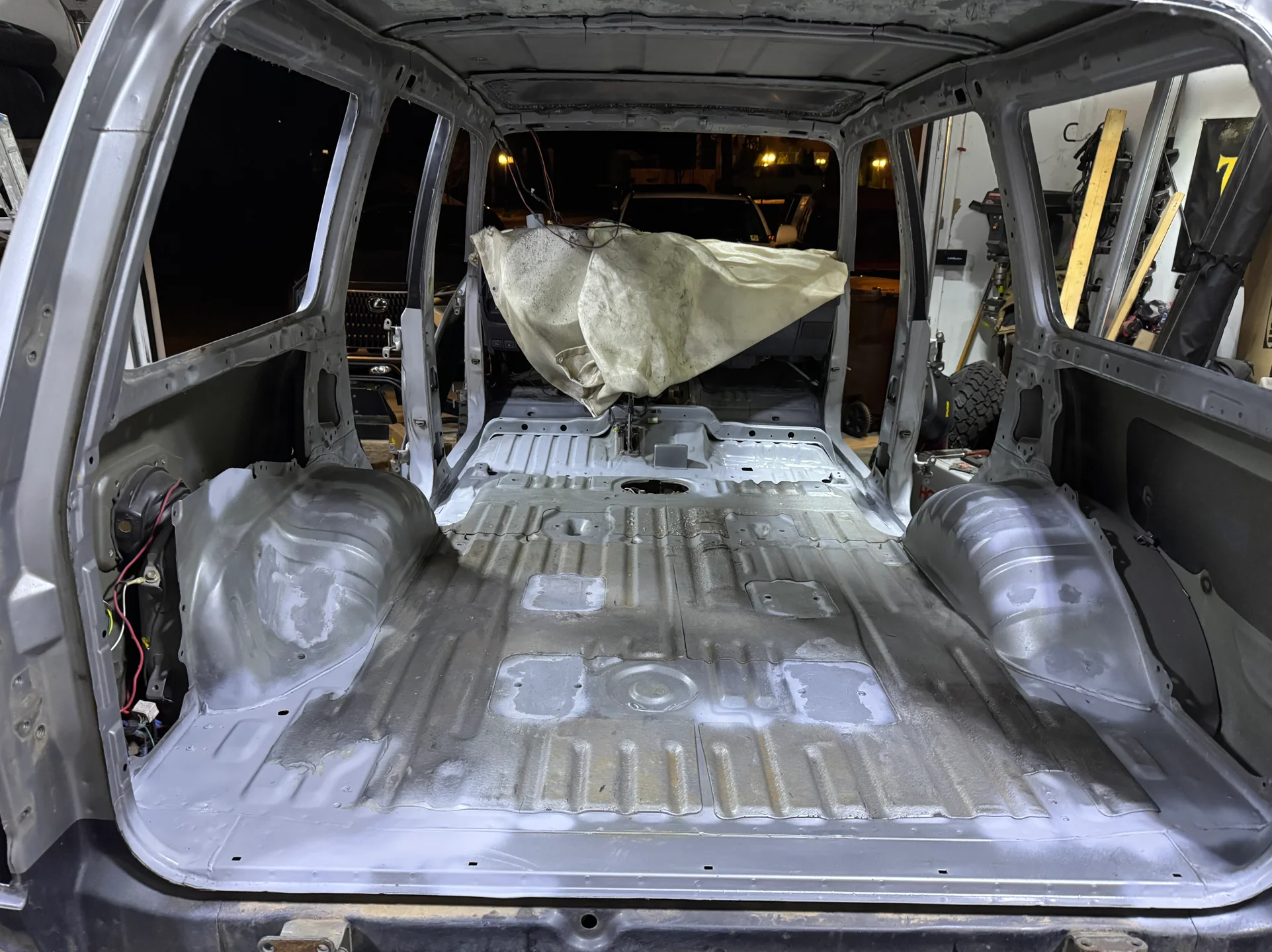

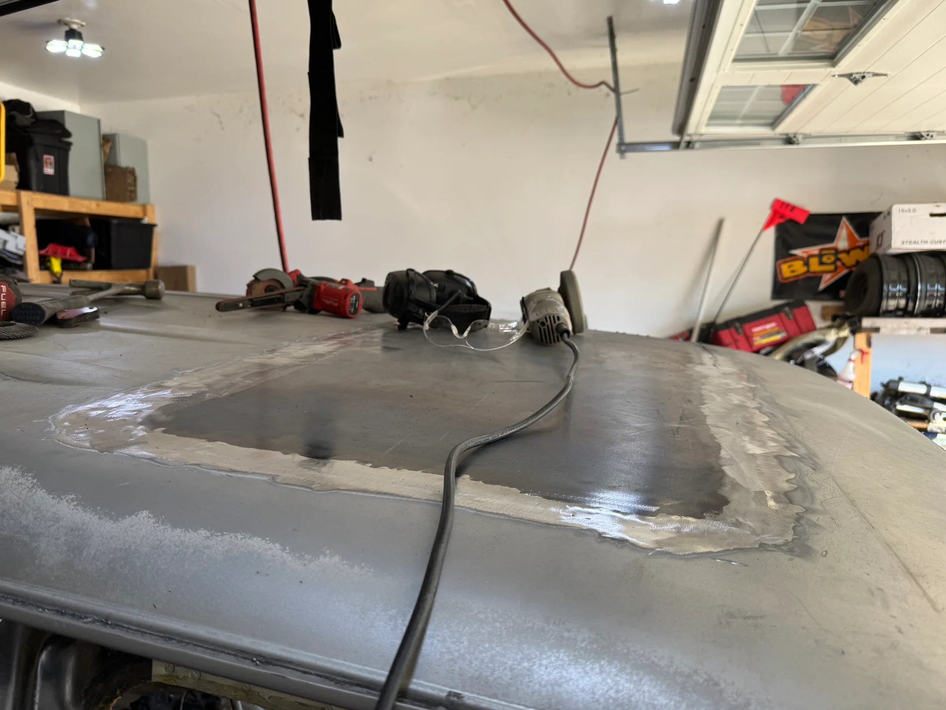

Next up, I committed to deleting the sunroof. Mine had cracked drains, which leaked water into the roof cavity every time it rained. I decided if I was dropping the headliner to fix that, I'd be ripping the whole thing out.
Before I started, I secured a set of non-sunroof headliner bows, as well as ordered the roof bracing that exists on the non-sunroof trucks. See my thread here for more details on that.
The sunroof was removed, and a sheet of 16ga steel was cut to fit the hole perfectly. I slowly welded both the top and bottom seams, trying to keep the panel as cool as possible. Then the internal rim around the sunroof was cut out, and the stock roof bows were installed. Some of this work was done after paint, due to parts availability / timing.

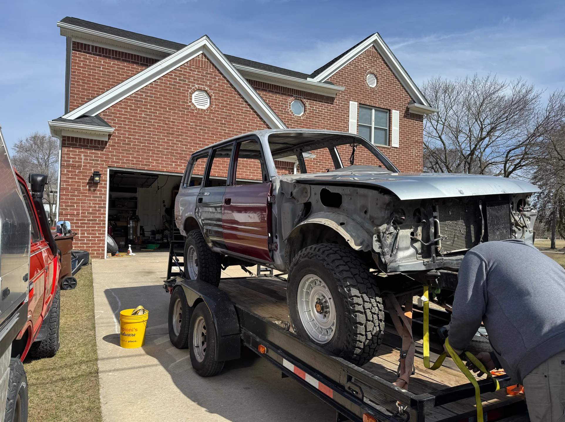

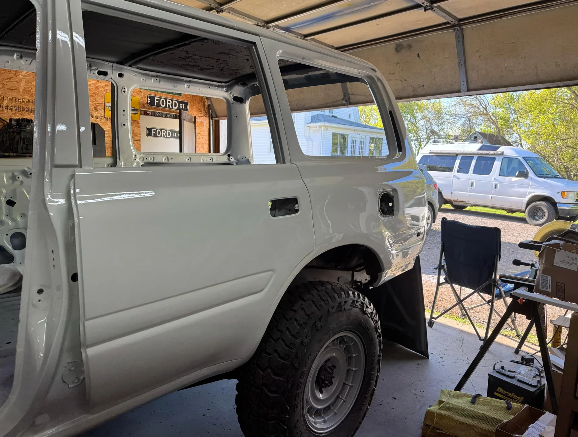

Removed every nut, bolt, clip, trim, etc... that connects to the body.

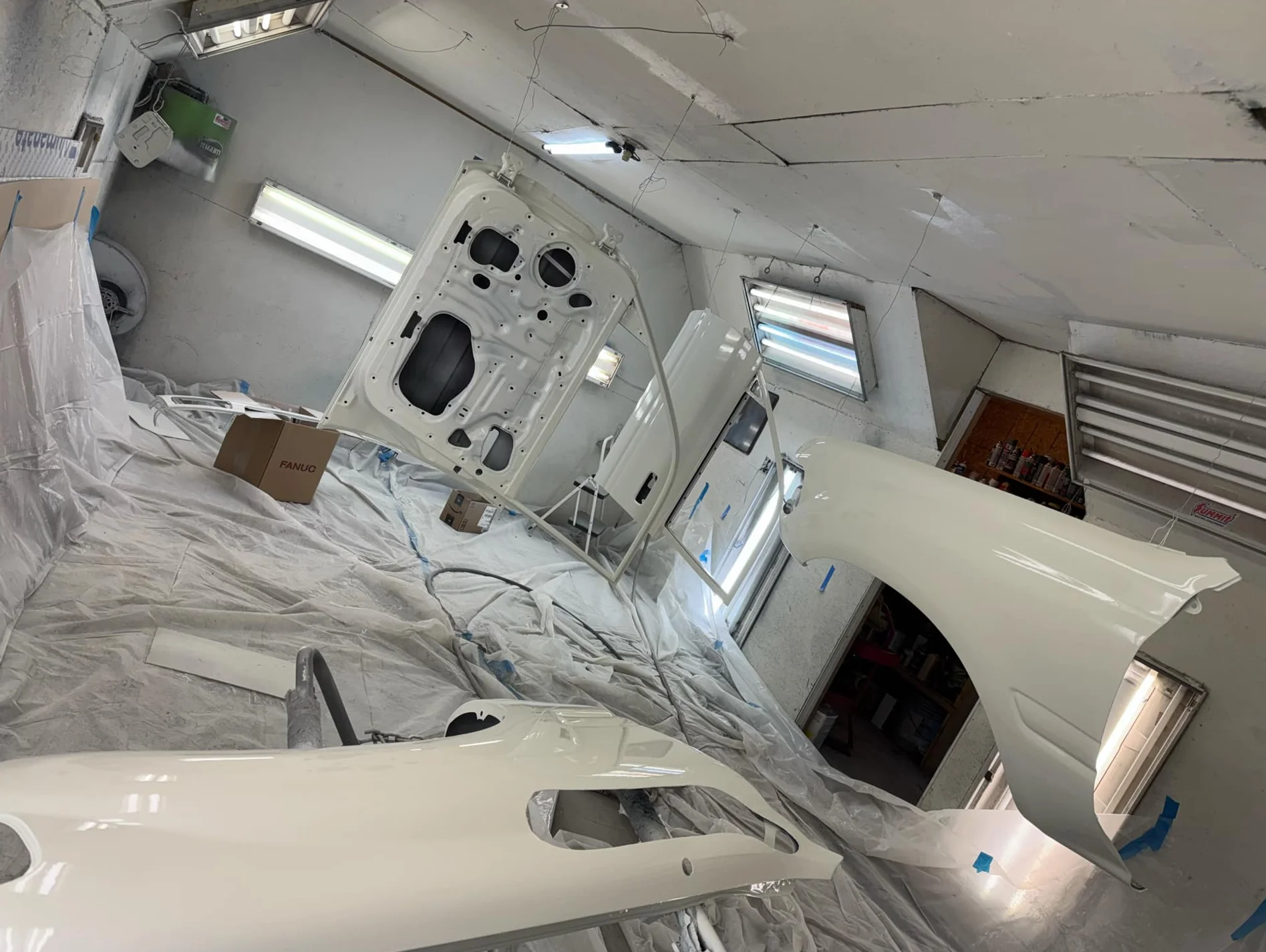

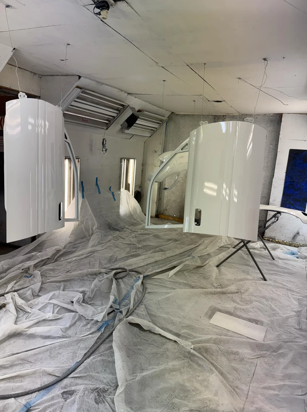

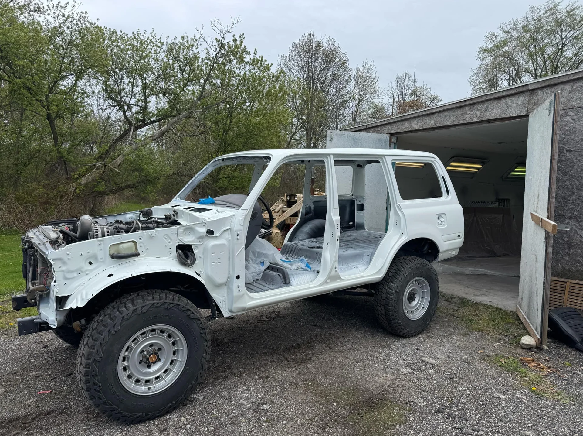

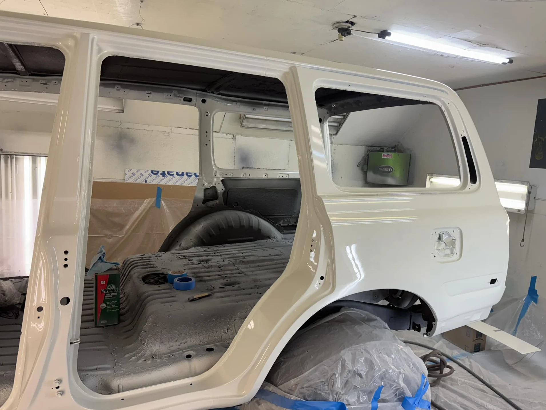

With the body stripped, it was off to paint jail March 21.
The plan for paint was a full color change to 045 White.
Once the truck was out of my hands, I also decided to have the interior sprayed with Second Skin sound dampener, with the hope of cutting the drone down a little without having to quiet down the exhaust note.
I also had finally received the Radius Fab snorkel kit and airbox after a 3 month wait. Those were sent over to the painter to be installed before spraying.

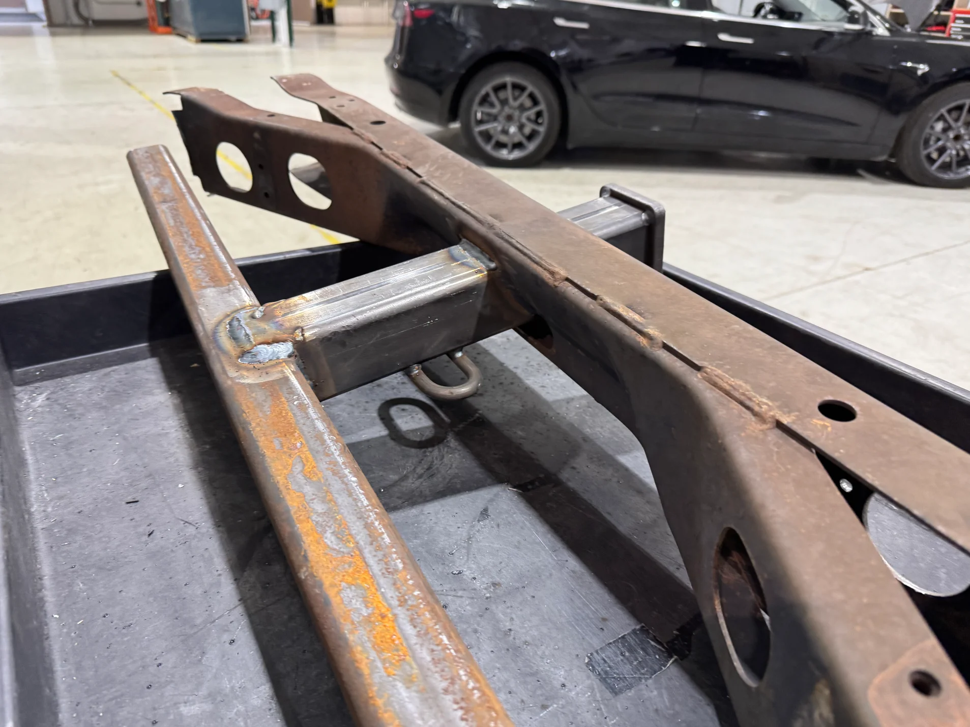

One of the things I noticed on the truck during tear down, was that the rear crossmember (where my hitch bolted) was rotted out. The Trail Tailor bumper covers that spot, and holds most of the load of the trailer, but I decided I wanted to fix it anyways.
I have a spare (RHD) 80 series chassis sitting around for a future project, so after confirming the crossmembers were the same, I started modifying it for an integrated, low profile hitch. My plan was to build the hitch on this chassis, and move it over once the truck was back from paint.

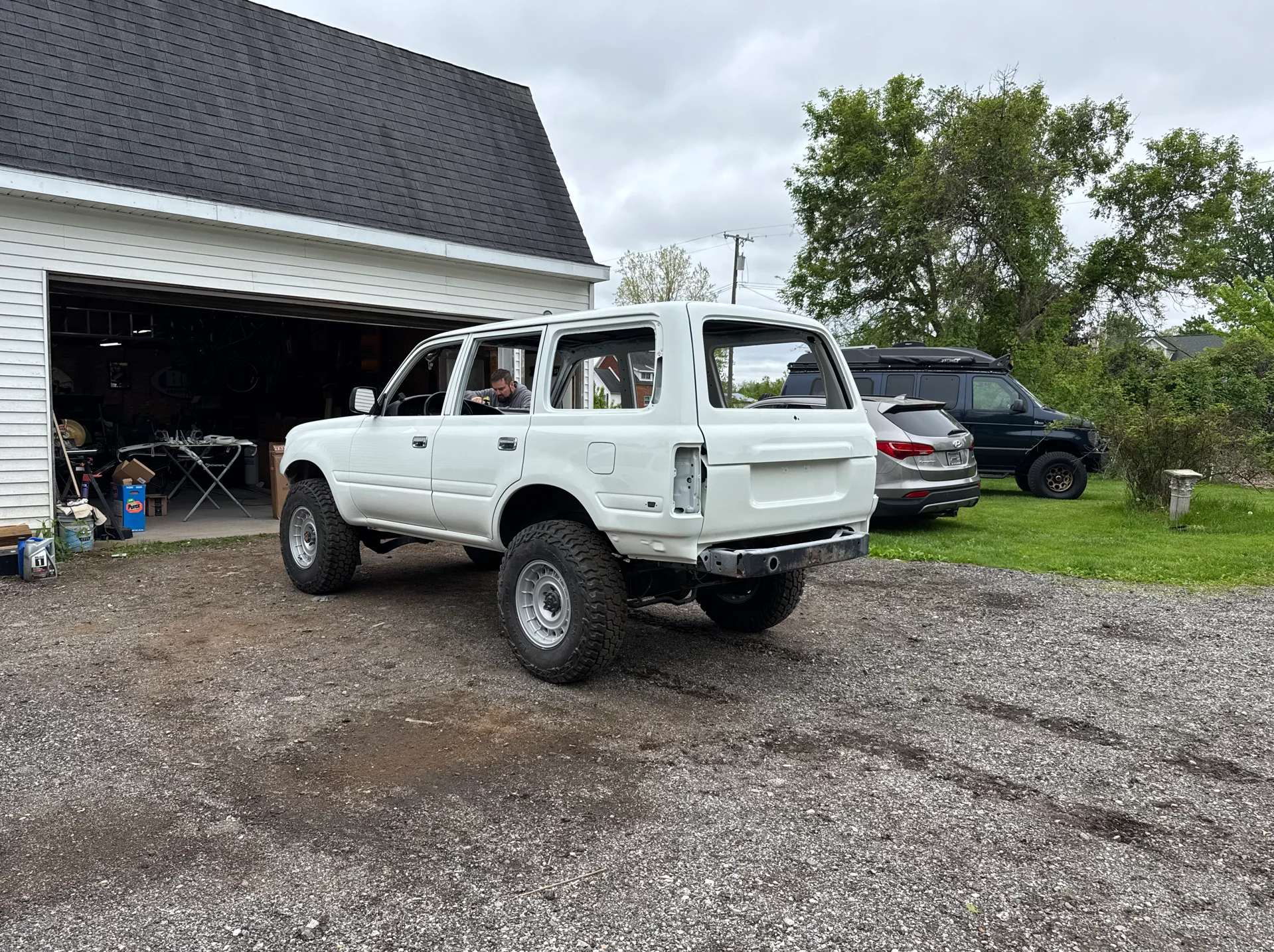

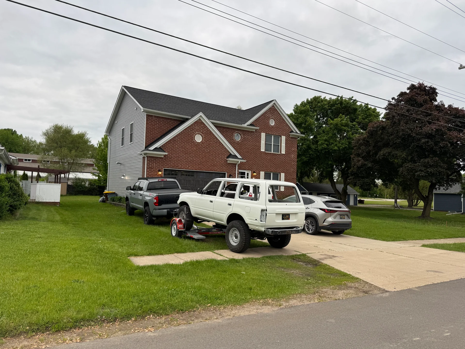

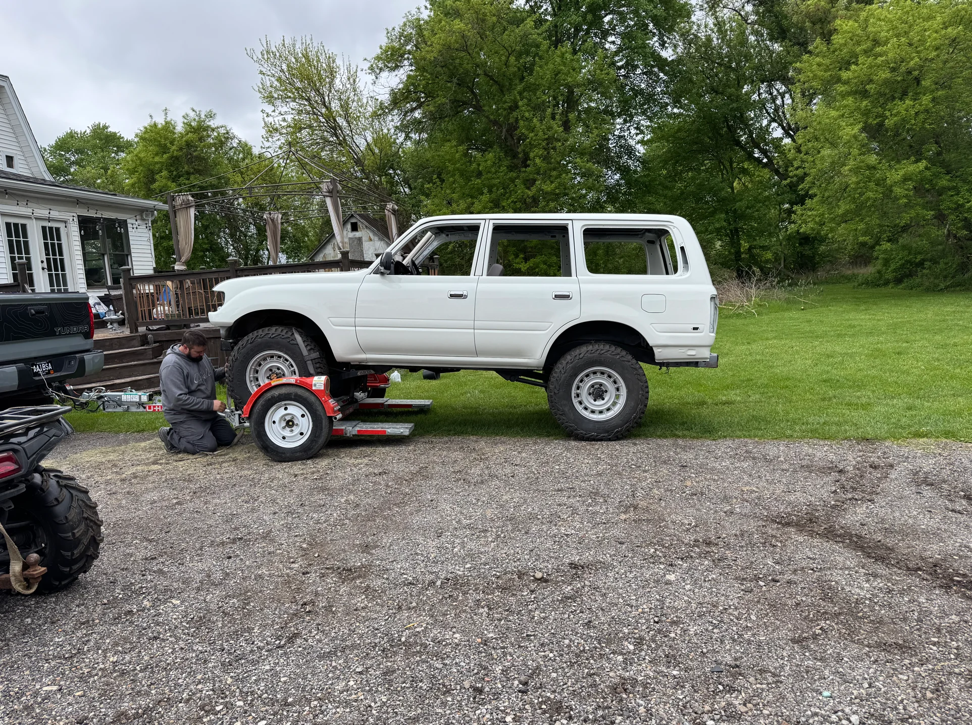

Finally, almost two months later on May 18, it was ready!
I picked up a uhaul dolly and headed over with a pile of parts. The plan was to install door seals, latches and handles in order to haul the truck home safely without damaging the new paint.
After a 100 mile run, she's home!

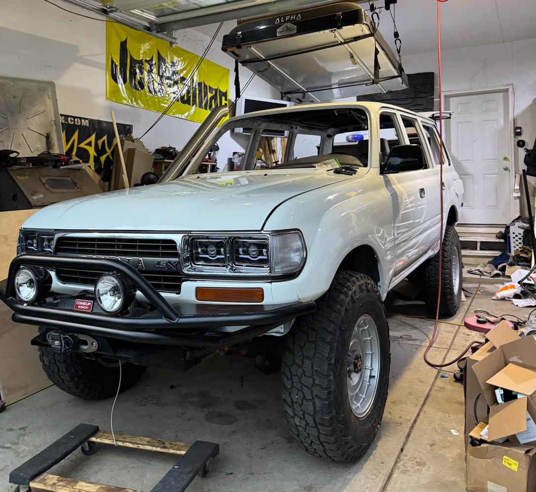

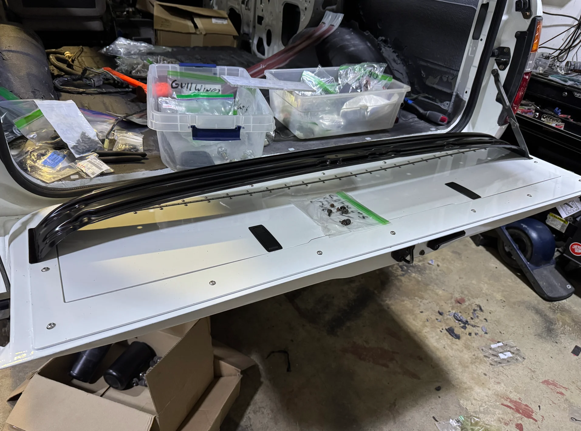

So far it's been a thrash putting things together as I have time. I started with the rear of the truck, and moved towards the front.
The rear hatch and tailgate are completely assembled. The only thing left is the rear glass, and that will be done by a professional after the headliner is in (More on that later). I sourced all new badging, including the Aussie spec part time 4wd badge.
The front end is completely assembled and almost ready to go. I sourced a new grille (complete with LSX badge to cover the three "Turbo" badge holes), mostly OEM quad's, and alibaba corners. The headlights are fully installed and tested. I also installed the freshly powdercoated bumper. The only open item is to complete the relocation of my winch controls. I tucked them under the valance, cleaning up the top of the bumper by quite a bit.
On the interior, I have three out of the four doors completely assembled, including glass. Everything got new or cleaned up regulators, seals, window runs, vapor barrier, etc... I'm also installing the Aussie door cards with chrome Poverty Pack belt molding.
The biggest hold up I have today is the headliner. I purchased an FJ80 (no sunroof) headliner from a manufacturer called Headlinermart. It seems to be a great quality piece, but they forgot to sew on the front A pillar fabric. They are sending a corrected headliner, and I expect it to arrive this weekend.
With the headliner installed, I can move onto the windshield and back glass, and get this thing back on the road!
