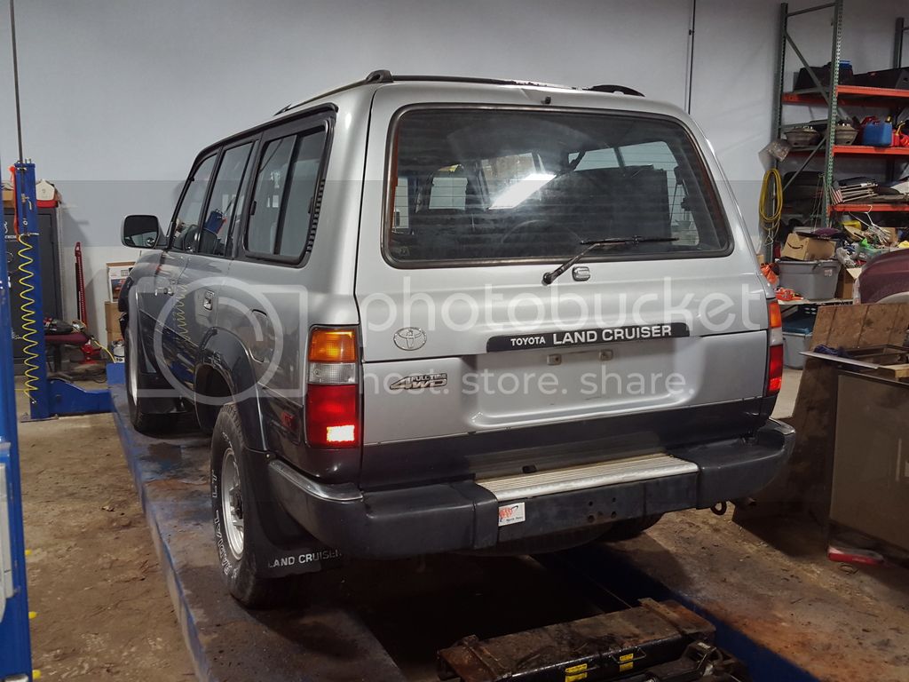

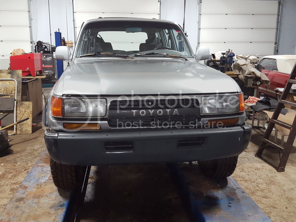

After some nagging and negotiation, I got the owner of this nice 1991 FJ80 to part ways with her. She needs a few odds and ends including brakes, knuckle rebuild, and some attention to minor leaks, but for the price I couldn't resist. Brought her home on the rollback today for the paltry sum of $1,600. Figure I can build a pretty formidable trail rig for around $5-6K all in. Here are a few pics.

Looks like the body is clean. Hows the frame and inside?
Have you thought about a atlas 4 spd transfer case?
Body and frame are in remarkable condition. A very tiny rust spot on the drivers rear door lower edge, and a small gouge in the passenger rocker. The passenger rear flare has gone missing too.
