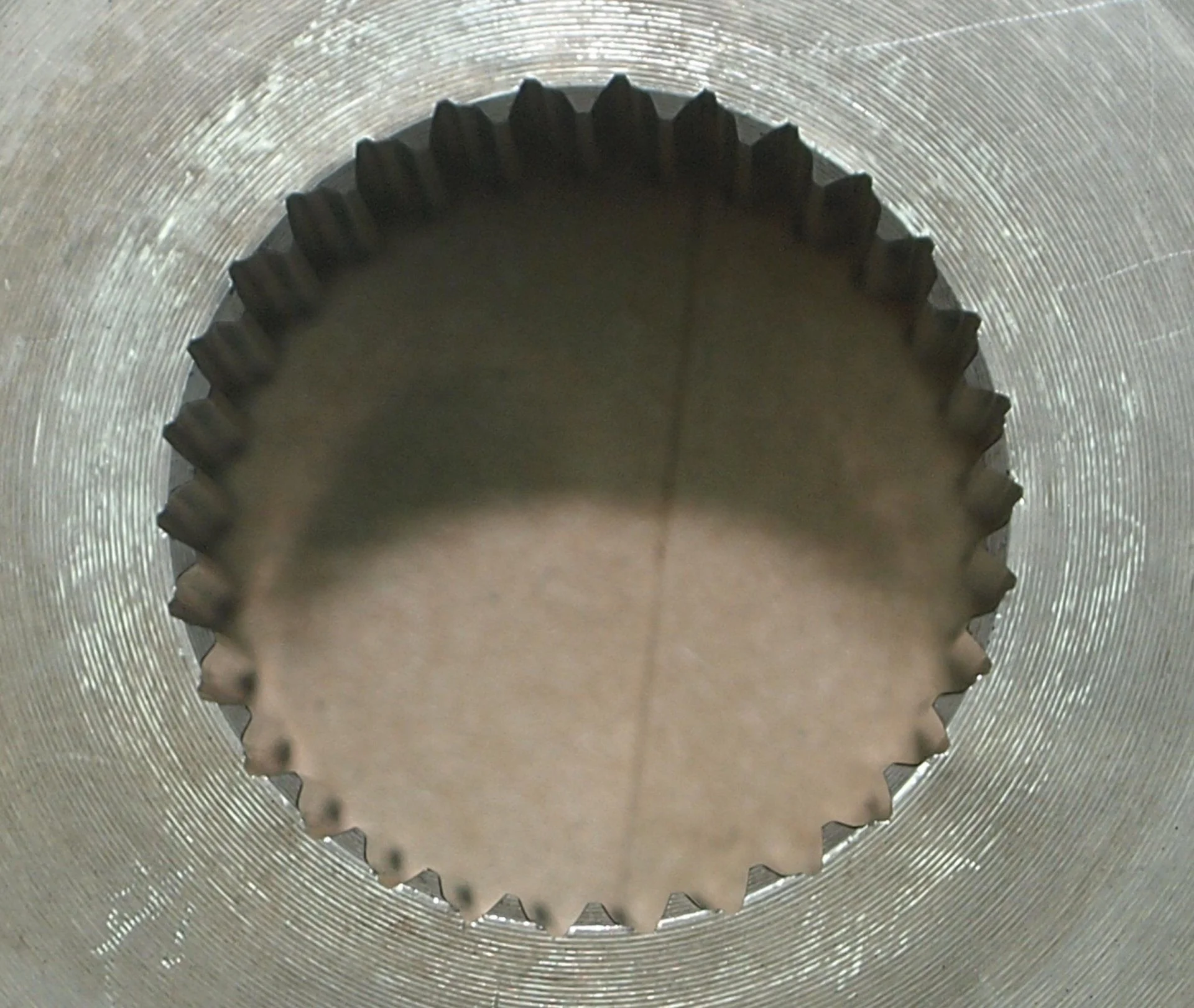

You apparently found you hub flange teeth worn. Something like this I imagine:
Worn hub flange teeth are most common associated with a N to D, N to R clunk (not pop). The front driver shafts axle teeth are probable worn as well in cases where hub flange teeth are worn. But most likely not very noticeable, as the metal of axle is much harder. If the CV(s) of the front drive shaft are shot (click while spinning/turning, remarkable twisting play) replace along with front hub flange makes sense. Replacing both hub flange and front drive shaft with new OEM yields the absolute best results. If CVs are serviceable an axle teeth are not noticeable worn you can just replace hub flange, then just live with some minor clunk (N to D). Keep in mind if you go with rebuilt front drive shaft(s) the axle teeth will be worn.
