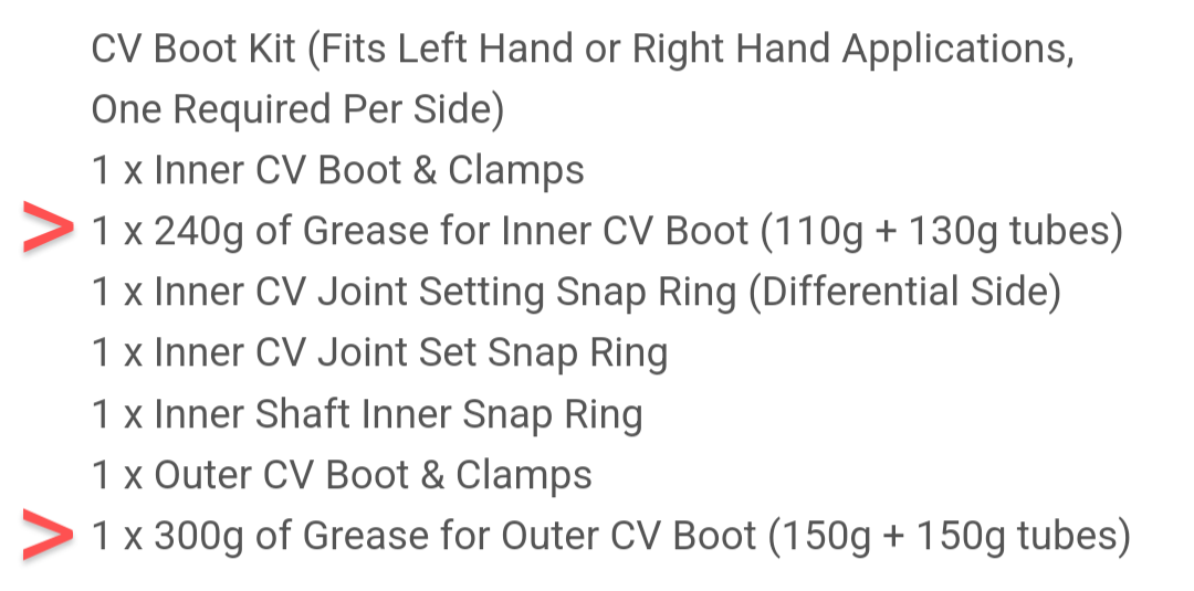

from an AU 4x4 parts site:
This is a new CV Boot Kit to suit Toyota Landcruiser 100 Series with Independent Front Suspension (not coil or leaf suspension) 1999 to 2005. This is one inner and outer CV Boot Kit, enough to do one side. Also includes grease for each joint. Smaller tube (90999-94241) for inner CV, larger tube (90999-94242) for outer CV. Genuine Toyota kit.

This is what I was seeing too when pulling 100 part numbers. There are a few people over on bobistheoilguy who state inner vs outter is different lube. Given that the joints are different it would make sense the tubes contained at least a different quantity which you're noting here.
my immediate assumption is its just for tech's to quickly put exactly the right amount toyota wants in inner vs outer. but sadly us non toyota engineers will ever know the real answer. i believe the toyota stuff is a light color though no? can moly grease be anything other than black/gray ish?

Just did these. The big tubes are a yellowish grease that kind of looks like earwax. The little tubes are a dark gray grease, possibly moly fortified. This matched the OEM greases I found in each end of the cv. This is really counter-intuitive as the larger inner tulip gets the smaller tubes/lesser amount of grease and vice-versa with the smaller outer tulip.
I also wasn't sure which boot went on which tulip till I checked sizing. The neoprene boot went on the inner tulip, and the plasticy one went on the outter tulip.
