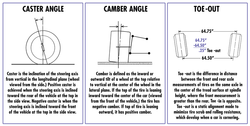

I’ll try to help, “cut and turn” refers to correcting your caster angle after a “mod” to your suspension or trying to effect more or less caster angle for a desired effect.
The factory FJ55 spec I found called for ~1° of caster, with the slow speed and manual the pig was intended for this is not a bad choice, add power steering and drive a bit faster and more positive caster is desirable, + 3° is a good starting point for modern Pigs.
If you add a lift and or longer front shackles you will in effect remove what little caster you had making your pig very “darty” or very unstable to drive, caster shims can get you back the caster you need to stabilize the steering you need at speed but the better option is to cut and turn your knuckle balls and rotate them to the required angle.
