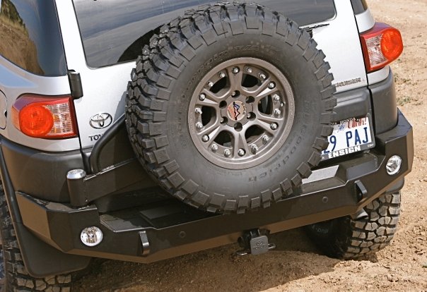

Hi, now that I am back we can sit down and think about the design a bit more seriously. I talked to Drew a bit about it and so far the only available rear bumper that is a good choice and uses the back up sensors as well as has a tire swing out that is attached to the rear door does need some more improvements to make it better. From the wasted space I saw on the rear of the FJ the rear cross member can be entirely cut off and the bumper would replace it, the hitch can be recessed into the bumper giving the vehicle a much greater approach angle as well as shortening the rear by about 3-4". Drew's interests were focused on convenience and the ability to open both the tire swing out and rear door at the same time - which is not that rad to do but building safety and a back up lock for just in case is much harder and then becomes less convenient. We should sit down and see what you guys want and take it from there.
On a side note, Robert's bumper had some trail tests and did really well in some things and I will need to upgrade some other things. The clearance is greatly improved and he barely managed to touch it on the worst crossings, regrettably he backed into a tree and one of the swing outs hit which caused it break the locking pin and actually bend the stopping plate which was reinforced 1/4" steel - very impressive Robert! The swing outs were never really designed to act as tree pushers but I might have to redo the design to compensate :D . Also I've noticed that the UHMW (or whatever the hell that plastic is) is more durable then powder coating so I will be making a 2 piece slider for the swing out, one that is bolted to the bumper and the other to the swing out so it's plastic on plastic. That will assure many years of trouble free use.
