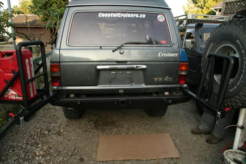

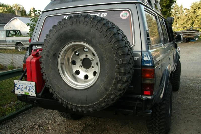

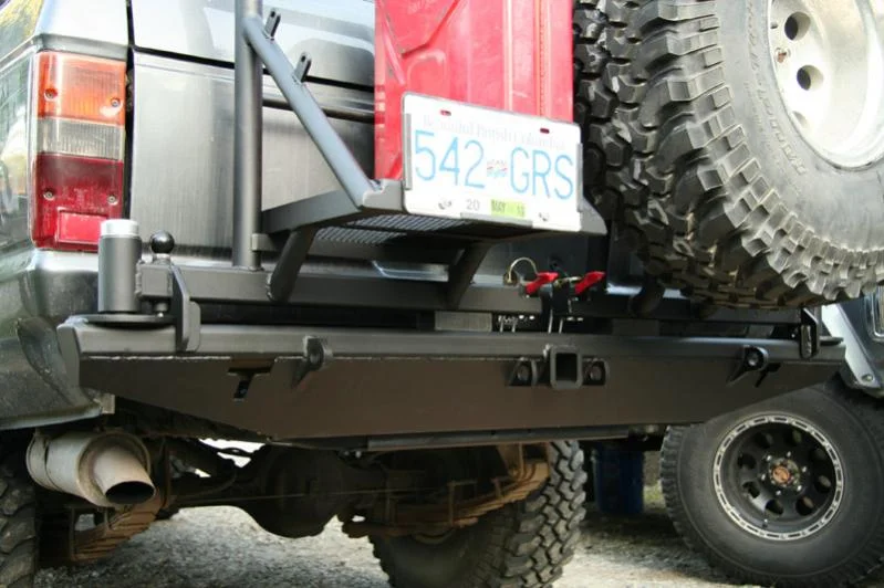

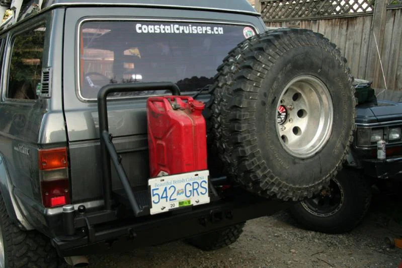

I have recently finished 2 new back bumpers, fully loaded, one for Robert C. and one for Sopel. I will post pics up soon and with any luck you guys will see one on Robert's truck for Cruiser Days.

Specs:

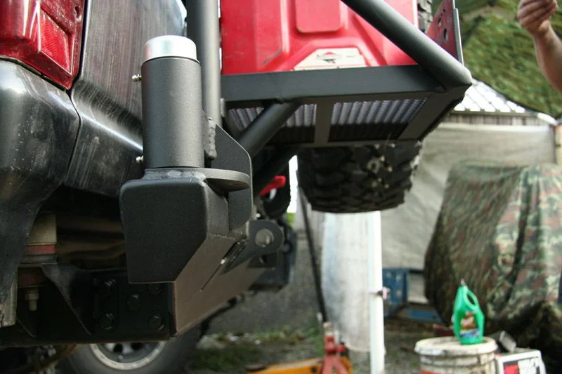

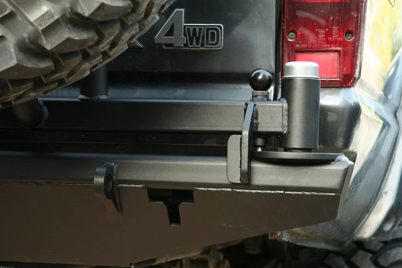

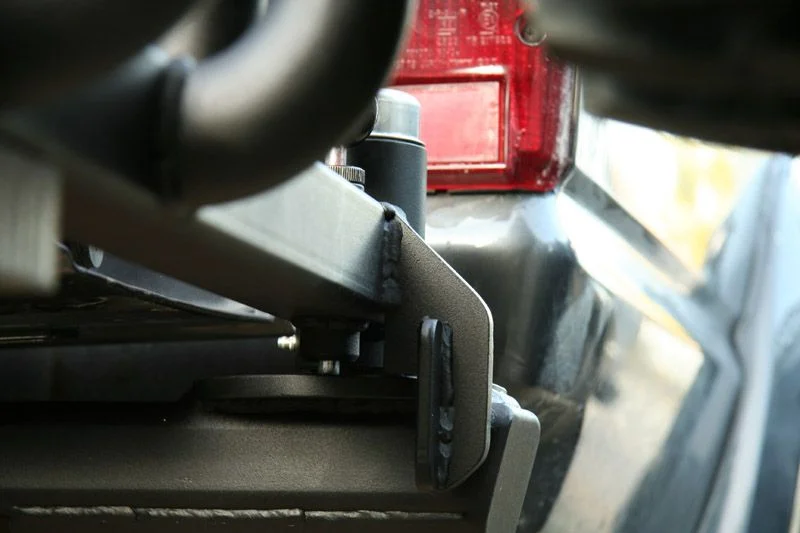

these are custom built for Sopel's and Robert's trucks, they have an 1 1/2" body lift and needed to be higher then regular ones. This design offers maximum approach angles, has 1/2" thick mounts straight to the frame that utilize 5 mounting bolts (3 existing for the bumper and 2 for the body mount bracket). The main cross member is 1/4" thick 2X3 with a full size hitch receiver, although it's not rated it is equivalent to a class V hitch, everything has gussets for maximum strength, the tow points are done to accept a 3/4" shackle. There are special cut outs for Jack-All lifting points that will not slip out of position.

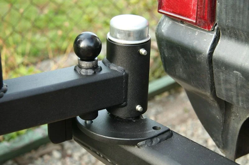

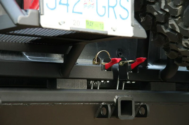

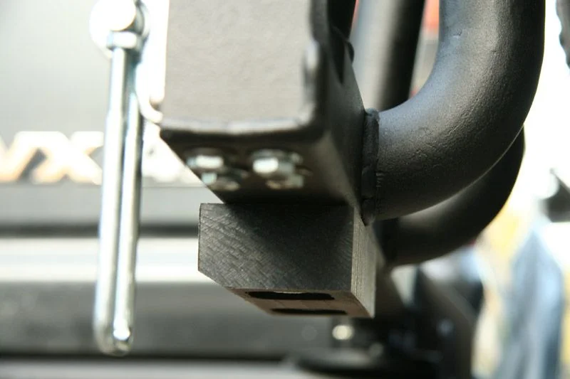

The rest of the bumper and swing outs is made from 3/16" material, the swing outs are removable with ease for in town or daily driver vehicles. The actual swing out is done with a 2 bearing system and very durable, the clamping system used here is a basic system with an external and separate locking pin that will not release accidentally. There are extra safety locking pins to make sure the swing outs do not move out of position. The swing outs are also equipped with sliders to relieve the stress from the bearing while in stowed position.
They have been sand blasted and powder coated with a very durable textured finish.
Some modification to the truck is was necessary, some of the cross members interfere with the bumper mounting but after the bumper is installed they are not needed. These units were custom built for this application, others can be manufactured to each individual's needs.
Now I need a new keyboard because I drooooollled all over it! Very nice work, love the greasable bearings on the hinges, the locking pins are nice touches!
