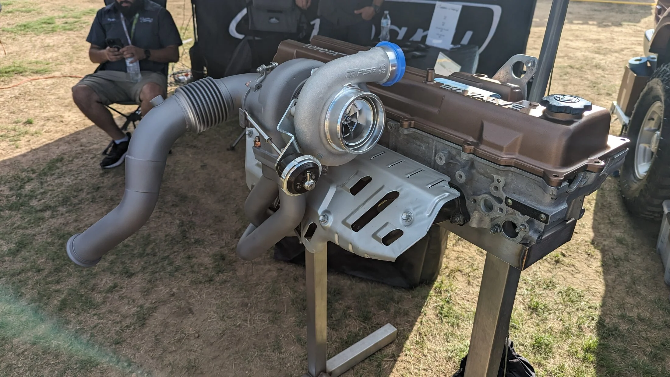

Expo was crazy awesome and a great experience for the Cruisers and Company crew but it's Monday and we're back at work....
The next one is being torn down this today! 1996 FZJ80. Engine rebuild, Turbo, Transgo, full exhaust, and a ton of other goodies!

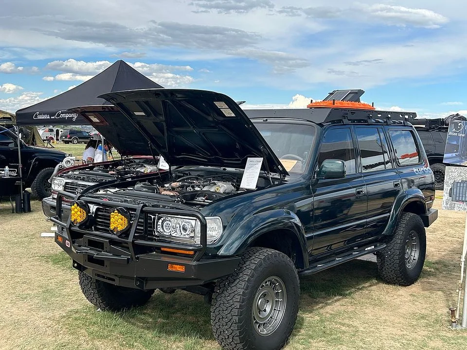

That Rig was at SAS 😎
The Garbo's have some of the nieces 80s out there !! and this one is only getting better 😍
Starting to feel like Ol Rosie is old news! @kelly saad is going to change that!!
Rosie was big big news at overland Expo Mtn West! The color choice was very visible in the daylight and YES once Kelly is done will be a thing of beauty 😍 very well received at the show! Many approve!

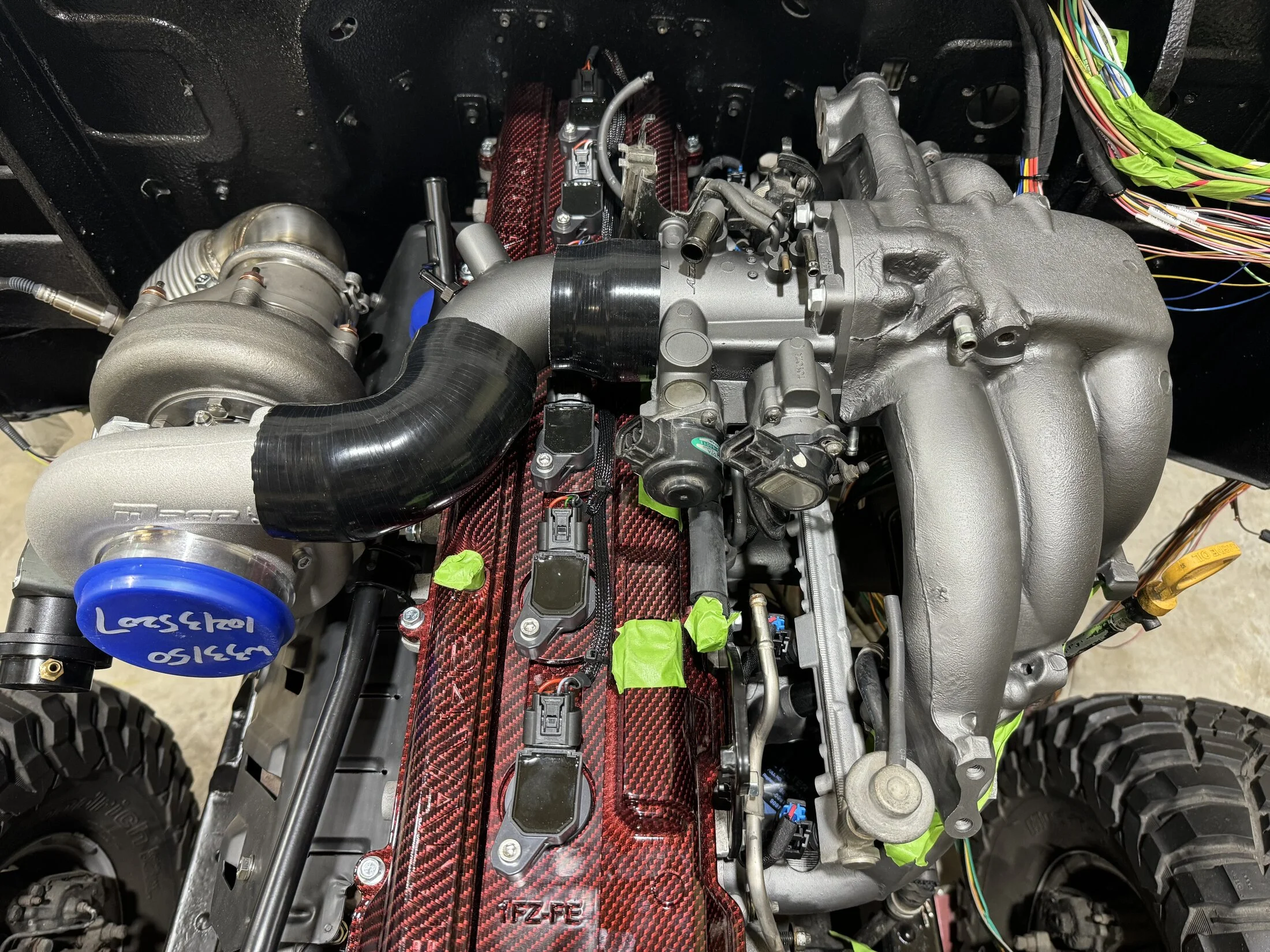

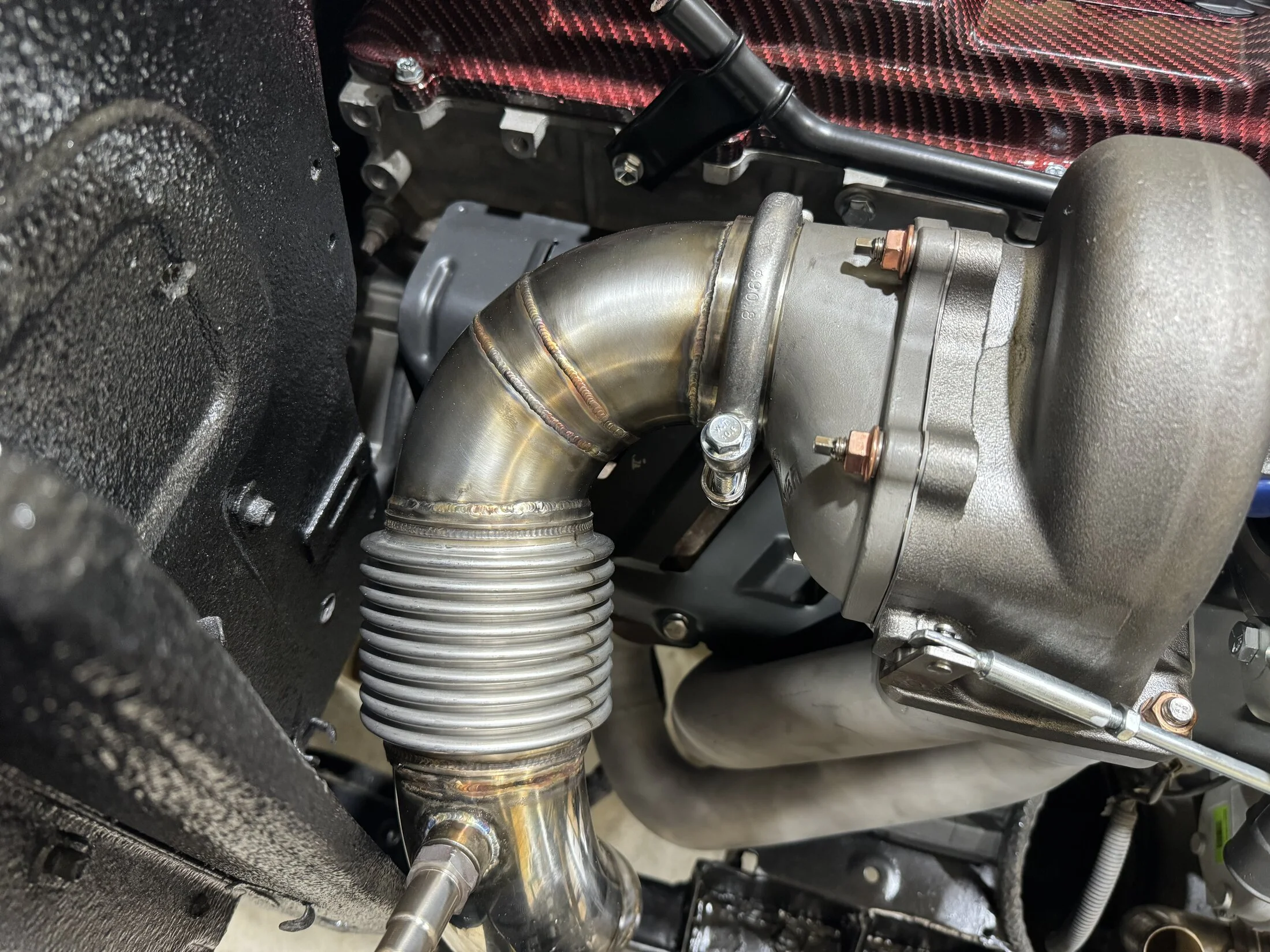

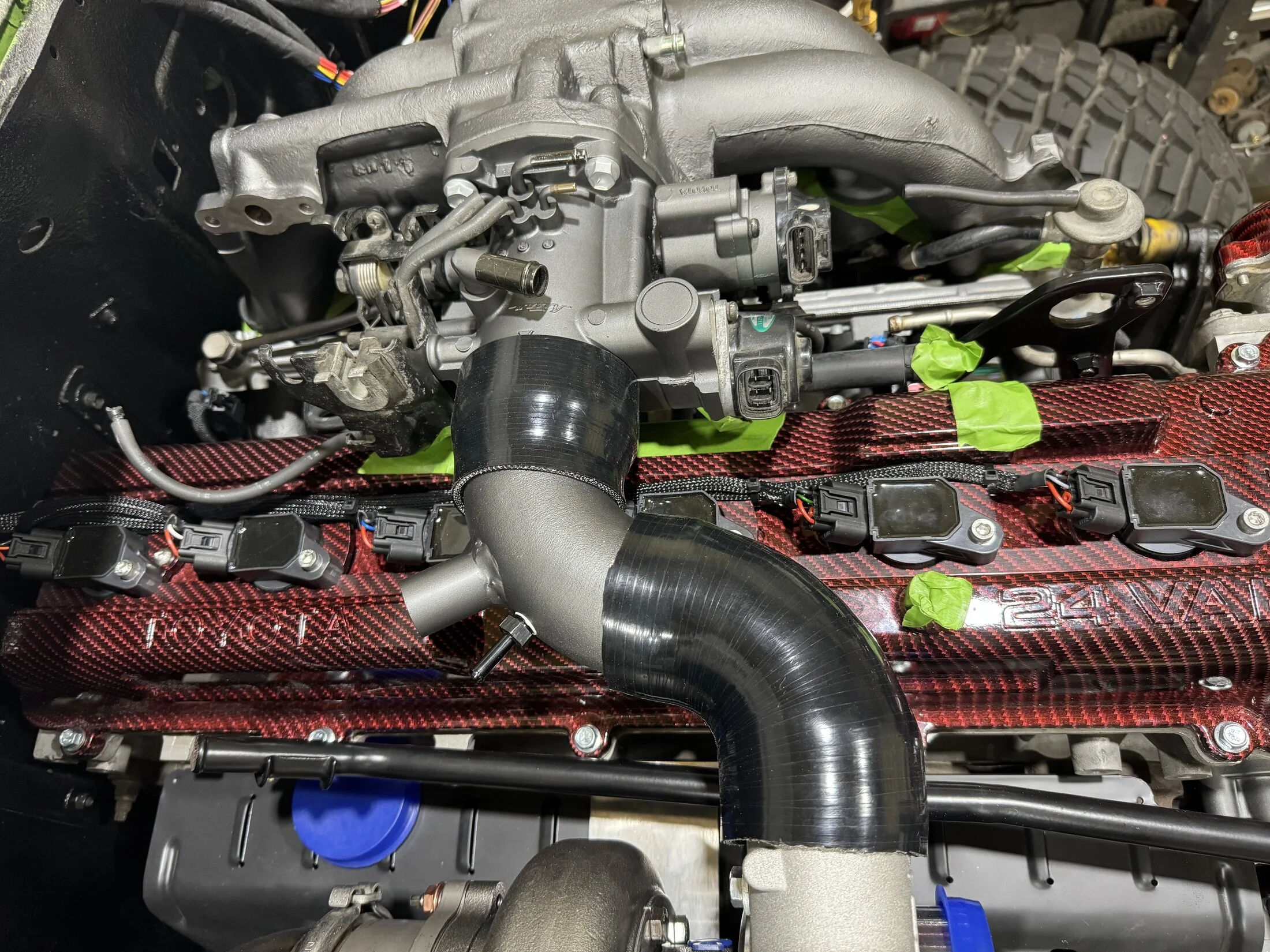

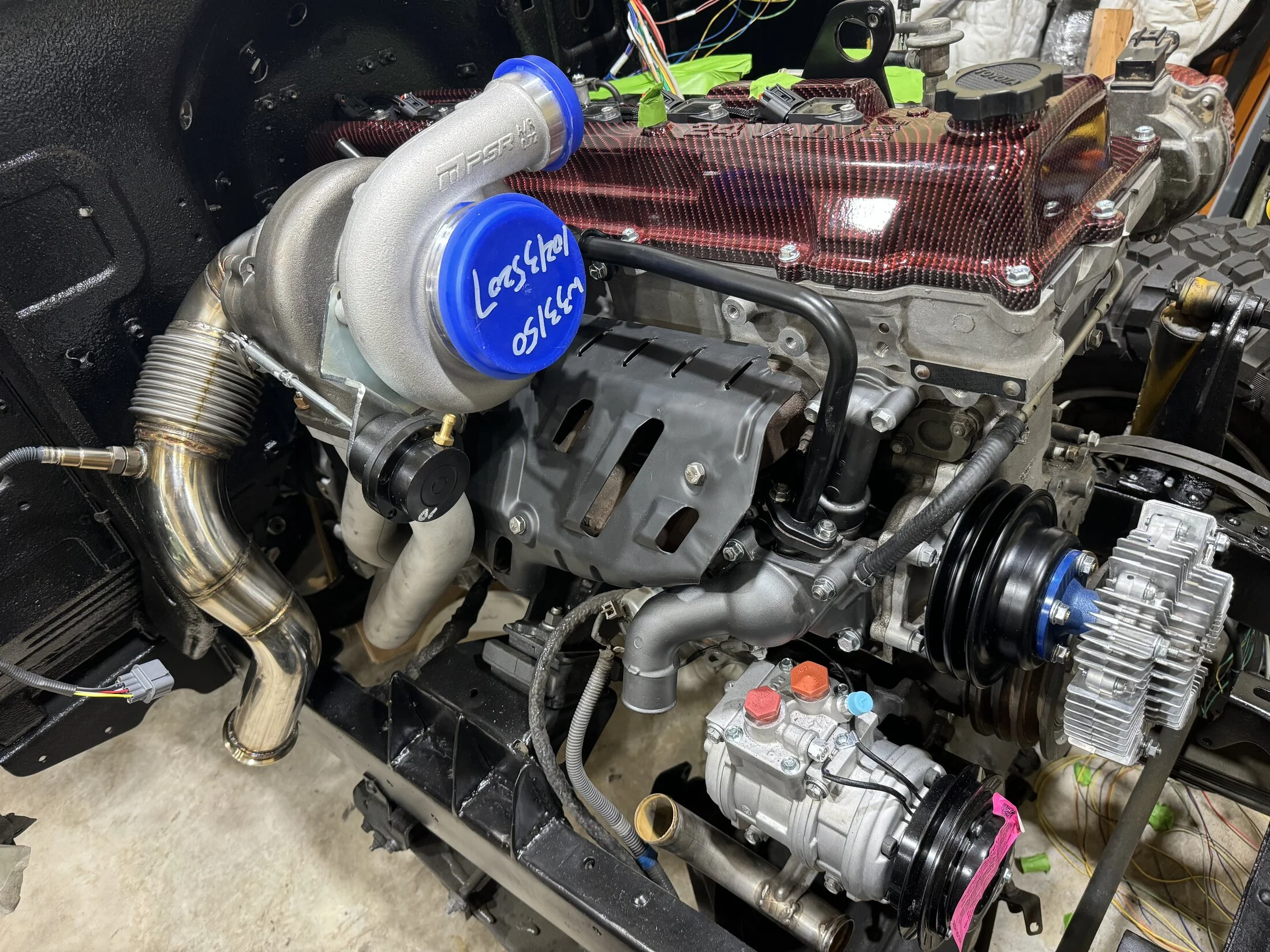

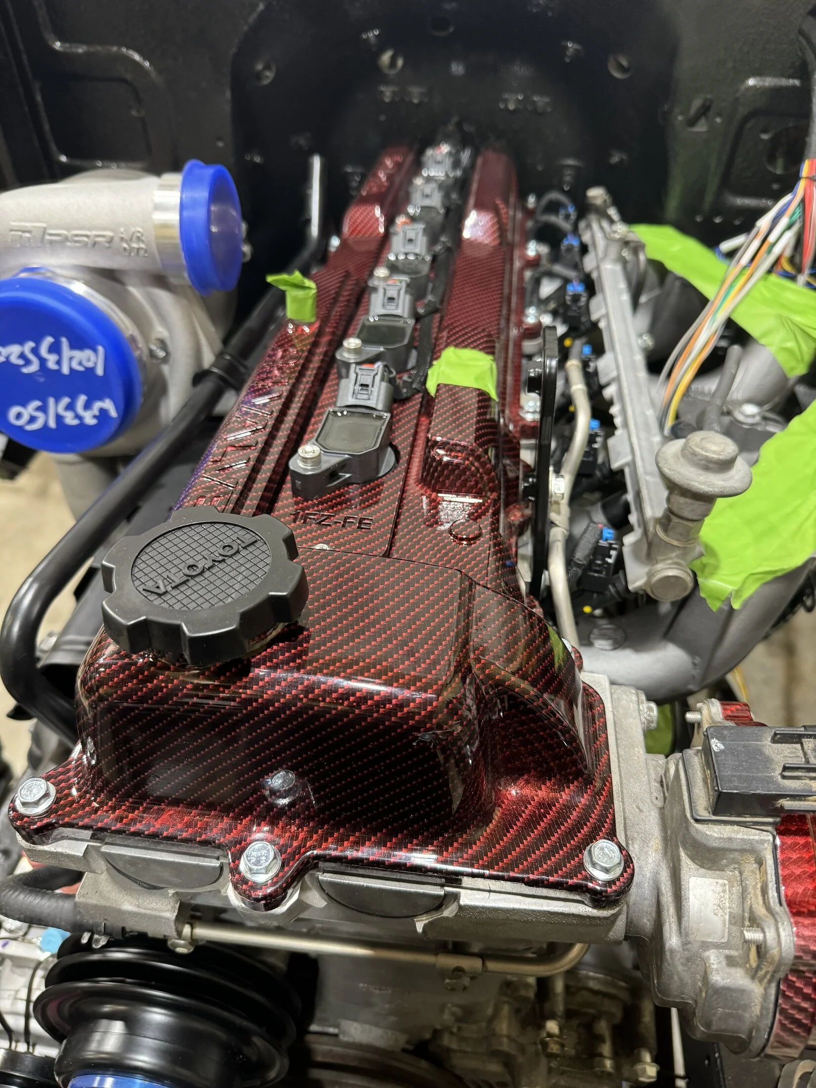

Can't wait to see this truck done and it really didn't take a ton of modifications on the downpipe to make it fit which is awesome! Keep going @samc2447 !
Just had to add a wedge in the downpipe to move it forward to clear the firewall support. The turbo kit itself is very nice and I would definitely recommend it to people looking to upgrade an 80.
This truck is using a Haltech 2500 elite stand alone ECU and has an H55 trans. Should get up and go nicely with the turbo.

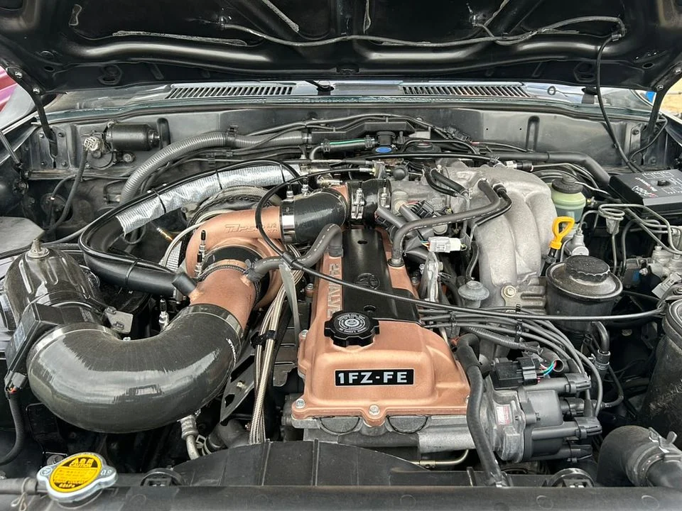

I had an opportunity to drive a supercharged 80 Thursday and I wanted to share my thoughts and compare it with the turbocharged trucks that I’m familiar with.
To start off, I have a naturally aspirated 97 80. My truck is on 33” tires and 4.10 gears. It’s a solid truck, runs well and gets decent fuel mileage (for a Land Cruiser haha). So I’m using that as my baseline for comparison.
I’ve driven several turbocharged trucks recently, all of them being a “stage 1” setup, but having different exterior modifications like tires, gearing, and armor.
The Supercharged 80 I drove yesterday had 315s, front and rear steel bumpers, and 4.56 gears. It moved okay but felt fairly sluggish at lower RPM, not much faster than my 80. The midrange power was unimpressive, and the top end of the RPM range yielded a bit more power and pull compared to my NA 1FZ.
Overall, the supercharger does add some power to an 80 but I wasn’t that impressed with the power delivery.
The turbocharged trucks that I’ve driven are much more responsive throughout the RPM range. The turbo does need time to spool up, but once it does it’s much more noticeable. The mid-range to top end pull from the turbo is significantly better than the pull from the supercharger.
I’d heard mixed reviews about the supercharger on the 1FZ-FE and so I was happy to get some hands on experience with this setup. After comparing the two different forced induction setups I feel confident that the Turbo setup yields more power and performance than the supercharger.
If I were spending my money on some horsepower upgrades, I’d definitely go the turbo charged route.
How does you NA rig compare to the turbo rigs from a dead stop full throttle 0-60? Interested to know how much of a turbo lag is present.
It’s hard to explain the turbo lag from a dead stop, I’ve not timed it. I’d guess it’s only a couple of seconds before it begins to build boost.
0-60 will not be much of a race.
Maybe we’ll have to set up a drag race and post up the video.
