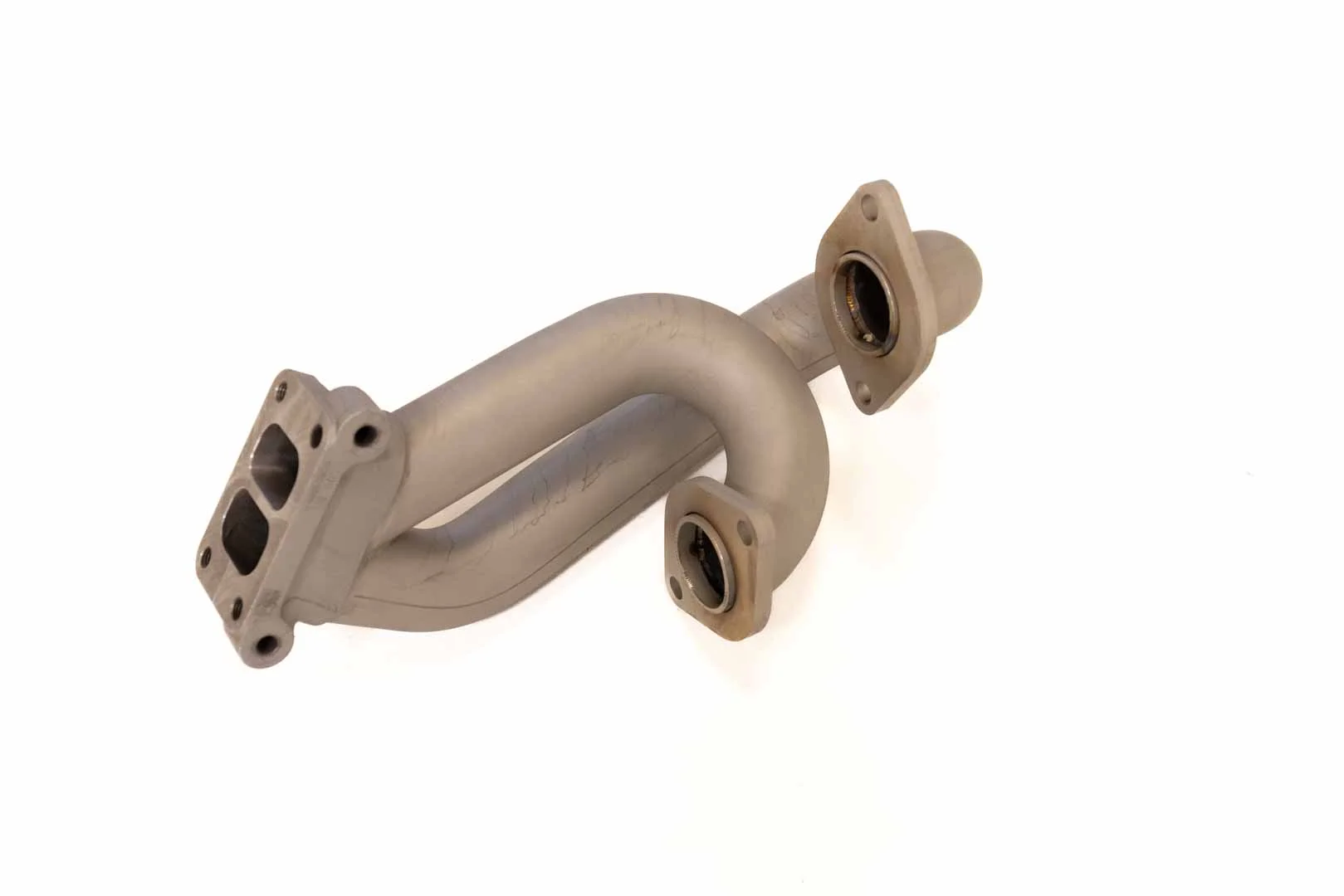

Was also able to finally shoot photos of our new style of J Pipe. Decided to bead blast them to clean up some marks from the bending process and DAMN they look good... Almost seamless!
