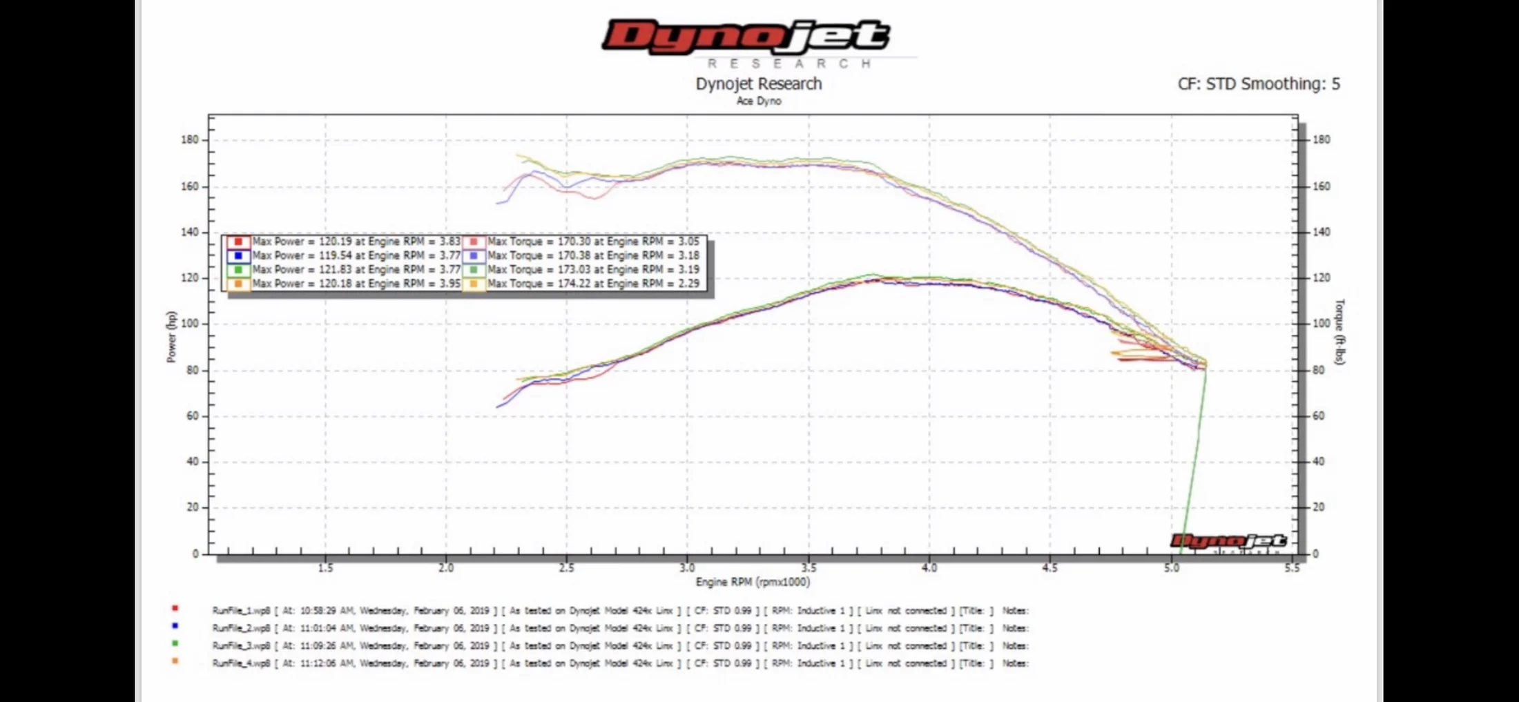

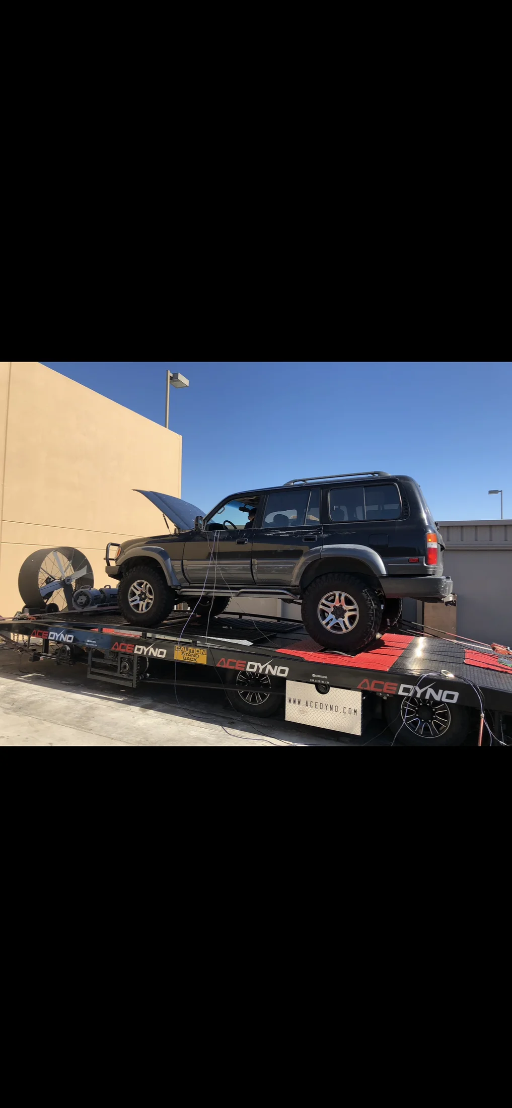

Interested to look at the dyno graph, that's very good stock power for a 1FZ

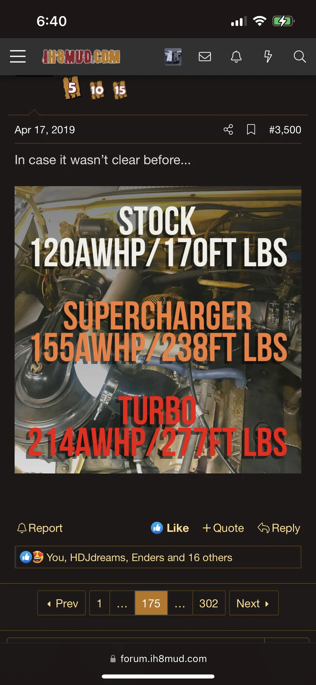

I dyno’ed my rig, pre-turbo, before install of my WE turbo kit. 120 HP.
These were the numbers Joey used for his turbo comparison.
Post turbo numbers were 214 HP.
Obviously not the same kit, but numbers are probably in the ballpark. For comparison only.

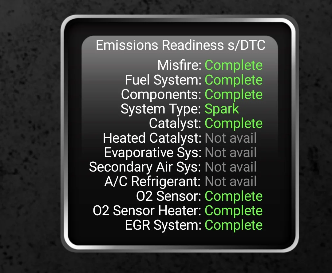

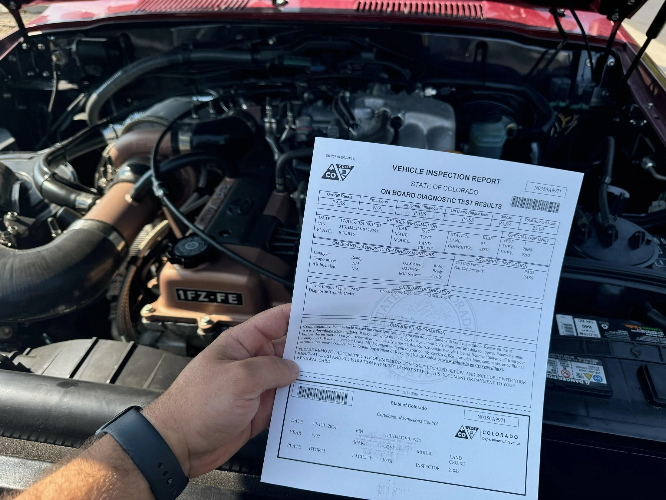

Alight guys and gals it's taken us way too long but we can confirm our 1FZ-FE Turbo kit will pass Colorado Emissions! All the Emissions Readiness DTC's completed this morning so off Rosie went to Air Care Colorado. Results below!
This morning Ryan took Rosie to the Air Care station down in Sheridan on the south side of Denver and it passed via OBD2 Port Readiness. They would not put it on the rollers due to tire size... Even though the website said they would take over 34's and Rosie has 35's... So they plugged in the scanner and deemed it good to go.
While awesome it passed... this was not good enough for me so I sent Ryan to the Ken Caryl Station in Littleton because they also supposedly took large tires at that station. After much confusion with the techs not understanding why a truck that passed 30 minutes ago needed to be tested again Ryan was able to convince them to do it. Something about new cats and wanting to know exactly how clean it's running...
Yeah she is burning CLEEEEEAAANNN!!!
