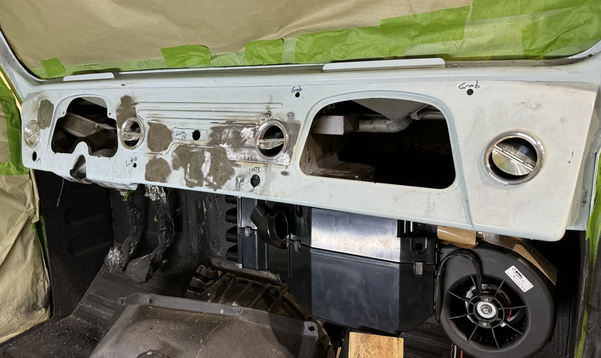

Rough plans:
  • Refresh brakes (calipers, pads and soft lines)
  • Rebuild birfs
  • Add FZJ80 PS box
  • Restore parking brake
  • Replace Chevy wheels with Toyota w 32x10.50 km3s
  • Dakota Digital cluster
  • Repower with a 1fz-f and h55f/split case
  • Custom fuel tank like found on the farm fresh build (fuel pump in tank)
  • Dobinson’s springs with IMS shocks

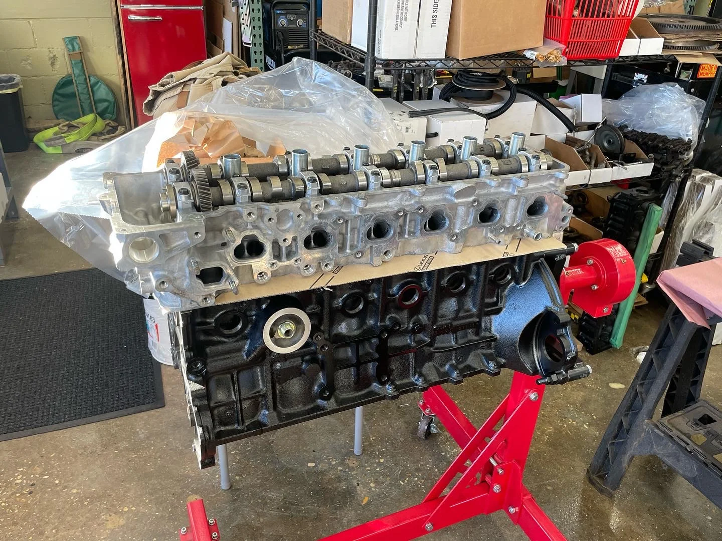

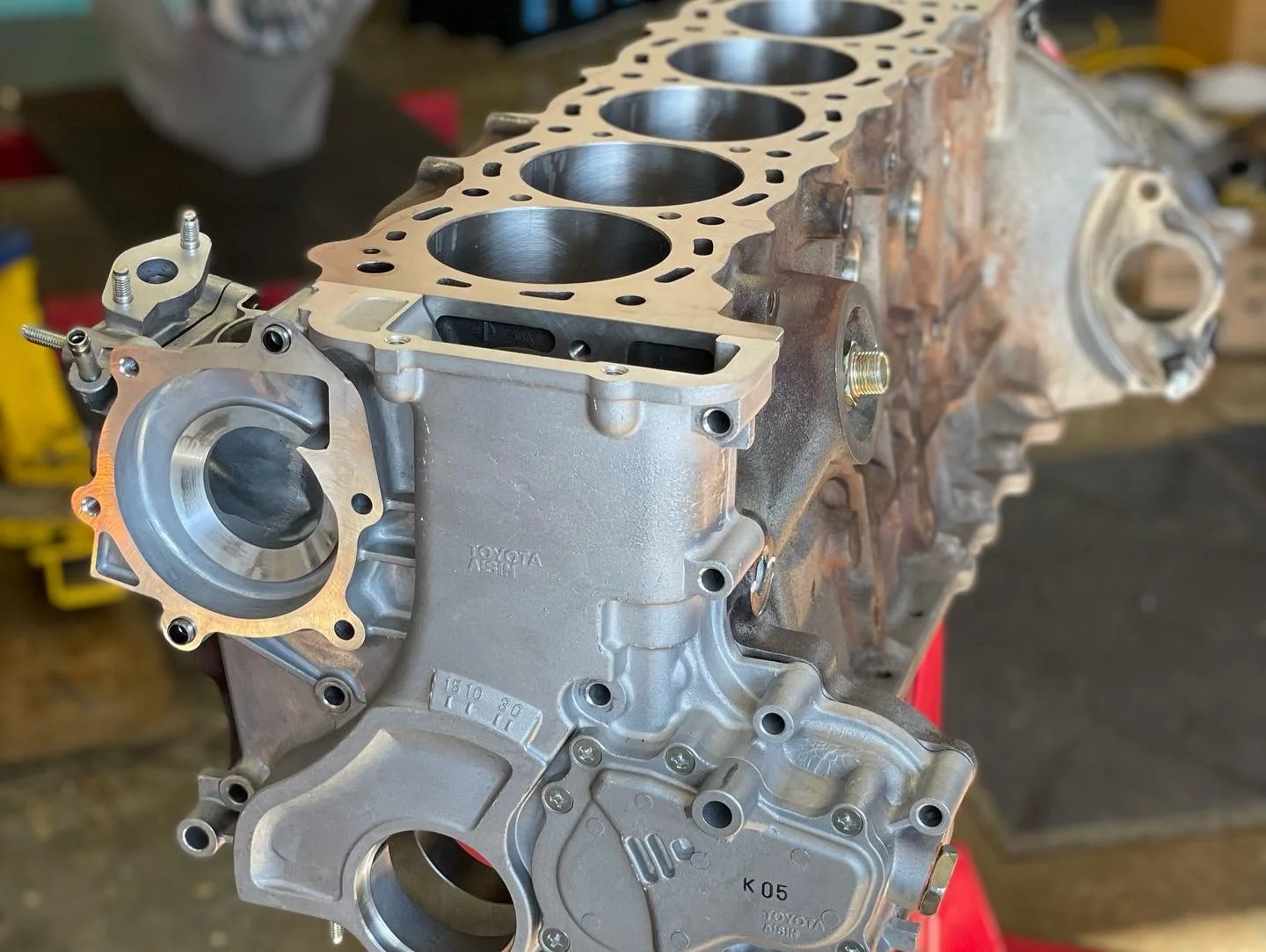

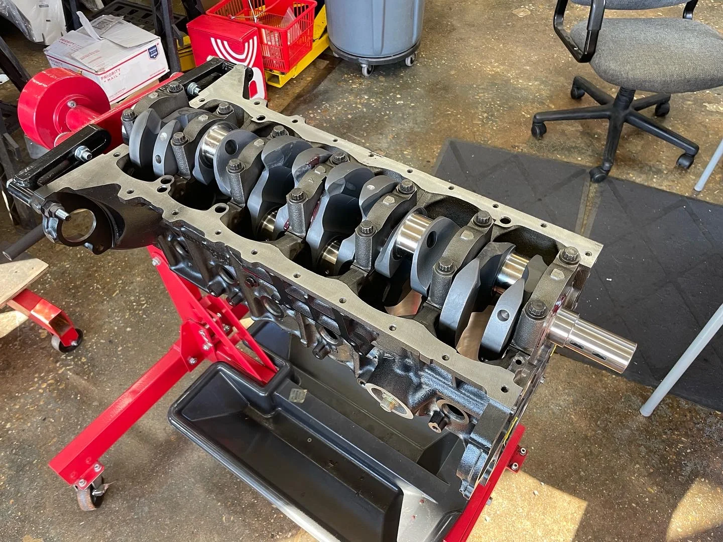

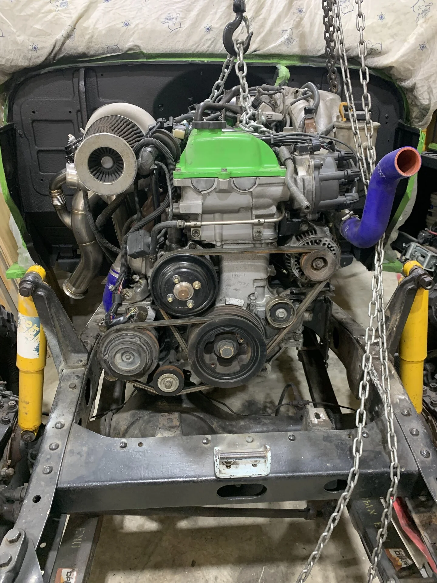

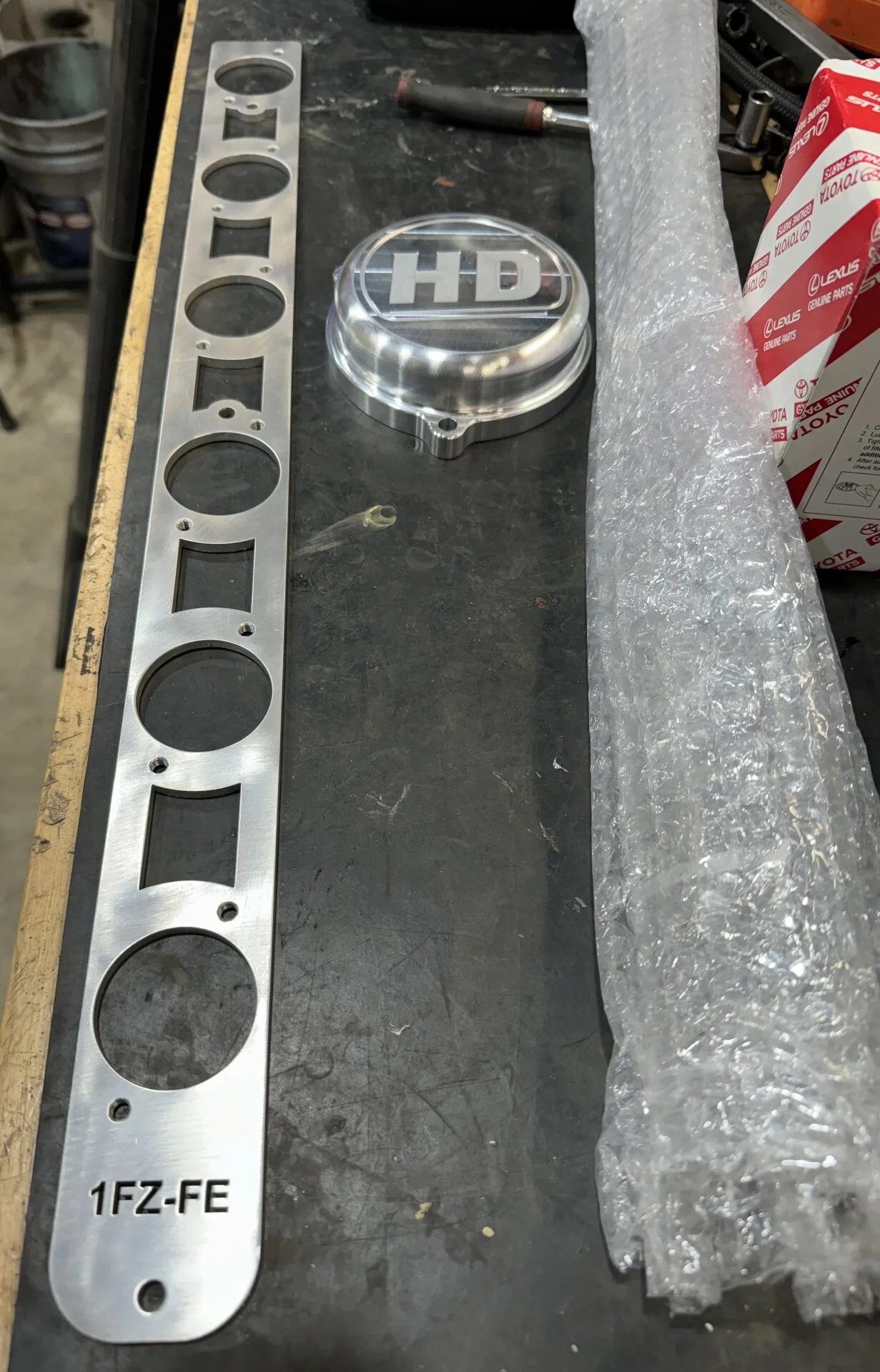

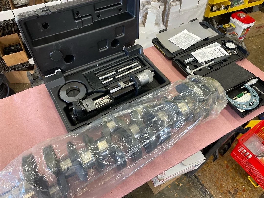

@FJ60Cam at Mosley Motors was already building a 5.2L (100.5mm bore, 108mm stroke) 1fz-f with a carb intake I’d acquired. The rotating assembly is from Brian Crower with CP pistons at 10:1 compression ratio and the I-Beam rods.
The bottom end is probably good to 8,000 rpm. But it’s going to be limited by the sniper. At a displacement of 313ci the motor passes 575 CFM at 7500 rpm. The 2bbl Sniper will only pass 580 CFM, so if nothing else limits it, the sniper will. If it gets too annoying I’ll order the Plasmaman intake for it.

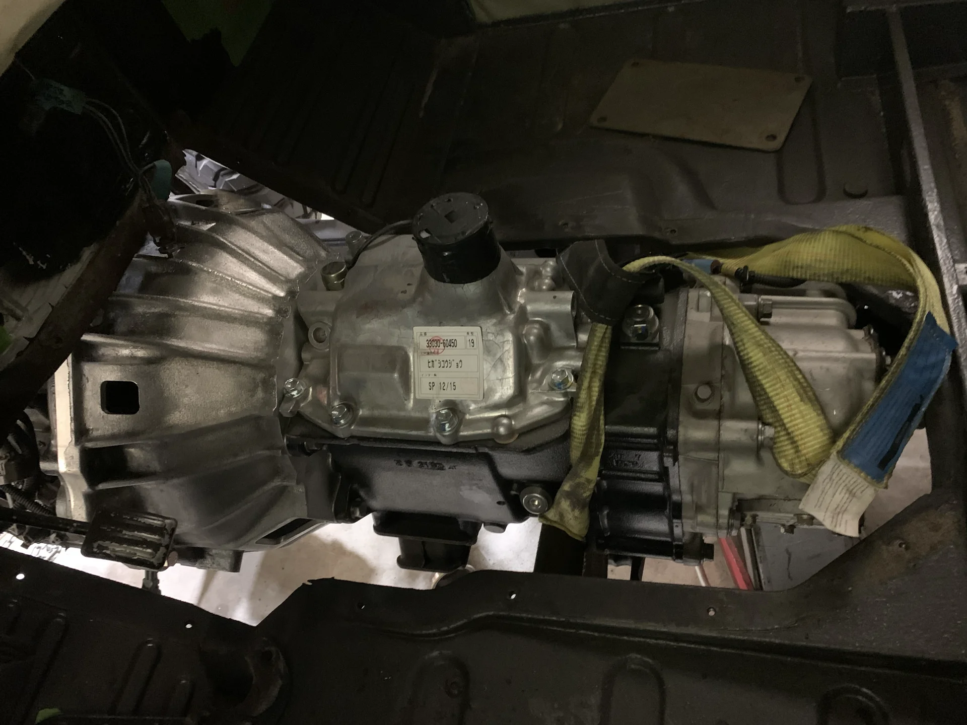

@orangefj45 built a h55f / split case combo with a factory parking brake and the Sumitomo 3:1 low-range gear. The truck has 3.73:1 gears in the thirds.
I don’t plan to spin it that tight… most of the time. It’s a torque build.

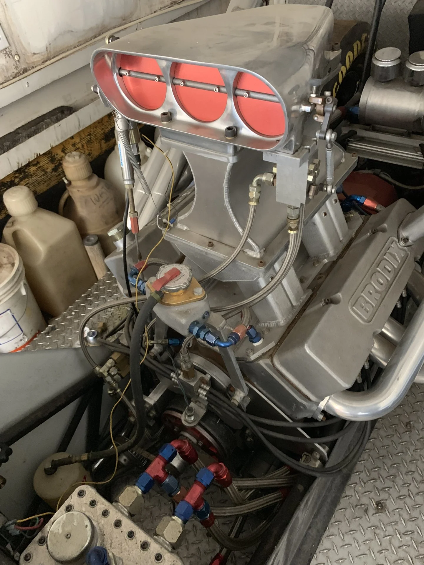

Dad had a dragster with a 427 ci “small block chevy” in it. 4.0” bore, 4.25” stroke. Oldsmobile “Rocket Block”. It made 893HP at 8,000 rpm on methanol.
This engine is essentially the same stroke and bore with 3/4th the cylinders. Conservatively, I figure 275HP at the crank, 225 rwhp.

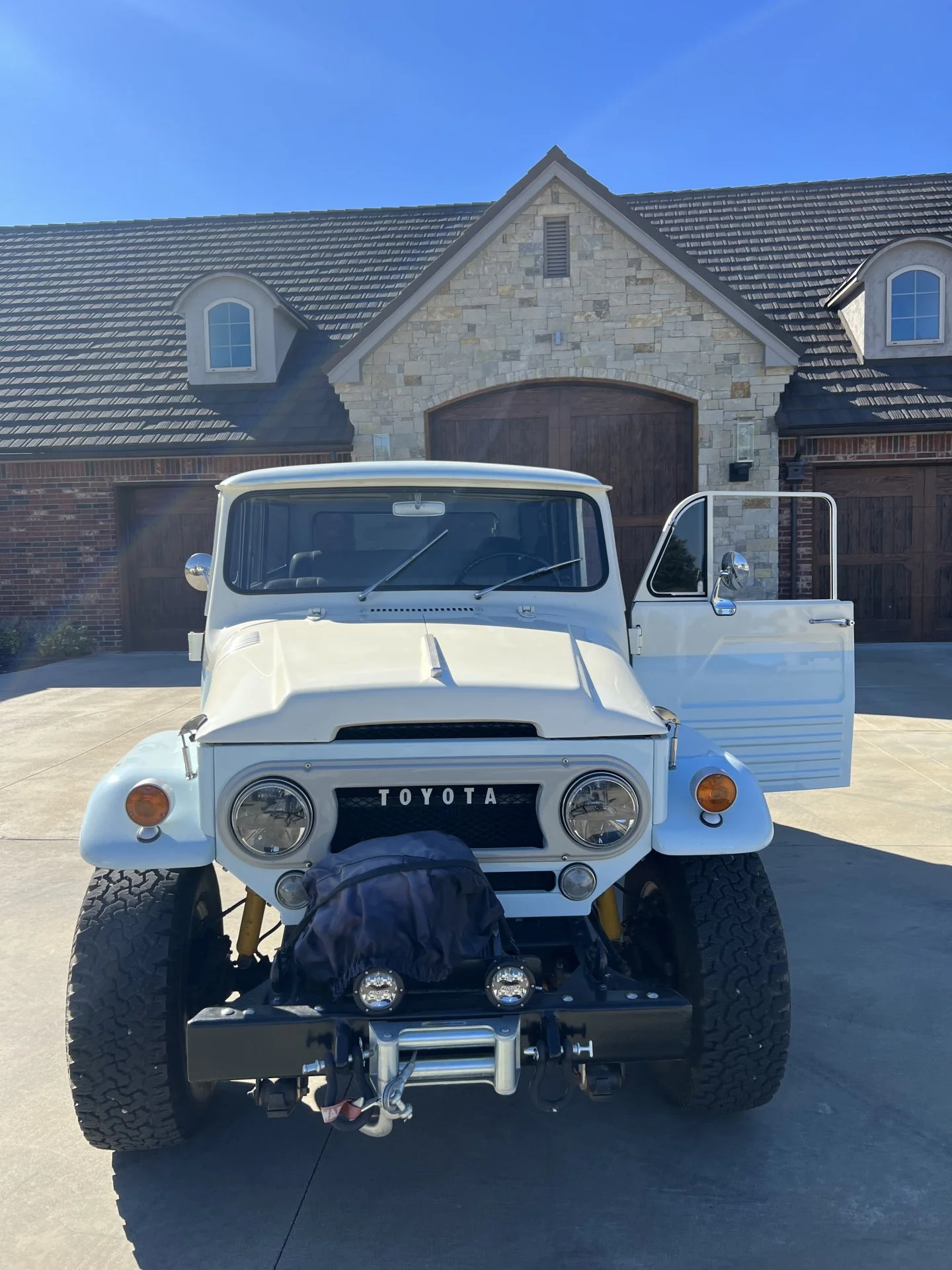

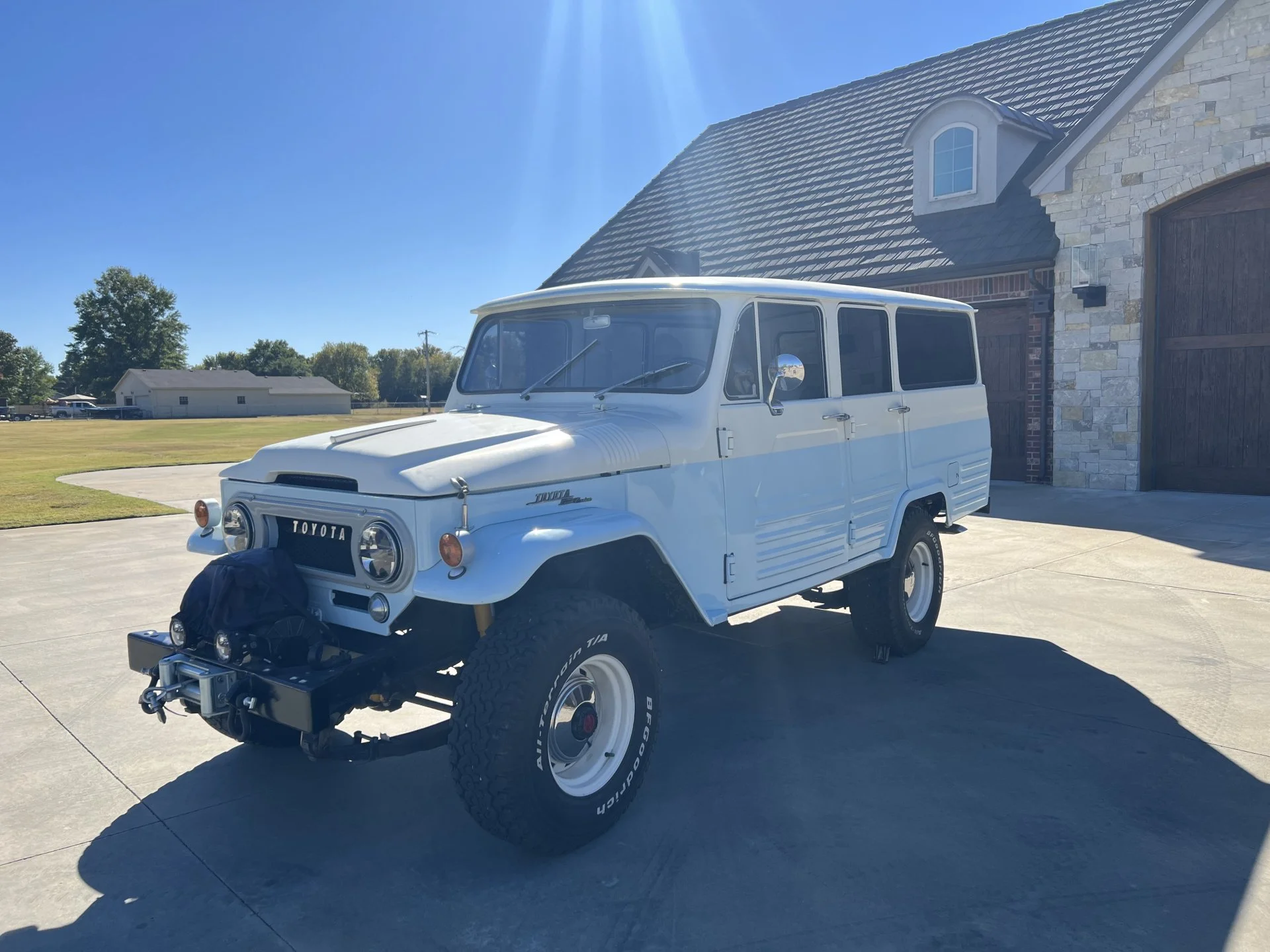

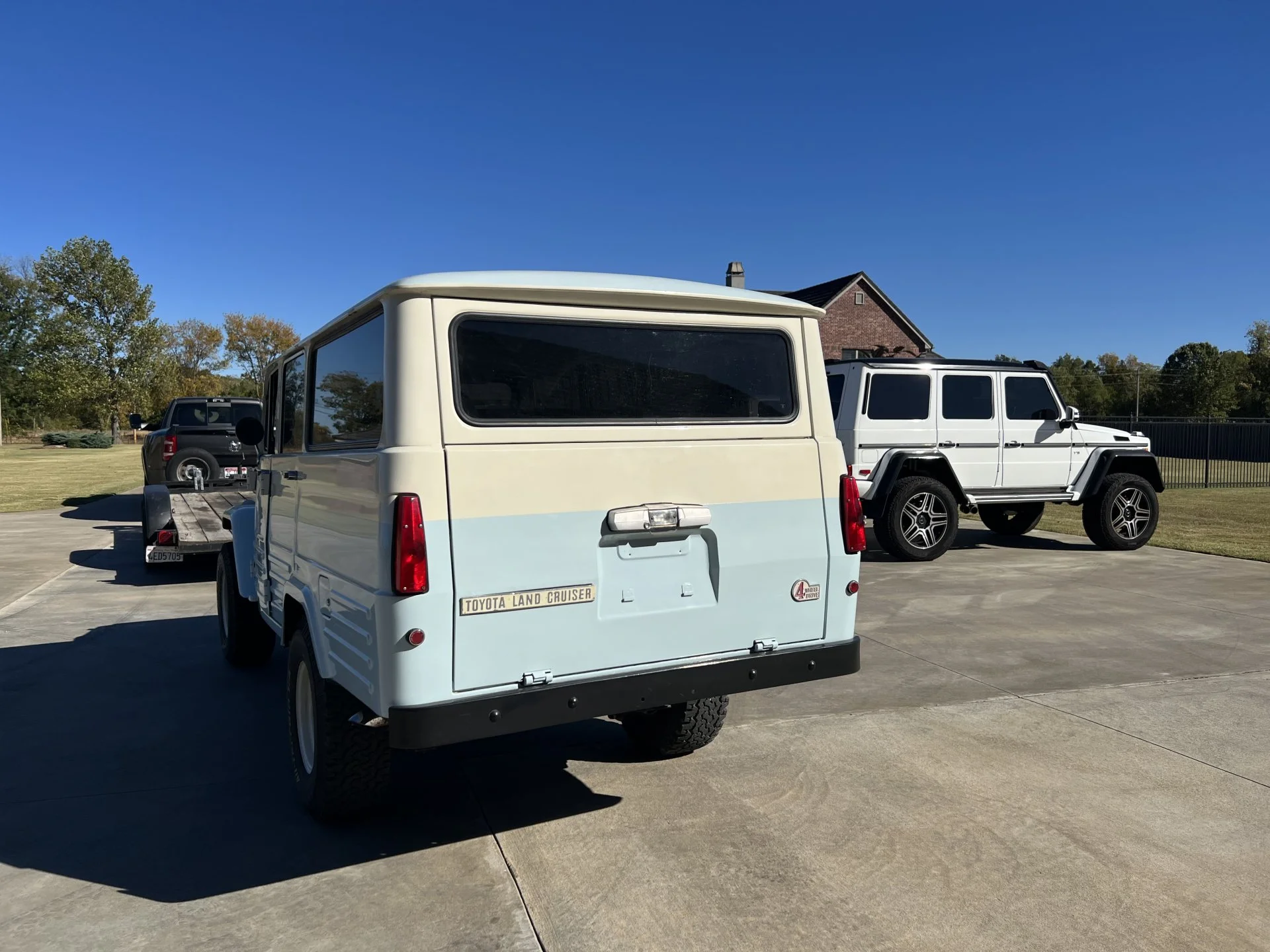

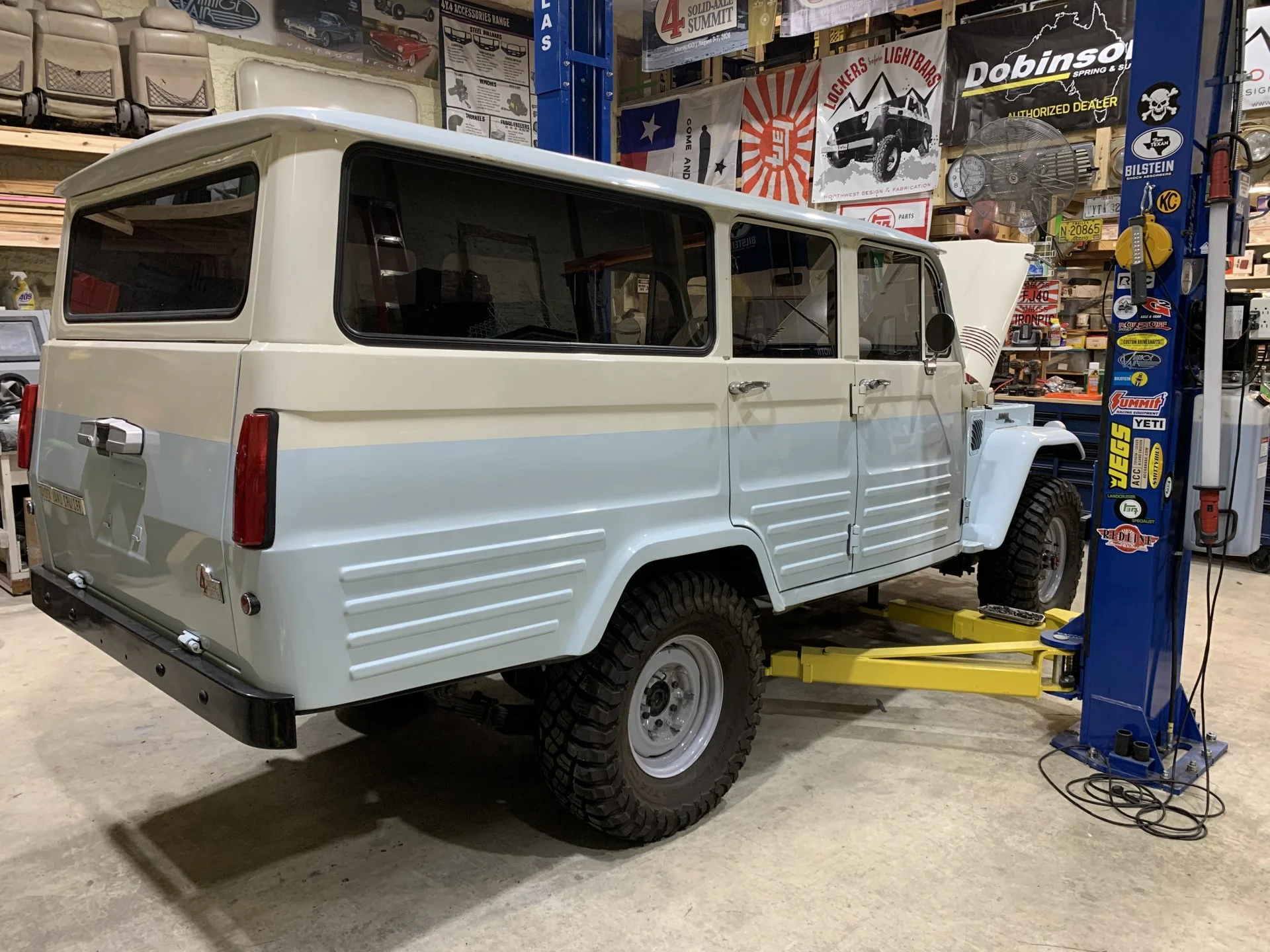

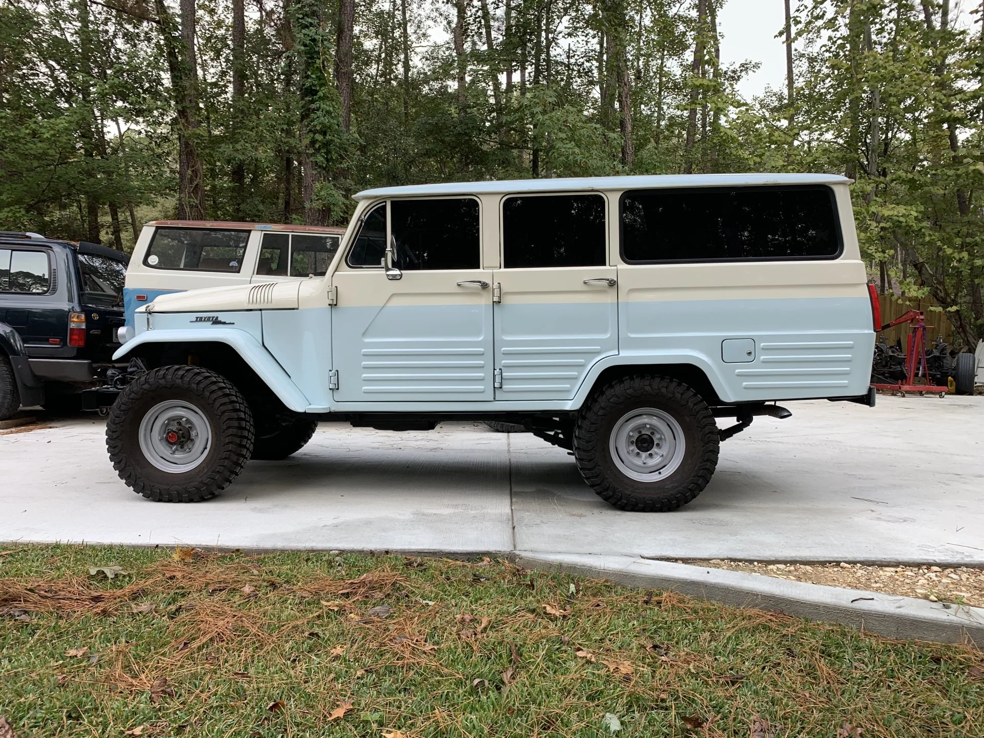

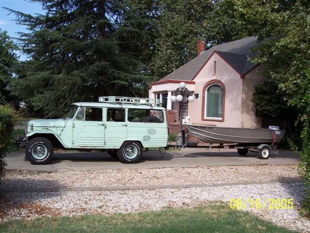

WOW i want it back , I sold it because as a 4x4 you would not want to wheel it hard ,The rear fenders would have gotten THRASH , was great in the Dunes , Great to see it get finished to Museum quality . Enjoy

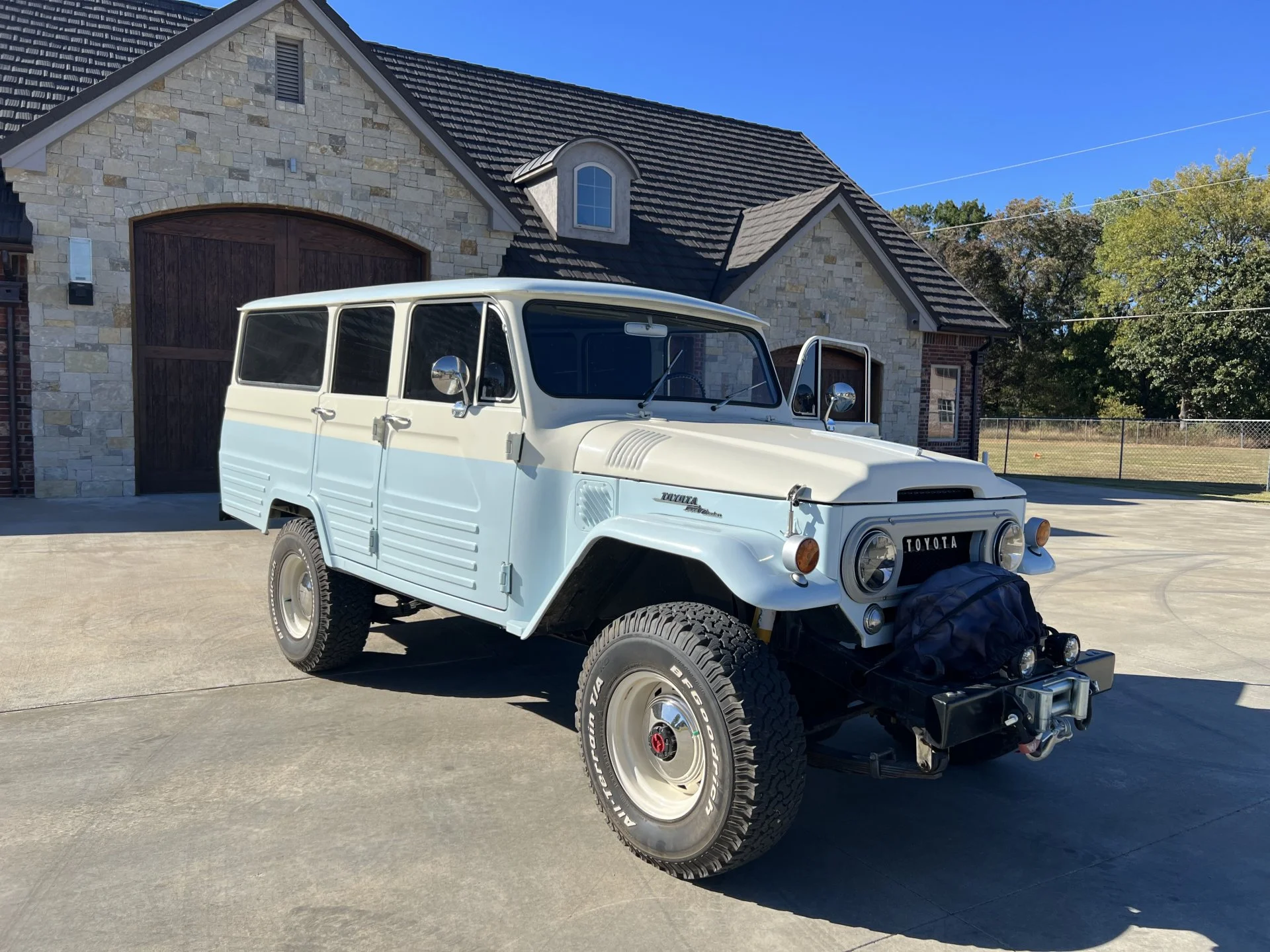

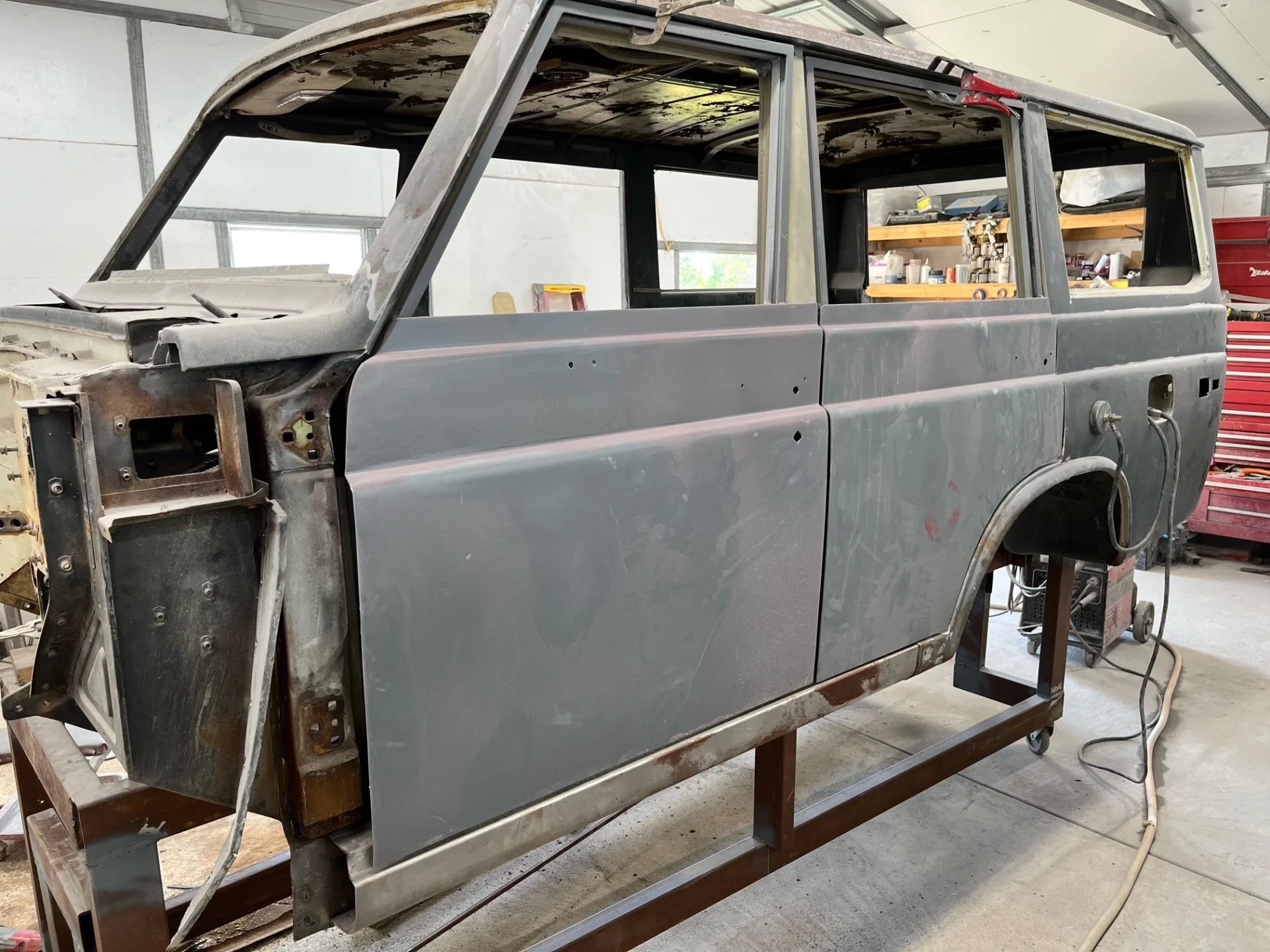

I have a 1974 FJ55 that is armored and SOA on built 60 axles that I can thrash. (Old bumpers in pic.). It’s currently being painted because the rattle can job from 2012 was getting thin.
This LV (I have 2) is getting no (additional) lift. I’m not throwing ARBs in the pumpkins or regearing it. It’s a road truck. I’ll probably take it on light trails though. Gonna do a bit of fishing, I hope.

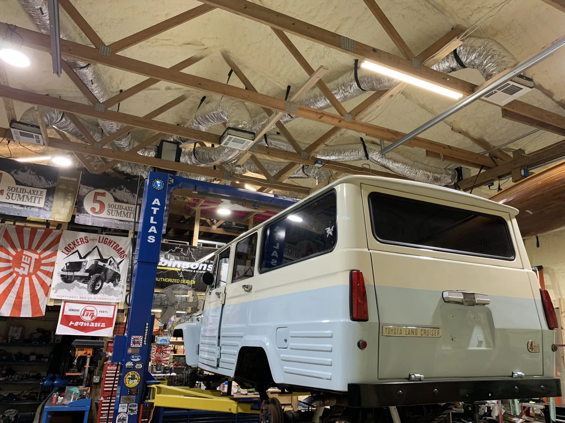

I love it , But please fix the wipers arms o_O
o_Oo_Oo_Oo_O
What NOSAJ said x four!
Looks awesome ! The V8 motor mounts on that 45lv are one of a kind , Icon 4x4 , I found on e-bay years ago .
Smoked windows look good
