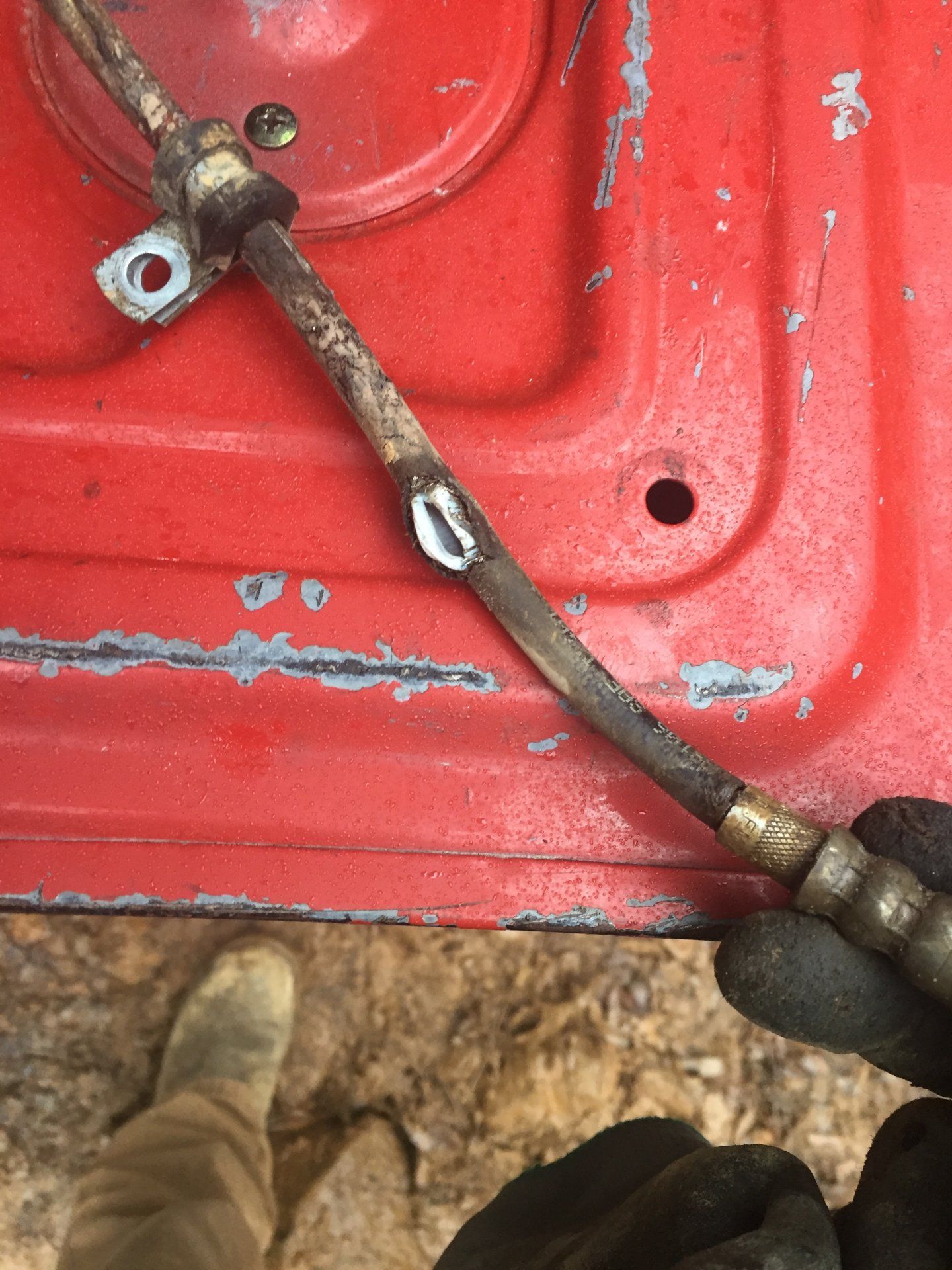

We did a nice hard blue trail, an hour in my clutch hose melted (replaced with the rear brake hard line), and almost at the end of the trail I accidentally left my front line lock on while trying to climb a ledge in 1st gear/double low which resulted in breaking my front carrier. Not the end of the world, but we still had two more days of wheeling ahead of us that I didn't want to miss out on, we got back to camp to pack up and head 2 hours to Coalmont, and amazingly I was able to find a complete 4.11 third member 15 minutes away in town, keep in mind it was about 4:30pm at this point on New Years Eve. I got the place to stay open just past 5pm for me, swapped the third out in the Windrock campsite, transfered my locker over which wasn't hurt besides two broken pins, and we headed out at about 8pm!

The clutch hose was just neglect and being an inch away from my exhaust manifold.

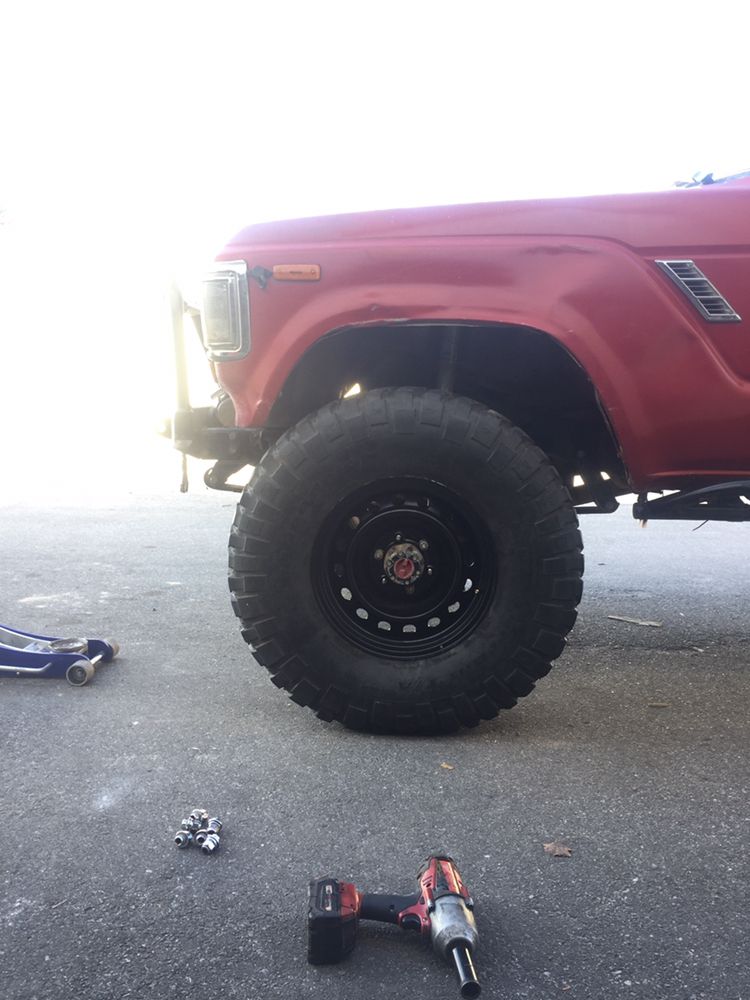

37 x 12.5 r 17 test fit.
Looks like the front axle needs to go back the other direction a bit to keep it out of the front of the inner fenders and core support.
I'm not really sure how but these seem to clear my front springs at full steering lock in either direction, when 35's on wheels that are dimensionally the same rub a little bit, not sure how that's possible but I'm going to roll with it.
