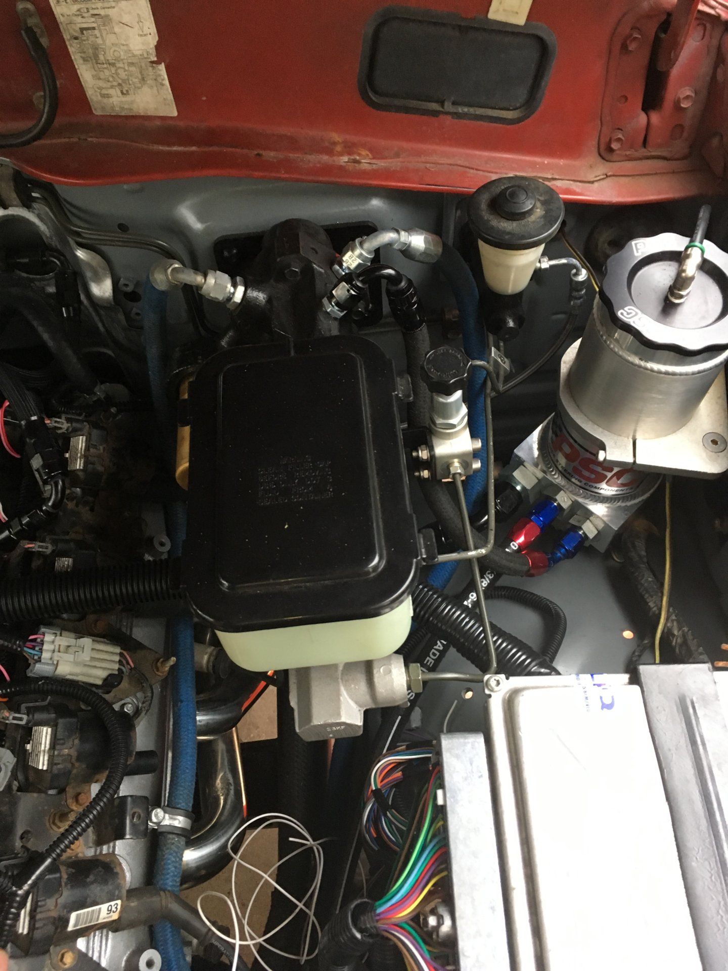

Well my third CBR pump came in today. Got it cheap on ebay out of a low-miles wrecked 2018 Duramax. Going to make some minor changes to hopefully make this one last longer then a single trail ride
Decided to move my reservoir to be directly above the steering pump, this should to prevent it from running dry which is what everyone thinks I had been doing with my previous location and the reason I have been burning pumps up.
Installed along with replacement pump and some lengthen and shortened hoses
New location. Can't really tell in the picture but the 10AN feed hose is a much more direct shot now
compared to where I originally put it. You can also see how dirty it's gotten since then. Now that it is out of this corner I am thinking about moving my ECU into that spot to clean up the wheel well on this side a bit.

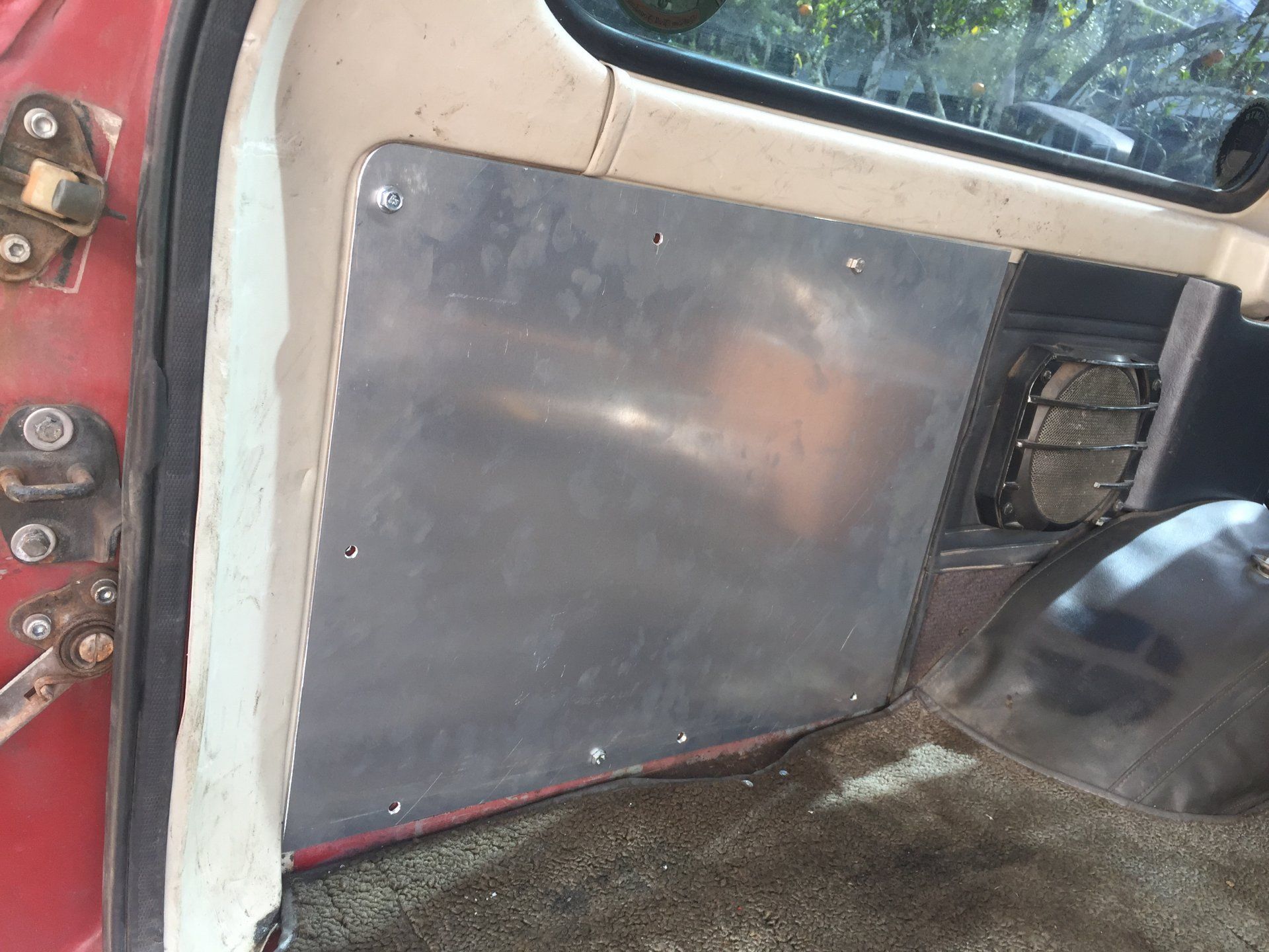

Amazingly I’m actually working on my own Cruiser this weekend instead of everyone else’s. First project this morning was a quick aluminum panel to replace my rear cargo panels that finally fell apart from abuse. I used riv-nuts in the original push-clip holes in the body after drilling them out a little bit. I also cut out the vertical brace to have more room inside. I also need another speaker grille if anyone has one to get rid of!

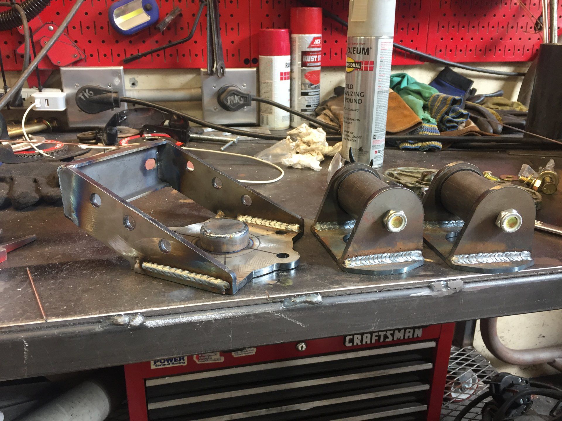

My other project was getting the 2nd crossmember fabbed and welded in.
I’m going to weld a fill port into the PTO cover since this mounting blocks the original fill port.
