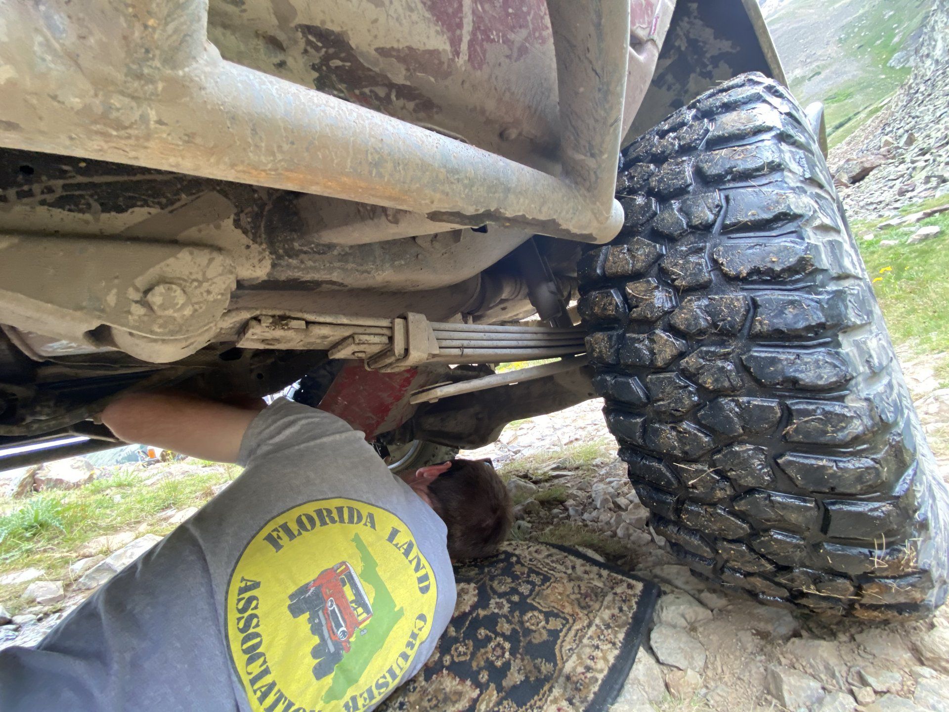

DUDE that was probably the most avoidable trail damage ever. :lol:
Not one of my finer moments. :lol:
