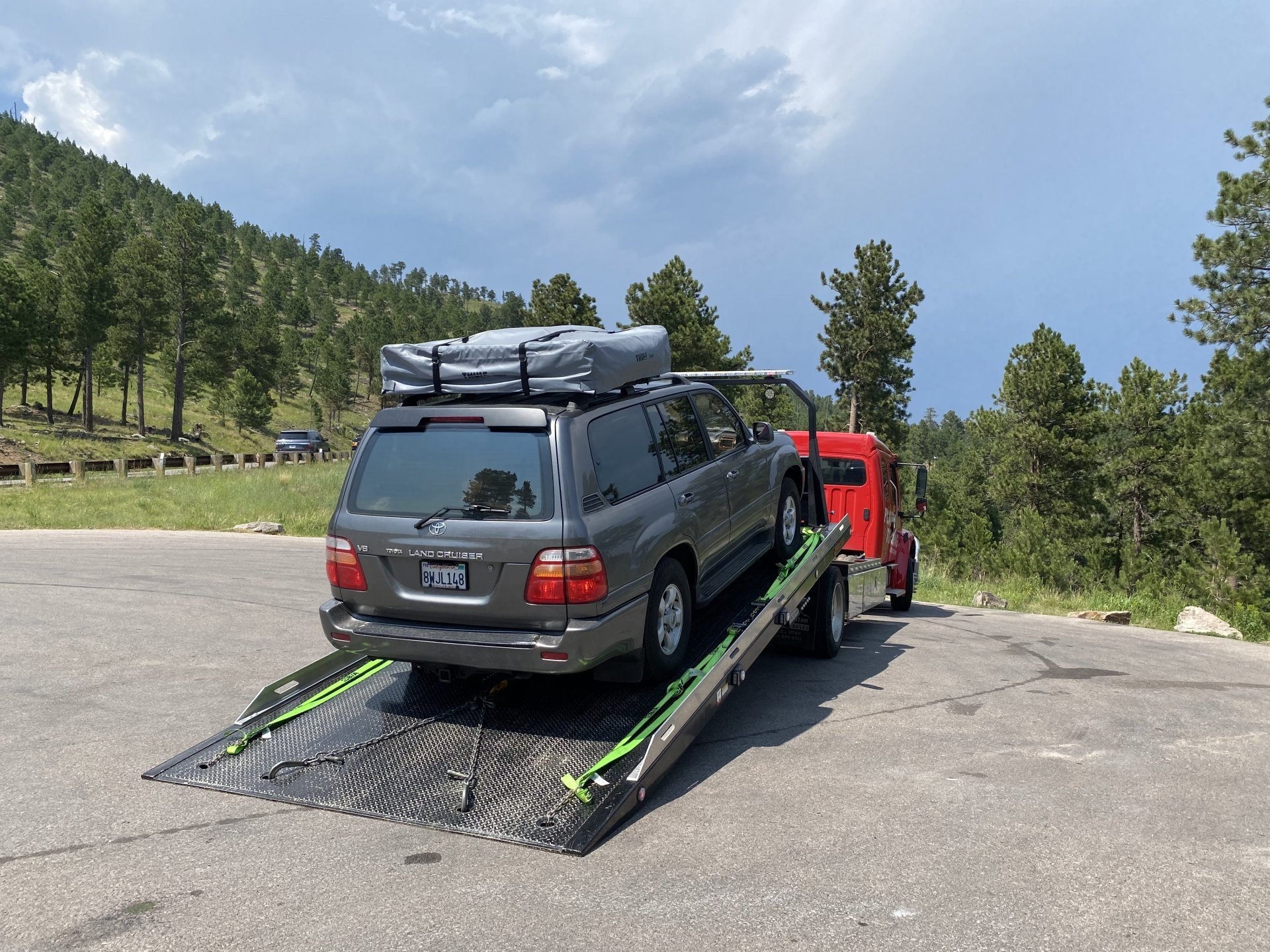

While going through a stretch of up-and-down switch-back turns in Custer State Park in South Dakota, I heard a noise from the motor and glanced down to my scan gauge FWT reading— 283! (For context, through Death Valley a week ago, I saw 206 max). The check engine light came on and I turned off the A/C and eventually the motor a few seconds later. At the turnout that was luckily there (with a great cell signal, fortunately), I popped the hood. The motor was steaming but no sign of coolant… also, plenty of coolant in the overflow tank.
I had some water in a portable camping shower tank we were carrying so I sprayed the motor to cool it down a bit (I was actually concerned about a fire at first). Then, I could see coolant flowing (as if being washed down) from below the vehicle.
We got a tow back to Rapid City to the Toyota dealer (thanks to USAA, but, oddly, the nearest contracted roll-back came from Sturgis — 2 hours away).

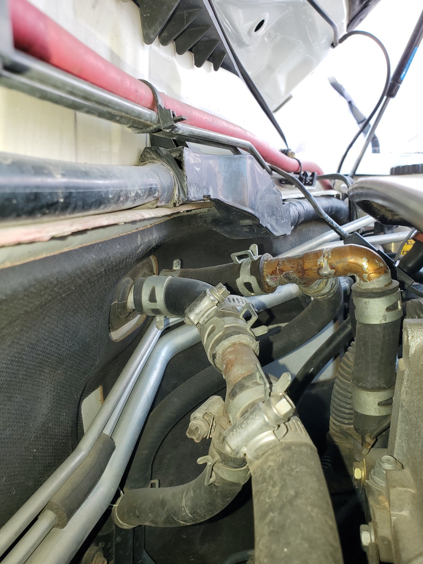

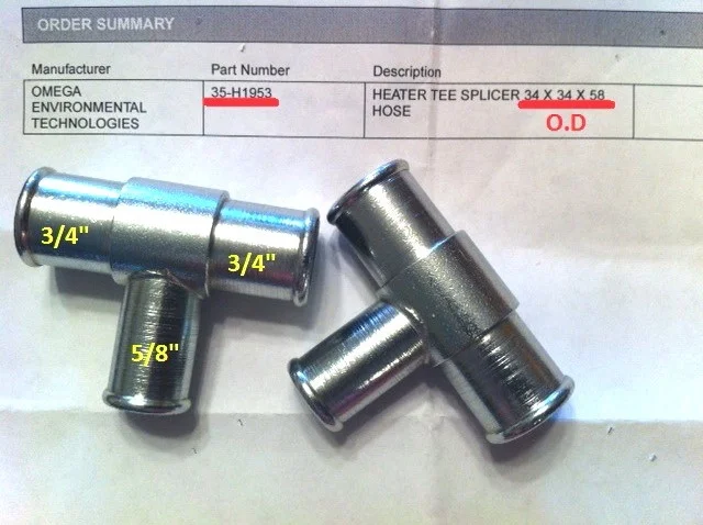

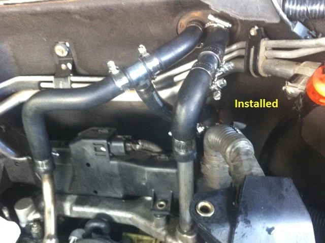

I was fortunate....while replacing my starter I just BARELY bumped the heater hose with the intake manifold and one of the heater Tee's snapped right in two. I replaced with metal Tee's. It is in fact a quite common issue if they've never been replaced. Glad you got back on the road.
A couple of 3/4" bolts and worm gear clamps (and maybe some teflon tape) and you can plug the hoses and be back on the road (no heater though). Or a section of longer hose and just connect the two pipes coming out of the engine block.

Had heater T crumble in my hand, with no compatible T available a quick fix was soldering copper fittings that was probably 10 years ago and no more crumbling plastic.

Good pic. I’d suppose the heater tees are the pesky heater hose of the 80s… but much easier to get access to.

yes, unfortunately, it's one of those potential issues that you can easily "see" from the outside. I think it really is a good idea to change to metal Tees before venturing too far out. So easy to do in your driveway. Worth taking the few minutes.
