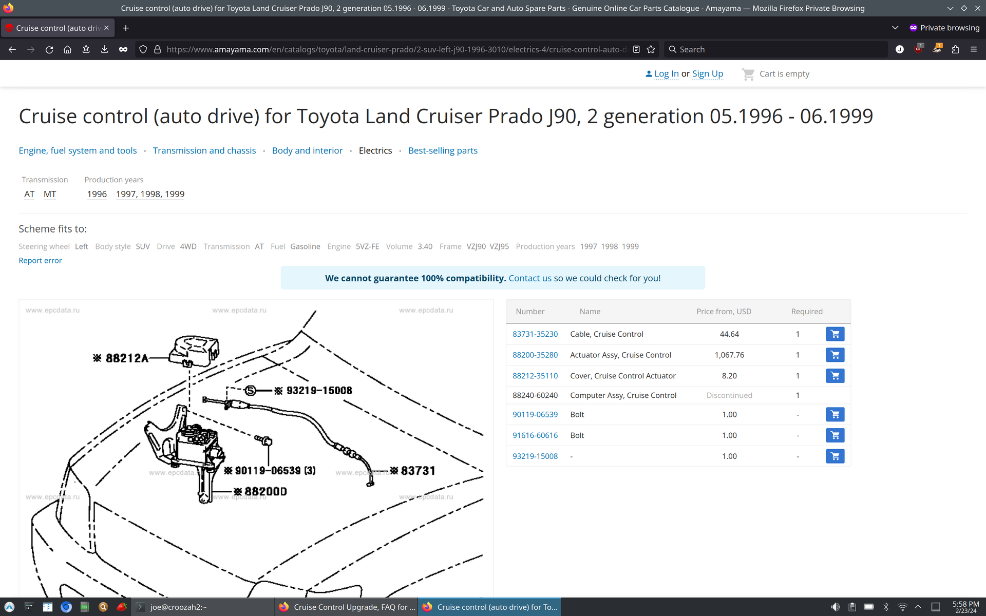

Perhaps aftermarket cruise control is an option, unless you can find all needed parts from a breaker outside of the US? See below, seems an important component is NLA:
