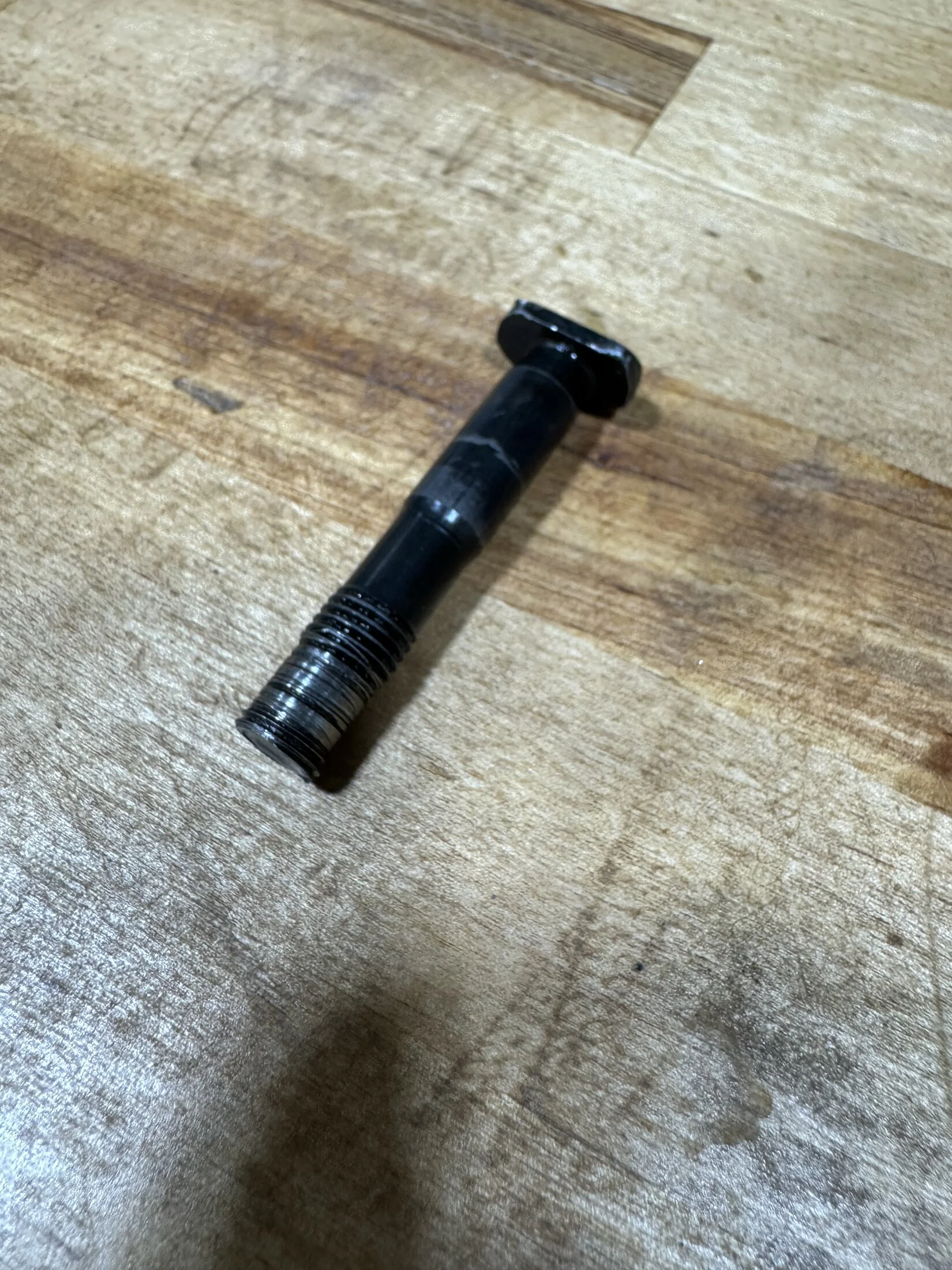

Just spitballing here, but hear me out... Patrick said that the cap on this bearing that is giving the trouble was difficult to remove. He pried it off with much effort, galled one rod bolt and the other is stuck hard in the rod. Could it be possible that he tapped one rod bolt up into the rod just a smidge and twisted it out of position just enough that the bolt head is not properly seated in its "cradle" (for lack of a better term)? If that's the case, the bolt is effectively shorter by a fraction and not equal in length to the other. Could that not cause one rod bolt to squeeze tighter than the other given an equal amount of torque on the nuts on the cap? Maybe? Possibly?
The factory 2F rod bolts don't have a typical hex head. They have a squarish (rectanglish) top that is ground on an angle. I'm wondering if the top is not seated properly, will that translate to a bad torque reading on the nut on the cap end? Pic for reference:
The fastener length isn't as important as the amount of torque you put on it. If he did pop the rod bolt up and then got it to torque, the rod cap is still bottoming out on the rod, and then allowing you to stretch the rod bolt enough to hit torque. Key point being, the rod cap sits against the rod and then you tighten them together so they can't fling apart. If there's a gap between the rod cap and rod at torque, then lol.
In short, no, not in my mind anyway. If you hit torque and it's seized, the bearing is too big, or something would be very obviously off in some other unknown and unexpected way such as mixing up the rod caps between rods.

I pulled it all apart again tonight and put it back together. I am at a point where it will spin freely as long as this bolt is not in. If i can find another rod bolt that will work im going to button it all up and give it a go.
Holy ****, how'd that bolt get so mangled?!
Hopefully it goes well.
He licked the stamp and sent it
Basically this . I picked up a used piston on eBay, pulled a stud out, put it in the freezer, was able to get it in the connecting rod and buttoned everything back up. It runs good, sounds a little deeper than before, but 🤞
