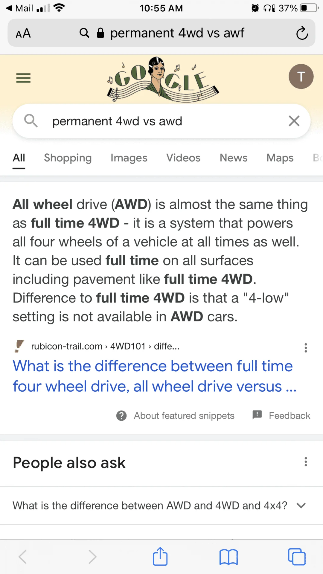

Since the days of land rover’s “permanent 4wd” marketing, I think it’s been commonly accepted that the difference between an awd and permanent 4wd vehicle is the option to engage a low range.
for instance: my old Mercedes ml320 had a low range but didn’t have the ability to lock its center differential...all the same it was considered a permanent 4wd vehicle, not an awd vehicle.
an Audi has a torsen limited slip center differential that is similar to our torsen limited slip center differential...it is capable of locking (or at least mostly locking, like ours is), yet is not considered a 4wd vehicle. It is considered an awd vehicle even though it’s ability to lock up its center diff is comparable to ours...it doesn’t have low range so it’s considered awd.
low range distinguishes a vehicle as being 4wd rather than awd, not the ability to lock a center differential.

30 seconds into the video he lists “part time 4wd, full time 4wd, and awd.”
our vehicles are full time 4wd. The difference between awd and permanent or full time 4wd system is not the ability to lock the driveshafts, it’s the ability to engage a low range.
as said before, an Audi has the ability to use its torsen center diff just like we can...but it’s an awd because it has no low range...it is not a permanent 4wd/full time 4wd even though it can essentially lock its drive shafts.
also, the original Mercedes ml classes were able to engage a low range but were NOT able to lock their driveshafts together. They were permanent/full time 4wd due to this low range ability. They were not awd even though they couldn’t lock their drive shafts together. Even later discovery 2’s had this ability to engage low range but no ability to lock their center diffs...they were still considered permanent or full time 4wd’s.

Hah, let's start back at square one. It's the semantics. And we're not going to fix it here, because the industry is inconsistent in how it uses the terminology.

Asinine auto industry terminology and acronyms aside, a full-time 4WD vehicle is one that nominally operates in AWD, but which has the ability to lock its center diff, and enter 4WD.
AWD nominally sends all power to the wheel with the least traction.
4WD matches the speeds of the front and rear axles.
AWD doesn't sound terribly helpful, does it? It's not, which is why we get a torque sensing center diff that features some ability to apportion torque.
Like on-road stability and traction control systems, AWD is mostly a safety aid. Without fancy center diffs, it can't help your vehicle find traction. Even with fancy center diffs like ours, its ability to foster forward progress is limited. In contrast, with 4WD (before we get to diff locks and fancy electronic traction aids) the wheel with the least traction can only spin as fast as whichever wheel on on the opposite axle has the least traction. This adds capability, not safety.
