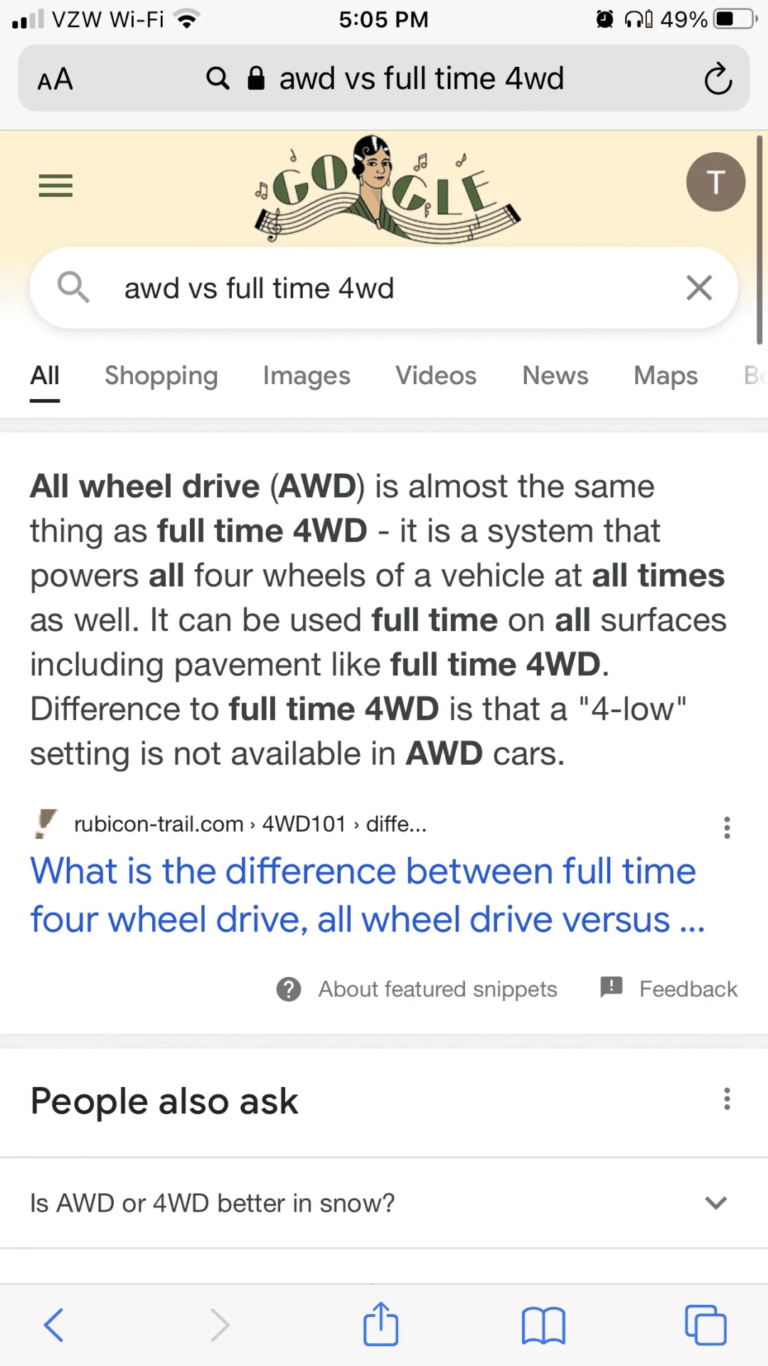

Automakers are free to put whatever badges they want on cars. I could slap v8, 4wd, and turbo badges on a Prius, but it wouldn't change what's under that vehicles hood.
The accepted technical definitions of 4wd, awd, full time, etc, are as teckiss and I have explained them here.
I'd encourage you to find better sources of information than random google results in the future.

As I said, trying to definitize semantics here is futile as the industry doesn't use standard terminology. Oftentimes, it's not even mechanical differentiation so much as it is application intent. Or worse, marketing. While I understand what you're saying in regards to low range - that isn't necessarily even the discriminator as lots of 4WD trucks don't even have low range anymore. Then throw in crap labels such as Auto 4WD, and does that a manly pickup have lame AWD?
Yes. A good example of this is the Cadillac Escalade. Even though, bodily, it’s comparable to a Tahoe, because they got rid of the low range on the Escalade, it is now marketed as awd...while the Tahoe, with its low range, is marketed as 4wd.
The s***tyness of Disco IIs isn't relevant to this discussion.
For everyone insisting their 200 series operates nominally in 4wd: you couldn't safely drive it on pavement if it was.

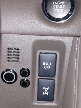

Actually really easy to retrofit a 2010-2019 GX 460 with CC and MTS. I added both to my 2012 three years ago.
"Crawl Control and Multi-Terrain Select (MTS) retrofit on '10-'19 GX 460 / all trims"
I am not a hard core off roader but I am a fan of CC. I have used several times in my LX and had it in my 5th Gen 4Runner. One of the reasons I skipped over the GX was because finding one with CC is like finding a Unicorn.
This is good to know. My wife is interested in a gx...it’s nice to know I can retrofit whichever she buys with crawl control.
In a similar vein, anyone know if the ability to add “multi terrain select” to a 200 without the feature is possible?
This may be a thread to follow... a retrofit attempt on '10 LX
If one is ok with a less than OEM appearance you can even add crawl for less than $20 to a 10-19 460 with just some wire, buttons and a ZPC.
Maybe a dumb question, but what is the best procedure to get out of crawl control? My first reaction is to apply the brake, but CC doesn't disengage but fights to keep going and it's quite a commotion. I then disable with the button but that seems less than ideal. How do you all disable CC after use? Sorry if I missed it and this was already covered here.
I've done it the same way you do. But when I get on the brakes CC stops and I get a little message in that center display. Then hit the on/off button
I've never tried to stand on the brakes. I press the pedal and it fights back so I let off. I'll have to try that. I'll check the manual as well
