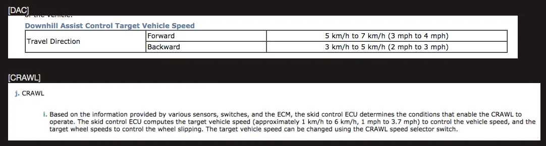

Speed 1 and 2 definitely are louder. The higher the speed setting, the less noise. I typically default speed 3 or higher unless I am really crawling. Note these speed are in km/h (1, 3, 5, 7, 9).
Crawl speed specs on a 460.. realize LC doesn't use DAC so look further below
