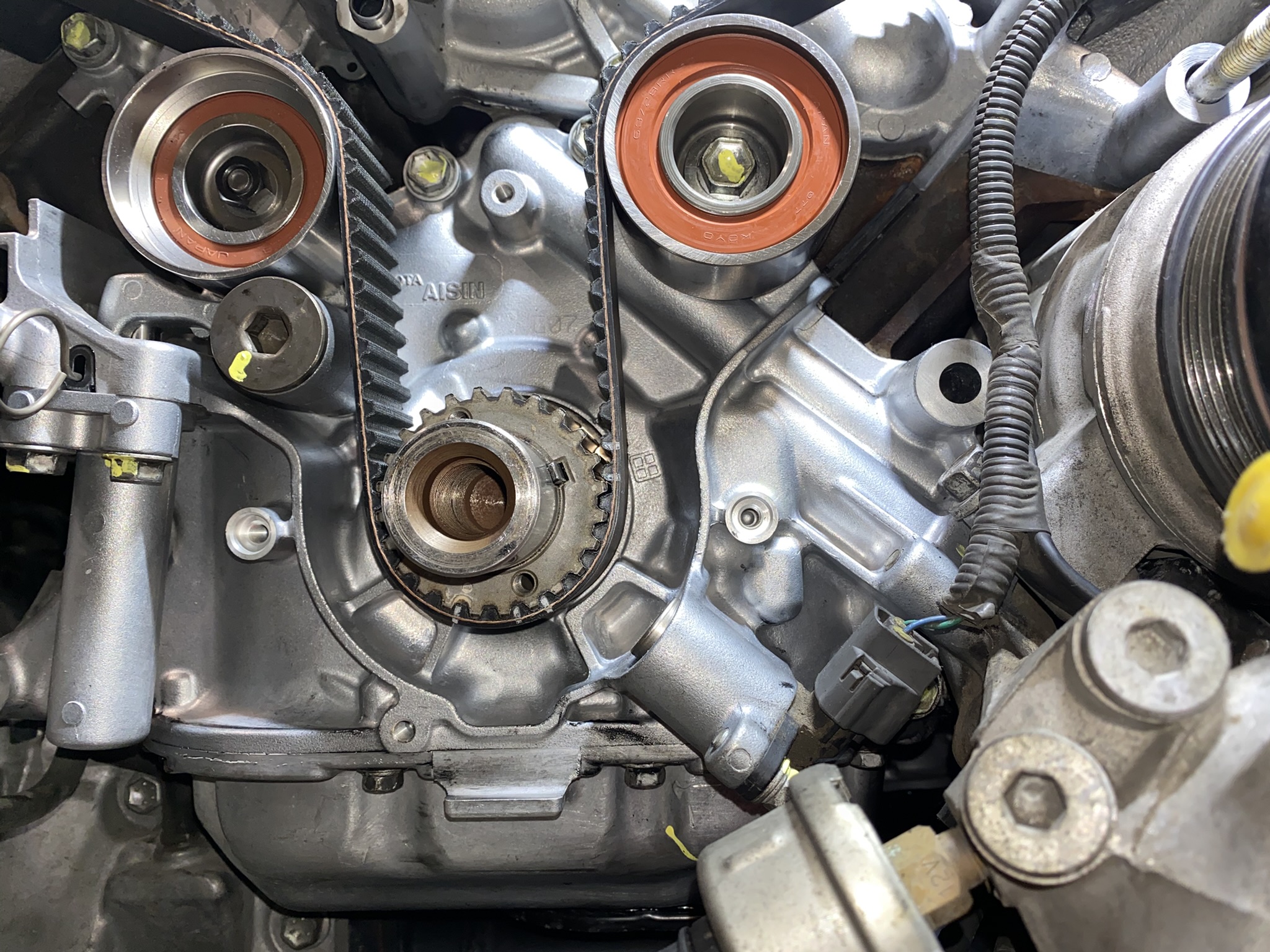

I don't know how it could be stuck in port (casting bracket that's part oil pump). Since it, has a great deal of space around the CPS in the bracket port.
Be very careful. Bracket CPS is in, is part is oil pump casting. If frozen in, consider pulling lower timing belt cover. Then clean out space around CPS, soaking in P-oil (ATF works well), possible just a little heat and tapping out (very gently). Sometimes the long road, is safest, cheapest and fastest.

Thanks for sending this image and input. The plastic flange (just below where the electrical pigtail connects in your photo) was so worn that it disintegrated when I removed the 10mm bolt that secures the CPS in place resulting in the majority of the CPS being stuck in port.

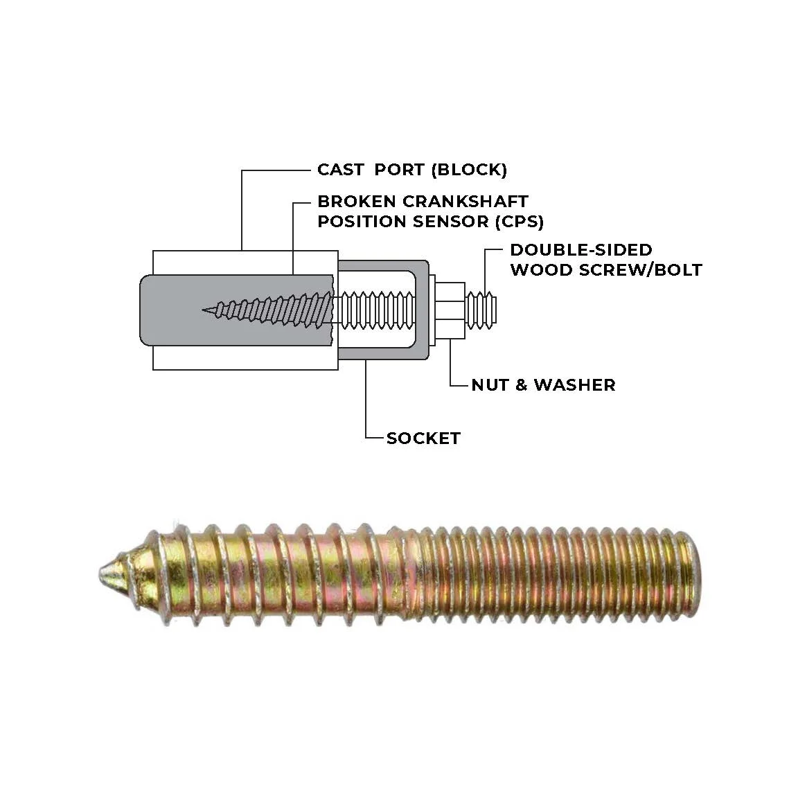

It's so tight in that area that I removed the oil filter, oil cooler and brackets to gain better access. Now I have room to work. Later today I plan on drilling a small pilot hole and inserting a small double-side wood screw/bolt. I'll then use an oversized socket (make-shift pulley puller) and back out the broken CPS.
...and if it doesn't work, I'm pulling the covers. Fingers crossed amigo!
Fixed. Thankfully, removing the oil cooler assembly gave me the access needed to drill a small pilot hole. After drilling the pilot hole I inserted a flat head pan srew and pulled out the broken CPS on the first try. I replaced the large O-ring and figure eight o-ring, did an oil change and replaced the coolant. Sure appreciate everyone's help.
