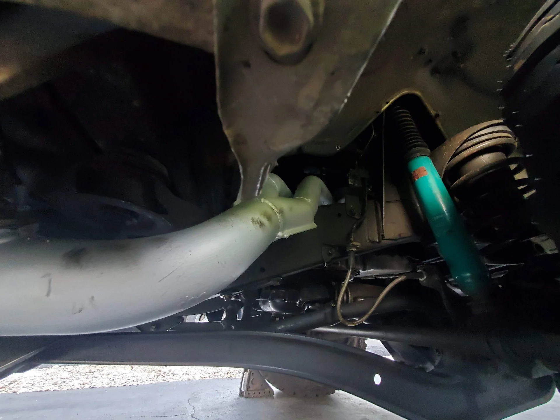

Hey guys, I had a blast seeing what my stock 80 could do (and couldn't do) on our run this past weekend. While I was pulling my running boards off yesterday I discovered why my exhaust sounded like there was a hole in it. Somehow I did this on the trail.
So I come to you guys first; how do I fix this?
Either get an exhaust shop to weld it up for a temporary fix or replace the Y pipe with a Magnaflow unit. What year is your 80? It'll bolt in to a 95-97 directly.

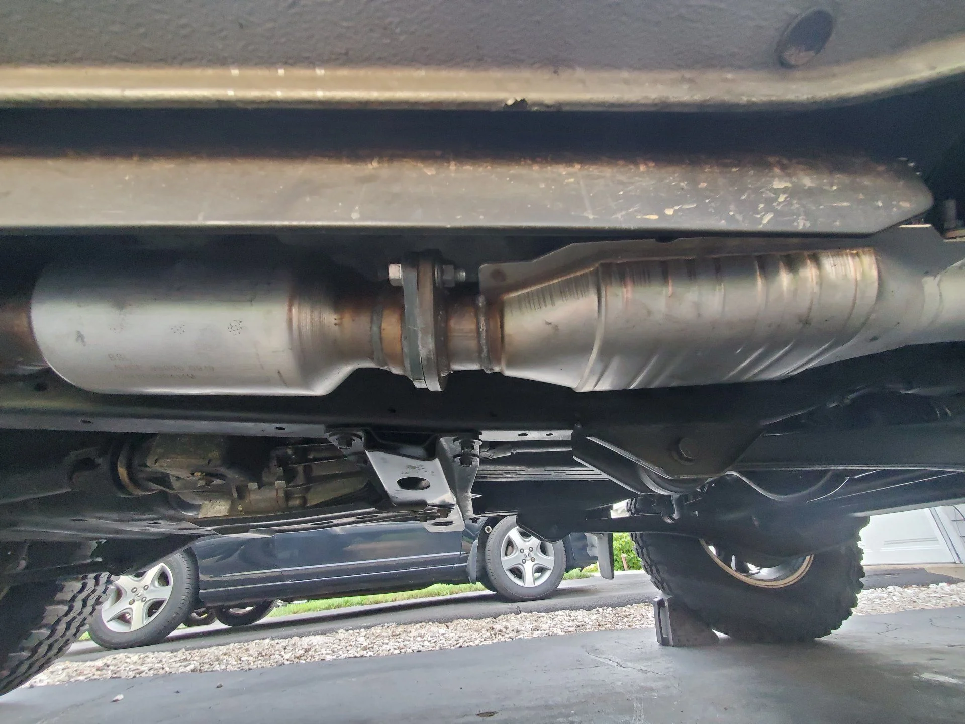

Here’s a couple pictures of the MagnaFlow Y pipe and catalytic converter I replace this past summer. Get a sawzall , a couple blades, and a can PB Blaster.
94s have the side by side cats so not a bolt on affair.
unless you take it all the way to the end of the tail pipe. and relocate the O2s to the PAIR ports on the exhaust manifold.
How did you hit it that it broke there? I’ve broken my old exhaust a couple times, but never on the y-pipe. It broke twice for me where it went under the frame before I rerouted it
I suspect that the pipe was fatigued before I hit the trail and the extra twisting did it in. and/or my engine shifted enough that the pipe hit the frame, which is another problem by itself. so to answer you, I have no real idea how it broke there.
