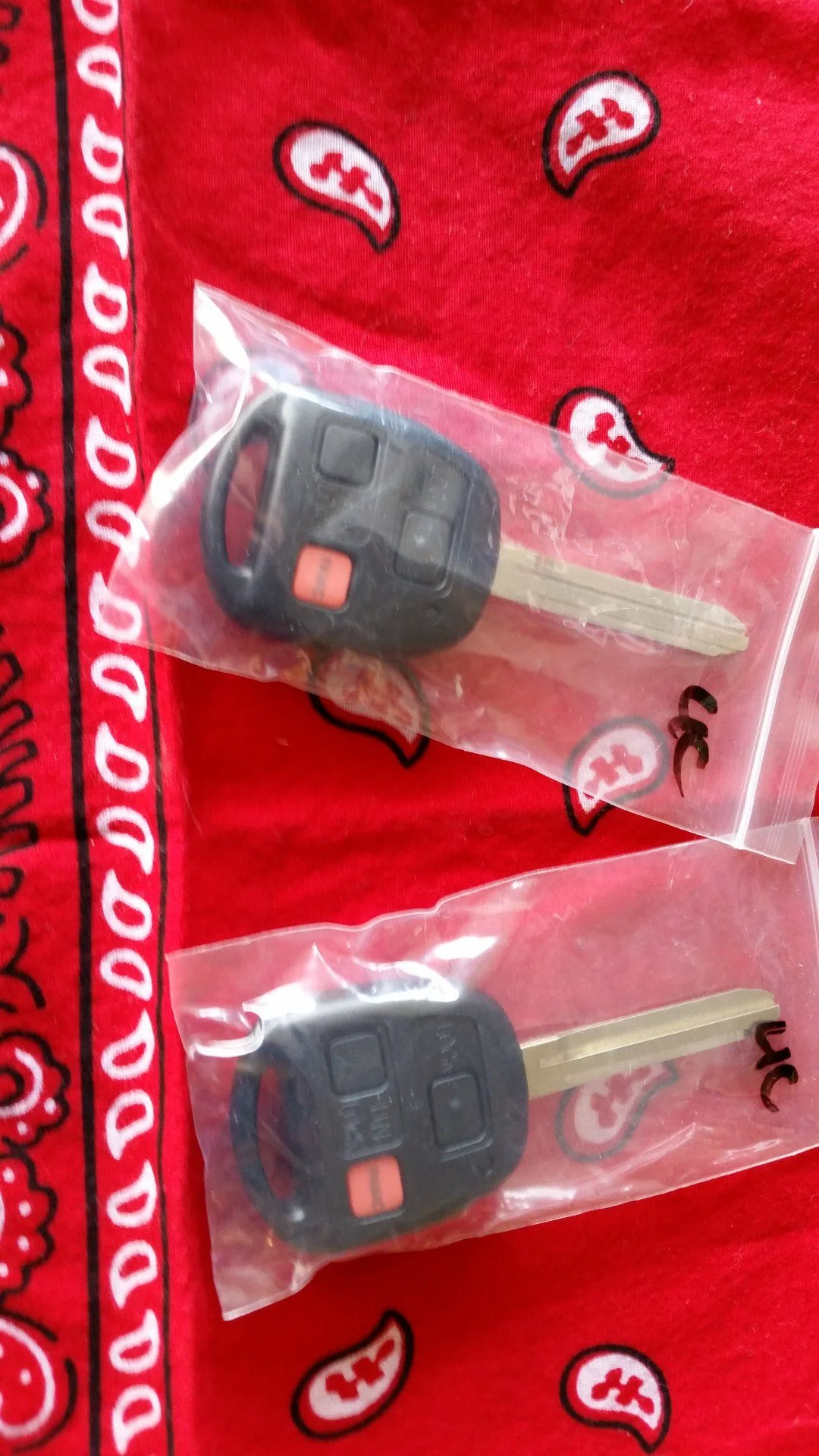

They showed up today
I didn't look to close but the quality seems good. I'll pop one open and compare the quality of the PCB when I get a chance.
2001 LC. I bought very similar ones off ebay and had no problems getting the immobilizer to work as well as the remote. Worked like a champ on the first try. I had the plain (non remote) black key that turned the security light off quickly. So, it appears a "master" plain key can definitely program a "master" remote key.

Keys programed and remotes programed, all seems well so far. I followed the FSM programing procedure but had to help the lock on the driver side door cycle. The motor was not performing complete cycles. Drove me nuts for a while then I noticed the lock not completely closing and opening. I'll cross post this in the other thread.
