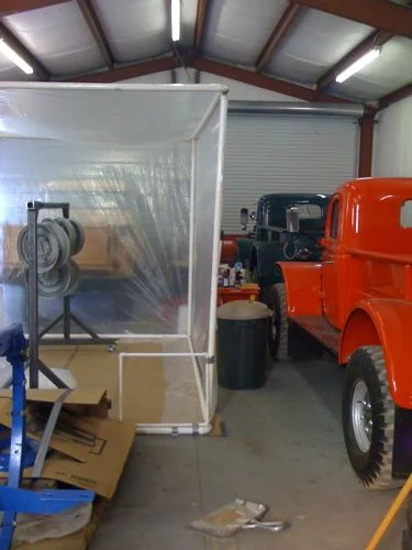

Guess what day tomorrow is? Paint day!
Also, how do you make a 60x30 foot shop crowded? Simple, park three Power Wagons, a disassembled White semi (the blue frame in the foreground) and a PVC paint booth in there.
The plow on the Green Dodge is actually setting up on blocks, because the door won't shut with it down on the floor. :)

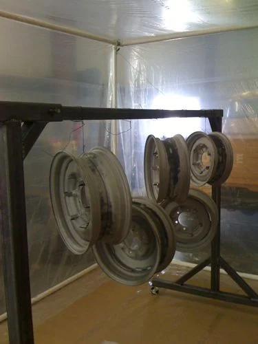

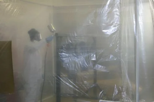

Ok, so today was paint day. Relatively warm here today (45 degrees), so the first order of the day was to get the shop nice and hot.
The PVC box, with plastic walls has two filters: one for incoming air, one for the exhaust. We built a duct out of cardboard boxes to duct the exhaust air out the rear door.
As you can see in the pic, the overspray inside the box was quickly pulled down and out the exhaust. Pretty amazing how fast the fumes and paint were drawn outside.
However, the wind today was blowing the wrong way (and gusting), so every time it gusted at the exhaust outside, I think it blew the paint back up the duct. Not into the paint box I built, but into the shop in general. It was super dry, so it's just dust. It was funny when I got out of the box (which had clear air) to notice that the air in the shop was misty.
The overspray blows right off with low pressure air. That's what getting blown back in from outside does to it!

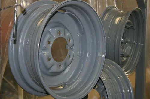

And at the end of the day.....
They came out really nicely. That's DP50LF with two coats of clear to seal it (and make it shiny). I did get a couple of runs in the clear, but nothing bad at all. After all: they're just wheels, and much of them will be behind hubcaps. Not too bad for my first time spraying clear, and the first time I've painted anything for 5 or 6 years I'd say!
They cured pretty quickly because once the shop had aired out we fired up the heaters again. I had the paint box at over 100 degrees with all those heaters going.
