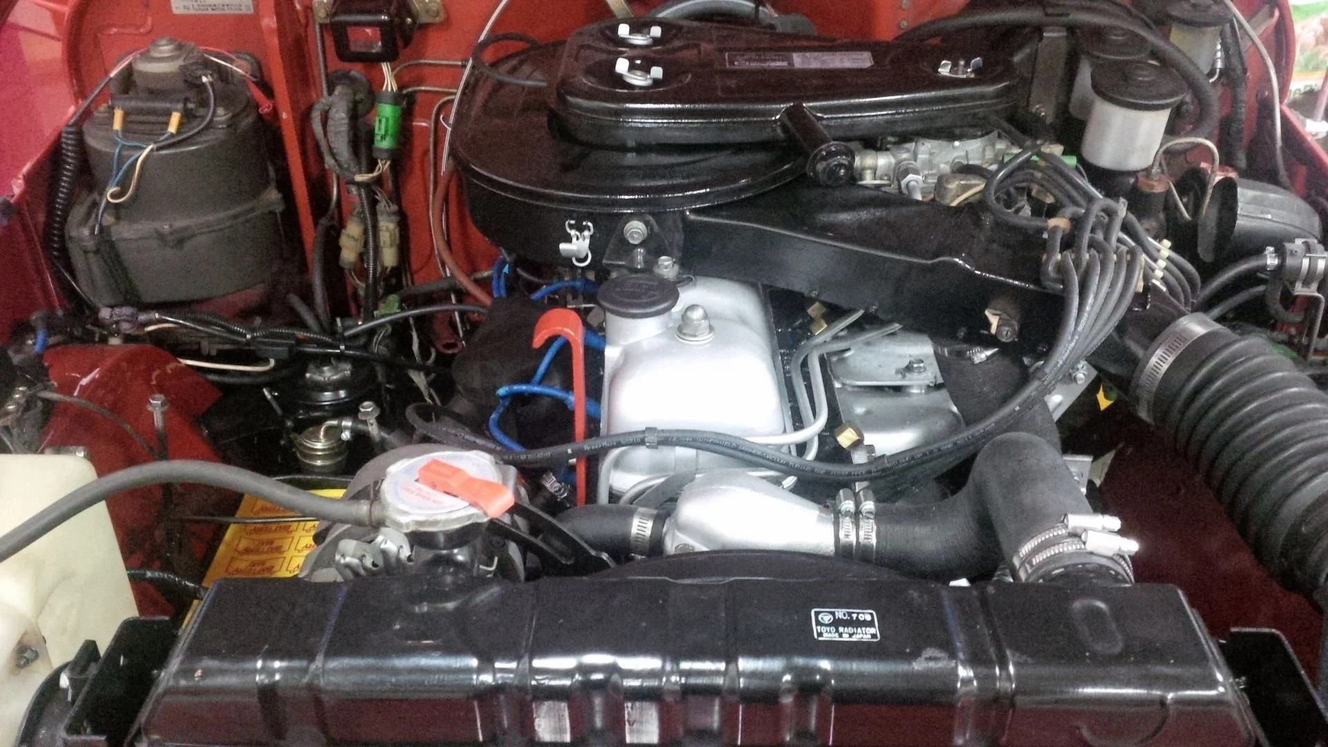

So my fuel filter is mounted in the upper hole for the bracket for the charcoal cannister of which there are three holes 1 up top and two down below. I am ready to put in the cannister and bracket I found for my rig that a PO removed!?!? Anyways after looking around I noticed a hole on the rearward side of the battery tray support that mounts on the frame below it. Is this where the fuel filter should be mounted? Can someone post up a pic of where on their '78 the fuel filter should be mounted? Below is a pic of where mine is mounted now.
Thanks in advance
Yes.
My fuel filter is attached on the charcoal canister bracket for easy access, the OEM location was difficult to get to hence why I relocated it.
Fuel filter located on right side of charcoal canister. Sorry I don't have a better pic.

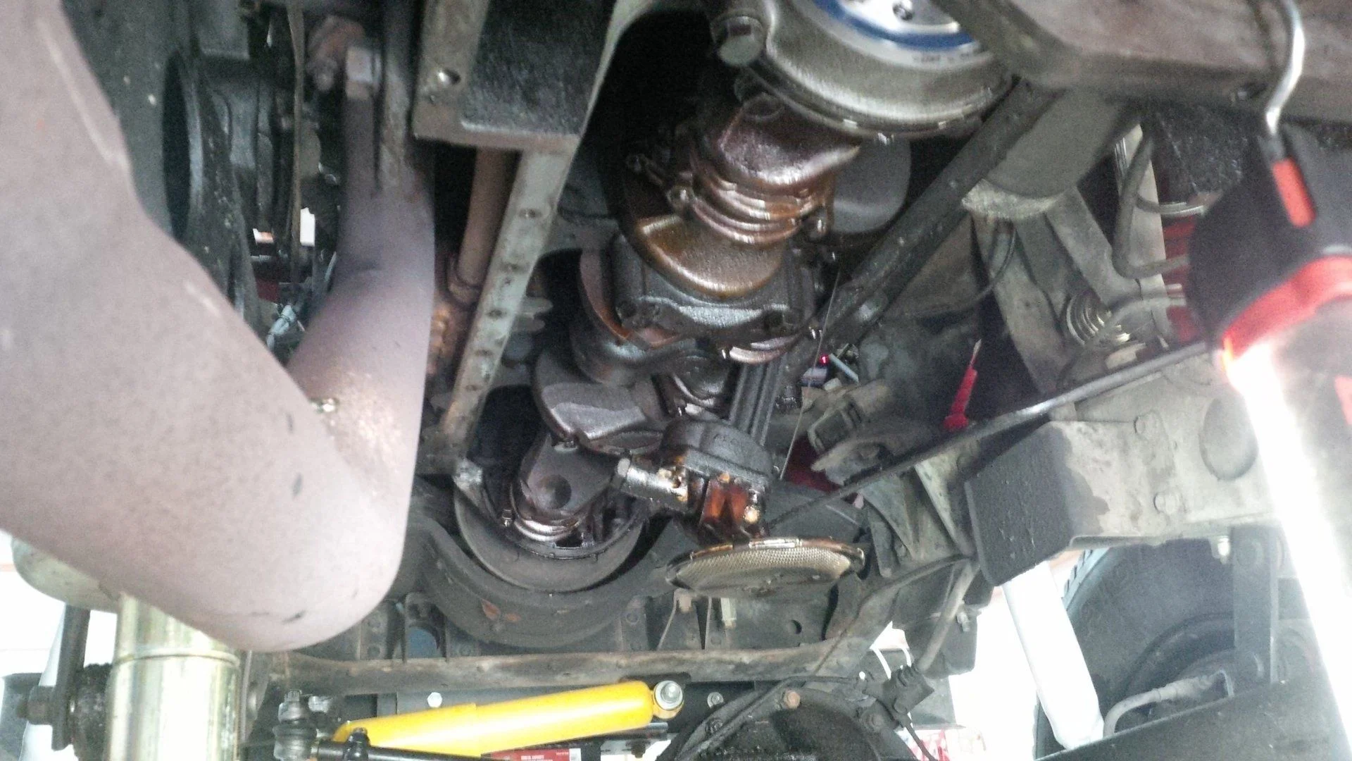

Here's another pic of the fuel filter location my goal was to have it placed where it was visible and very accessible. The OEM location was under the battery tray and was not very accessible nor visible.

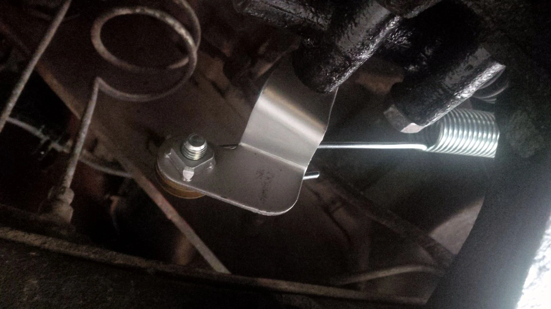

This is what the fuel filter bracket looks like. I re-purposed mine to hold the clutch fork spring.
