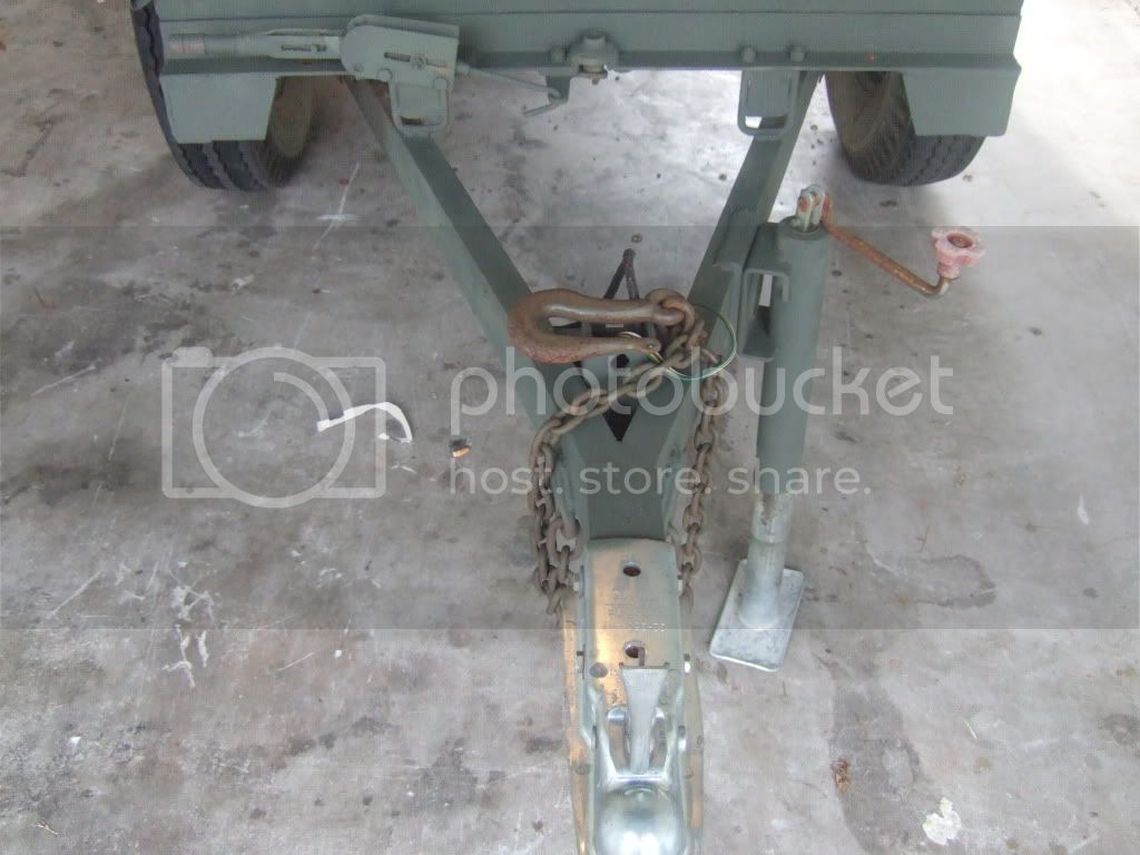

As you can see, the lunette had been removed and replaced with a ball hitch. I was told it was used for hauling at a military base in Colorado. They also jerry rigged some u-bolts to prop the tub up.
Closer look at the ball hitch.
Closer look at the u-bolts.

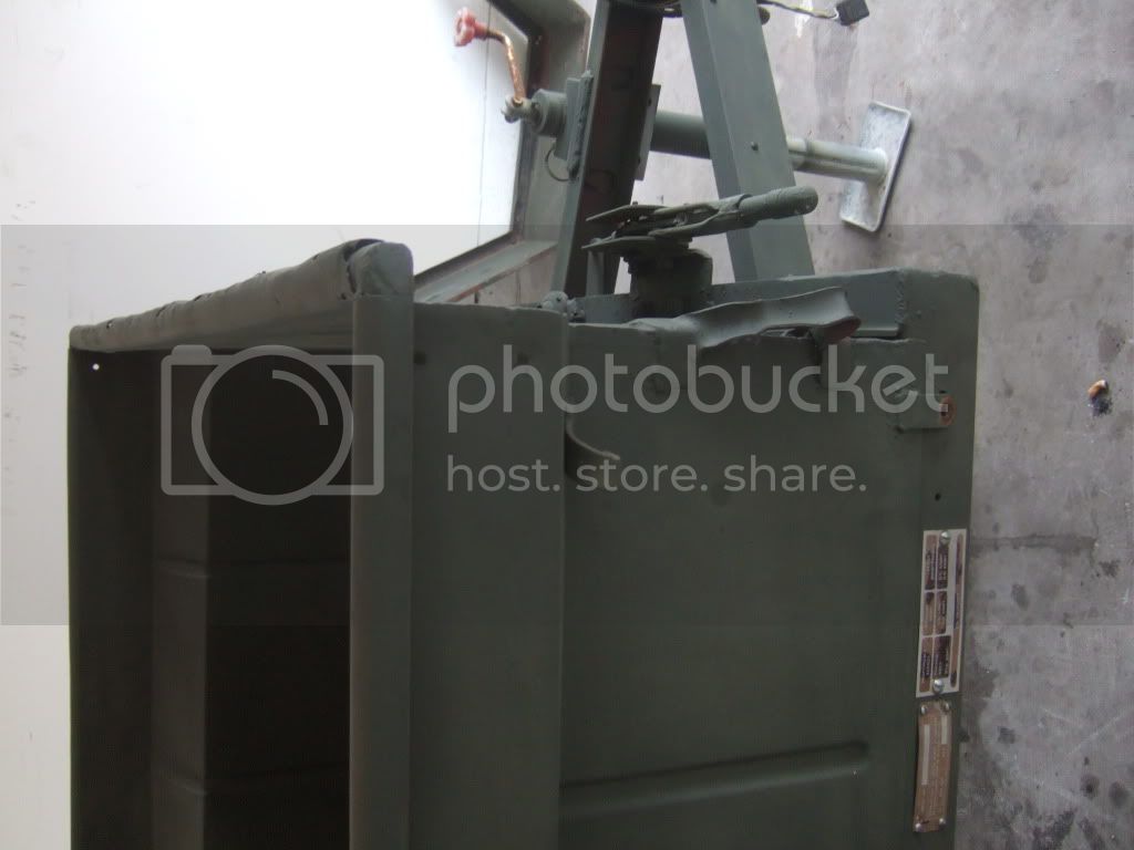

Overall, the trailer was in decent condition, but needed a lot of work. The floor had some rot and was wavy, there were holes drilled everywhere, and someone had cut a tailgate in, and then stick welded it back in. Booger welds to follow:
More pics of trailer in as bought condition.

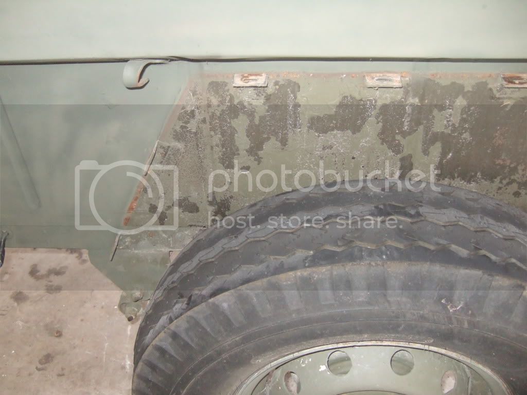

As you can see, no original military tires. Tires also badly rotted.
Here is a pic of the springs, and bottom in original condition.

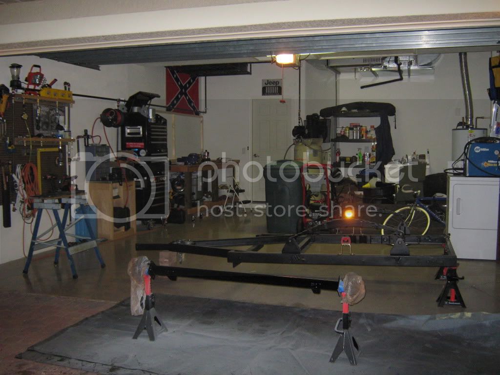

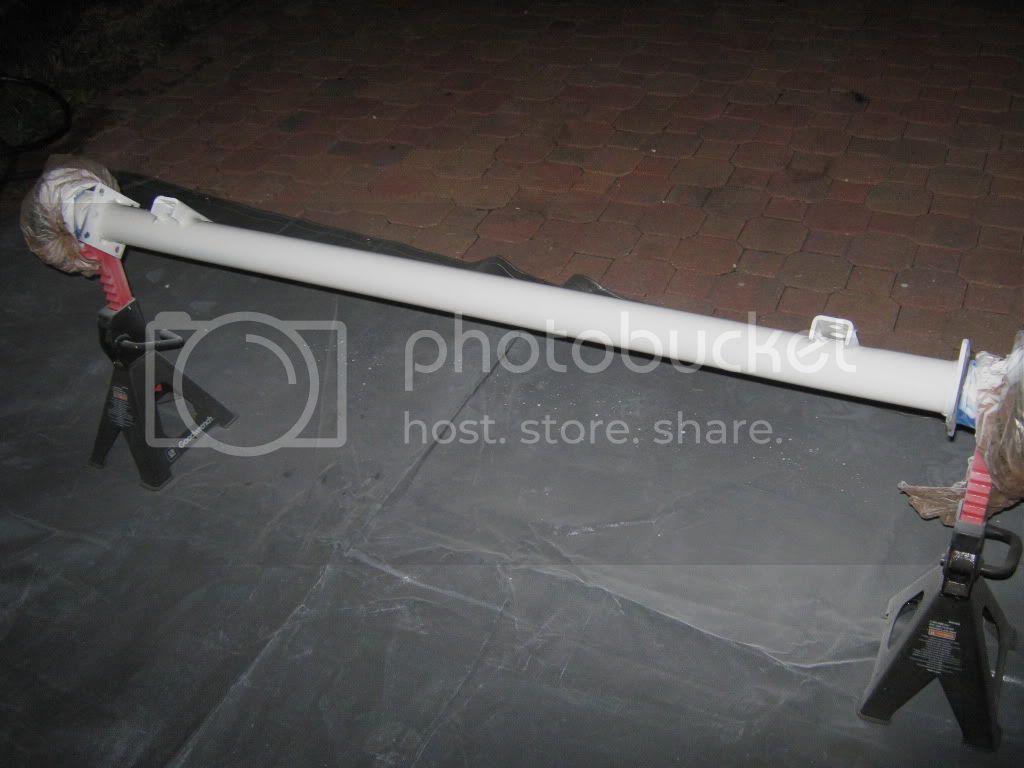

In any event, I stripped the trailer completely and took the frame to the sandblaster. Then covered it with a couple coats of rustoleum. Also installed new CJ springs, greaseable shackles, grade eight hardware, and extended bumpstops for the SOA I planned on doing.

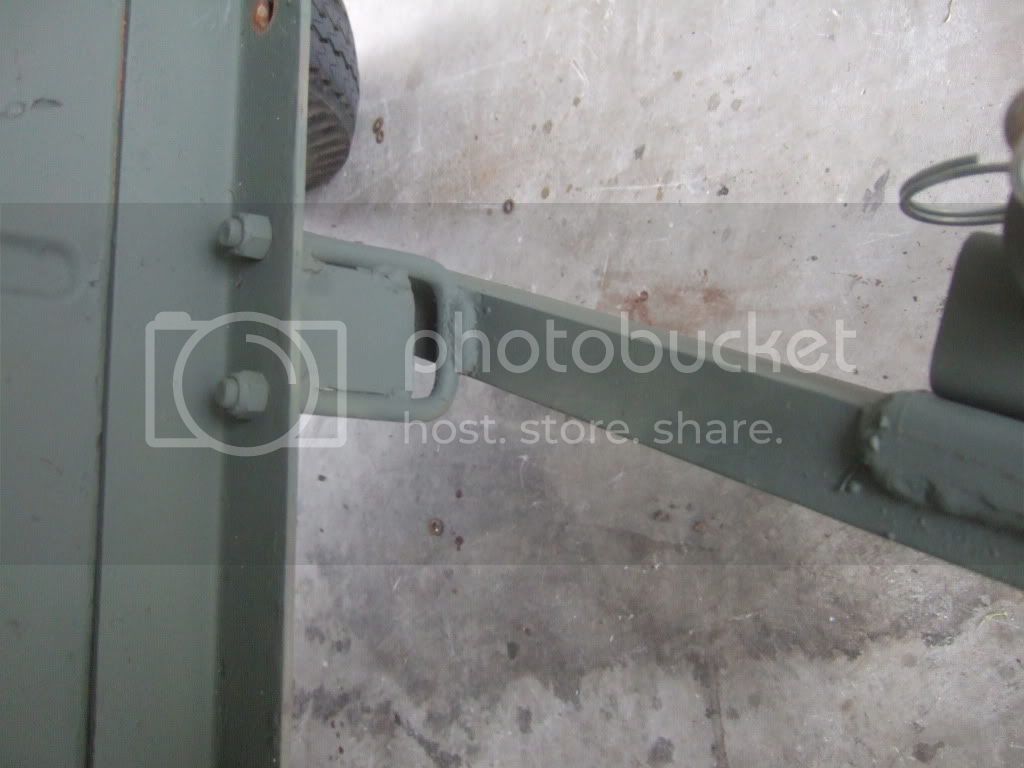

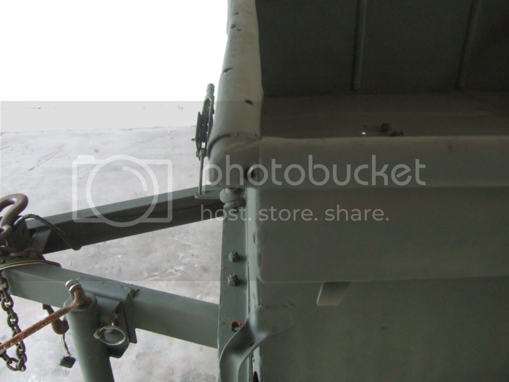

Also fabbed up a new extended tongue with a 2" ID receiver end so I can either use a lock and roll coupler offroad, or switch out to a simple ball hitch for highway driving. The extended tongue also gives me better handling and more storage space up front.
At this point, the project stopped for a while, as I got married, had a baby, and moved to a new house. However, things have started moving again, and having my own garage helps a lot.

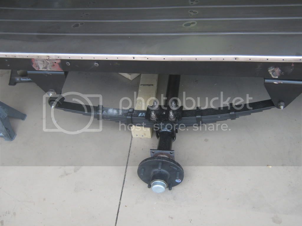

I decided to replace the standard axle with one from ABC trailer supply. I ordered a 3500 lb axle with a 57" wms. I got 5 on 5 and 1/2 idler hubs to fit my M/T Classic II 15 x 10 wheels with M/T Baja Claw Radials 35 x 12.5 x R15. I have two old tires that are currently sitting in the garage, but haven't ordered the Classic II wheels yet. Being able to run the same tires is good, as I can use my spare on the trailer, or can use tires off the trailer on the Jeep. I am considering adding electrical braked but this mod will be coming later.

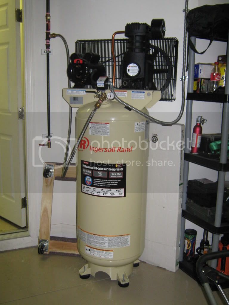

Digressing, having a bigger garage is great, especially with air and my miller:

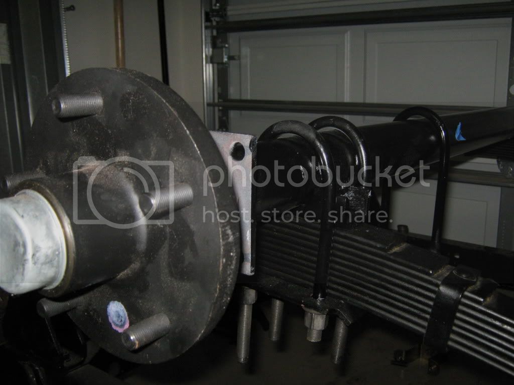

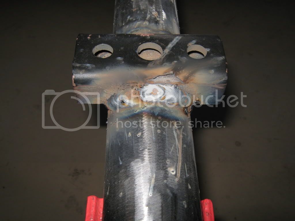

So after measuring and more measuring, and then some more, I burned on the spring perches to my new 3500 lb axle.
Actually had to redo the welds once to get better penetration.
Also had an issue with the SOA. The spring centering pin's head was too small, so I ordered some with oversized heads and took them to a local machinist, who cut them down to size.
Here is the axle getting primed and painted.

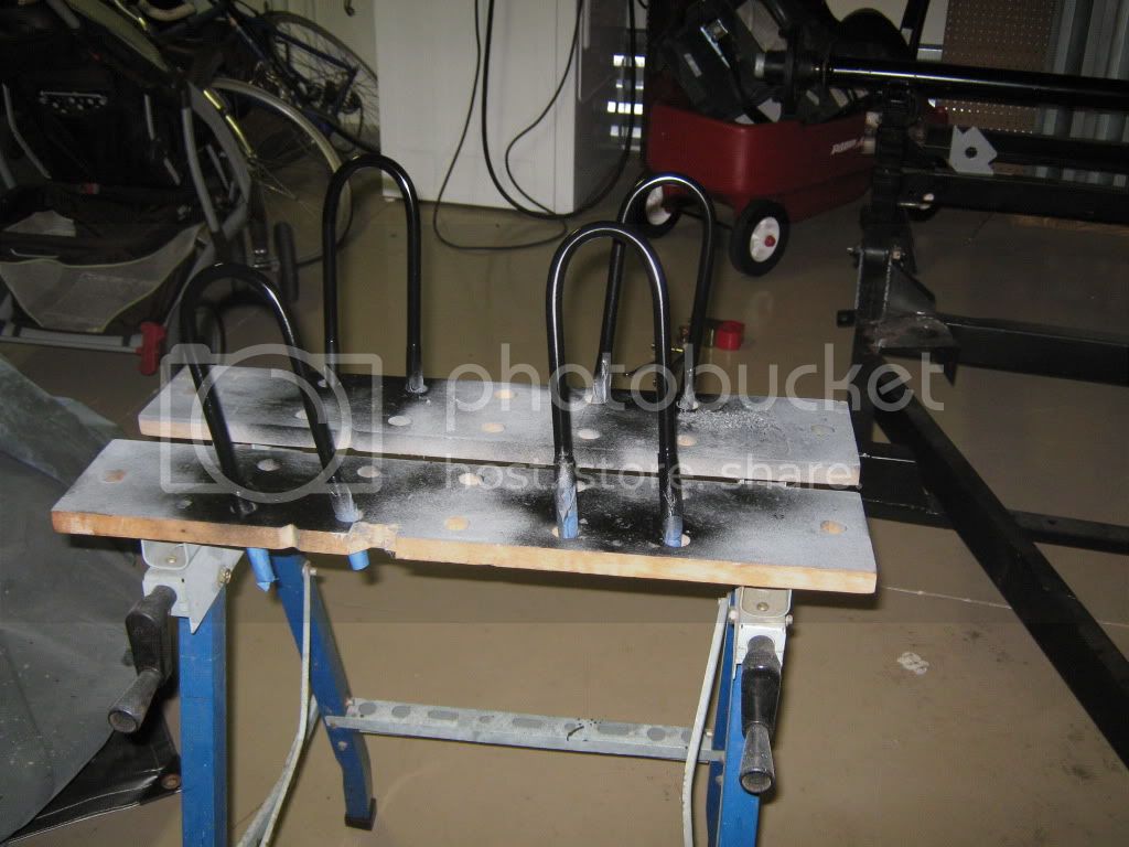

Next unanticipated problem was the length of the ubolts with the SOA. Had to get longer ones made. Then when I tried to put them on, they didnt fit right, so had to go back and get new ones bent again.

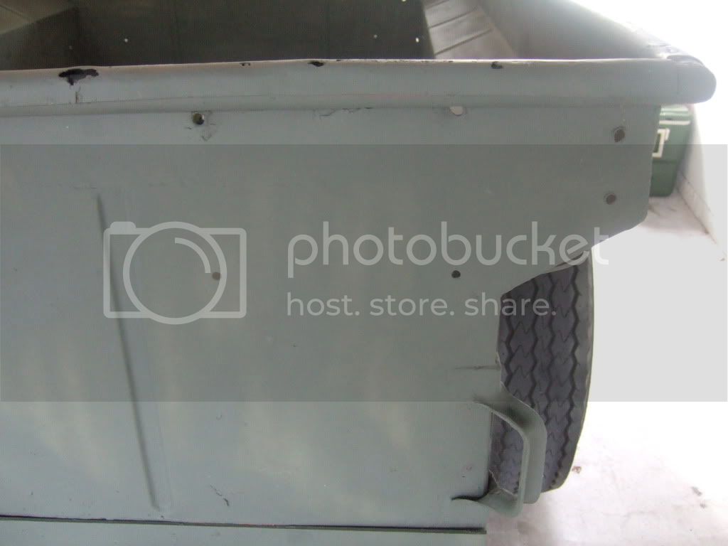

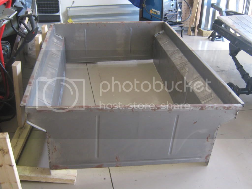

Then I debated for some time what to do about the tub. I cut the floor out as it was too warped, rusted and drilled through to salvage. Then, upon beginning to grind away at the old paint and rust, I found a good bit of bondo. It looked like the tub was going to be more work than it was worth to restore to the condition I wanted. Also, the round top of the 416 has always bothered me when putting on a lid, which I plan to do. I finally bit the bullet and ordered repro panels from Jeep Panels Plus. They also kept the dimensions of the 416 tub, but made bends at the top railing that are square, which is better for the lid. I highly recommend these guys.
Anyways, here is the tub progress photos:
Here she is tacked together. You can just make out my jerry rigged jig to hold the panels while welding them together.

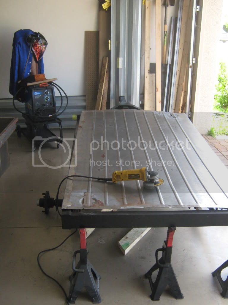

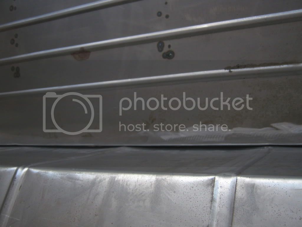

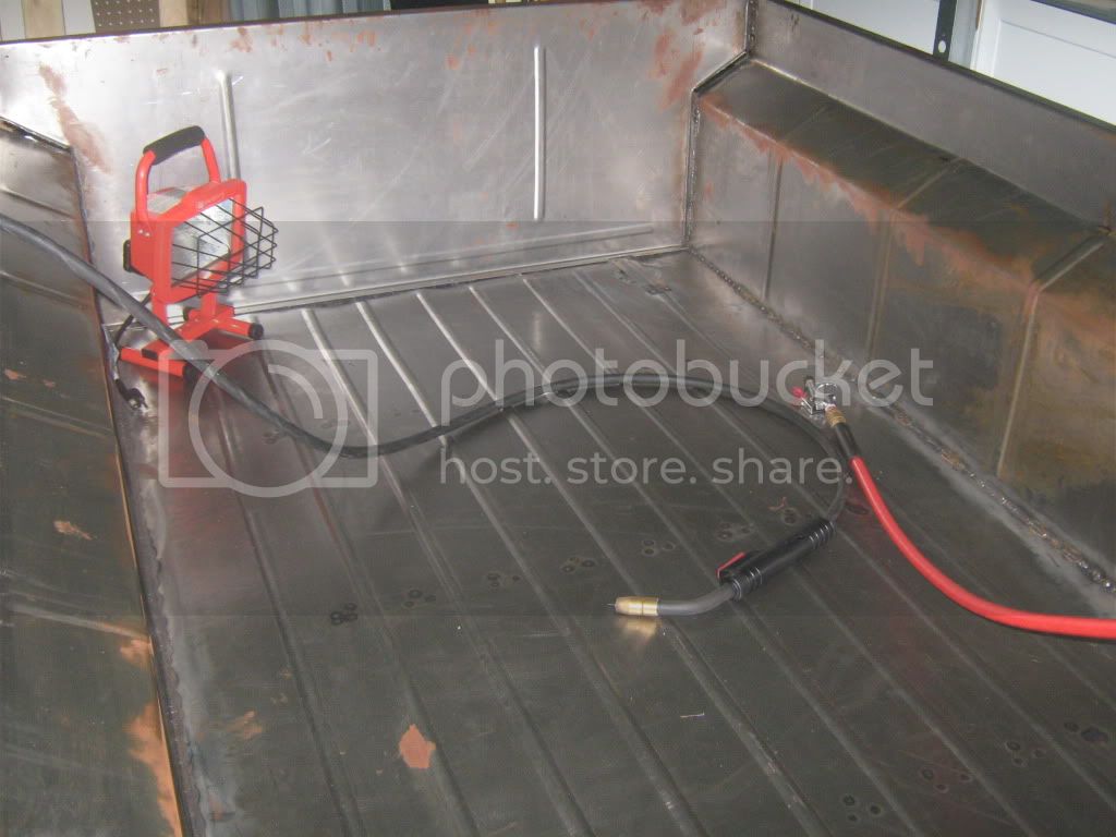

Here is some more photos of the tub, and progress. Fitted up the floor on the frame and stich welded it in. Also had to cut out some patches to fill up the gaps between the ended and the sides. Right now I am on my second bottle of gas, and dont even want to know how many spot welds I have made.
Floor on the frame. Had to drill some holes to spot weld it in. Actually, had to drill a lot of holes doing the tub. Have worn out many a bit.
Tub on floor for fitting
Here are some more pics of floor fitment.

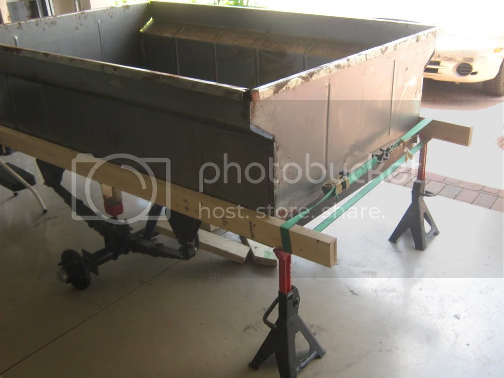

Here is how I pressed the sides down on the floor for welding. Ratchet straps and 2x4s are good for all kinds of stuff.

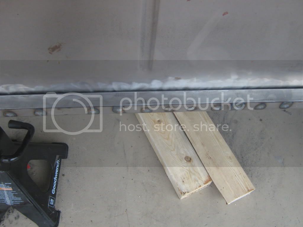

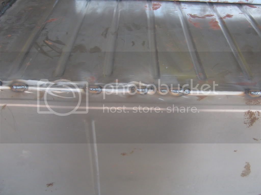

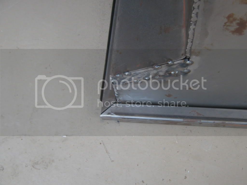

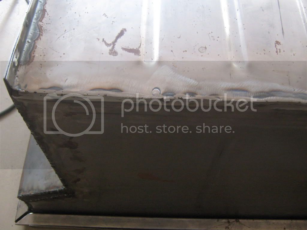

Here are some of my welds pre grinding. The occasional glitch here and there. Also, it did not fit up perfectly flush in some areas, hence the gorilla welds.
Flipped the tub over and more welding on the bottom. You can see where I put in the floor supports. Had to measure a few times to make sure they did not interfere with the frame rails. I still might need to modify them, as the bottom is a little wavy, and I plan on fabbing up a water tank holder underneath between the frame rails.

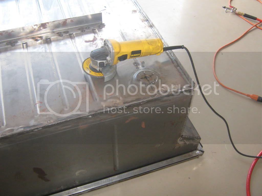

my trusty dewalt angle grinder. have probably spent days of my life on this thing, and never a problem.
