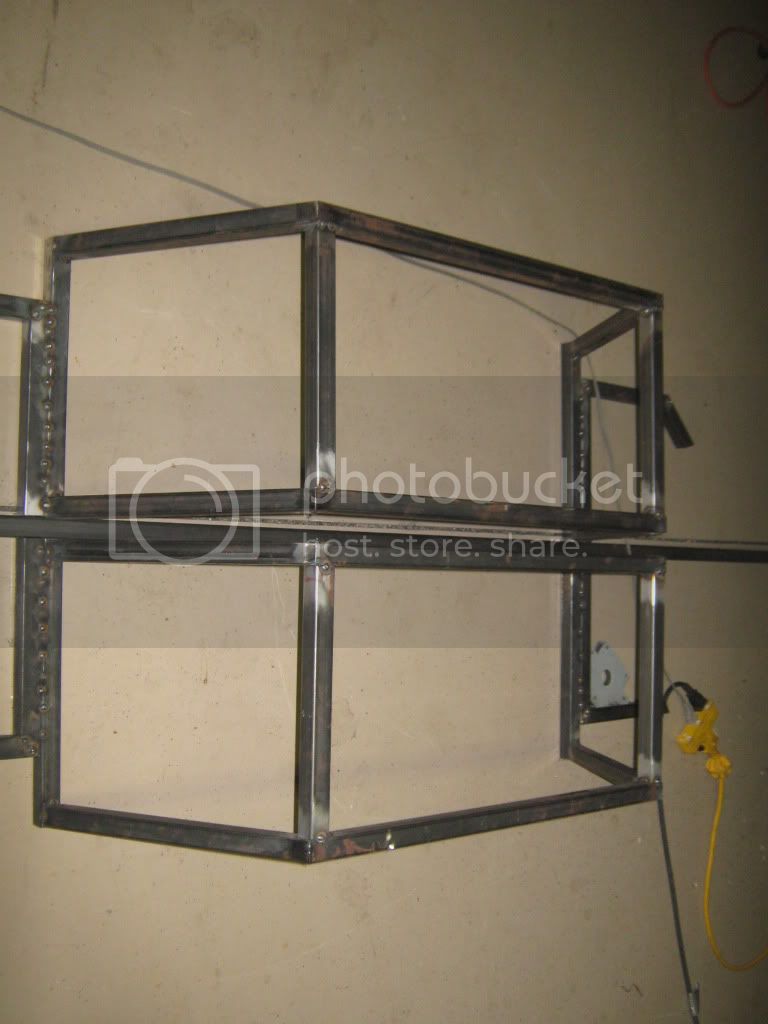

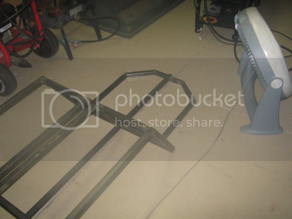

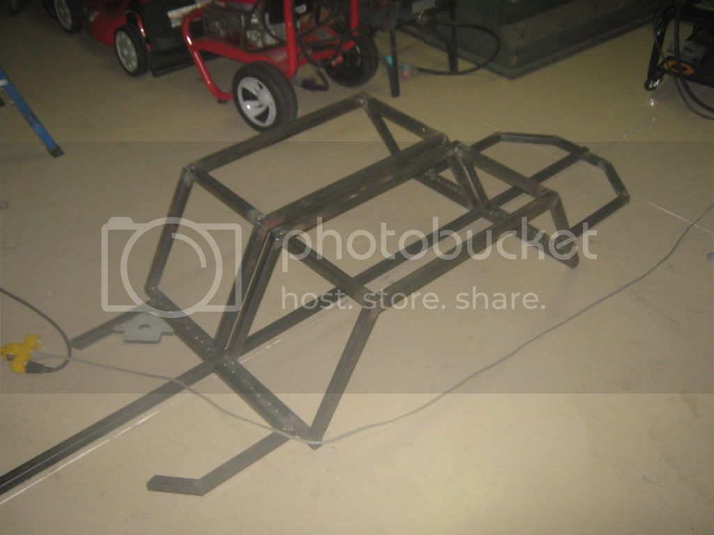

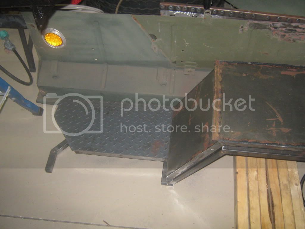

Been real busy with work and baby, and I can only cut and grind before 7 because of the little one, so not much done lately. I started mocking up the fender frames and steps. Here are some pics
I also thought I posted this previously, but it is not showing up on the site. I got one fender skinned but still have to cut and grind excess.

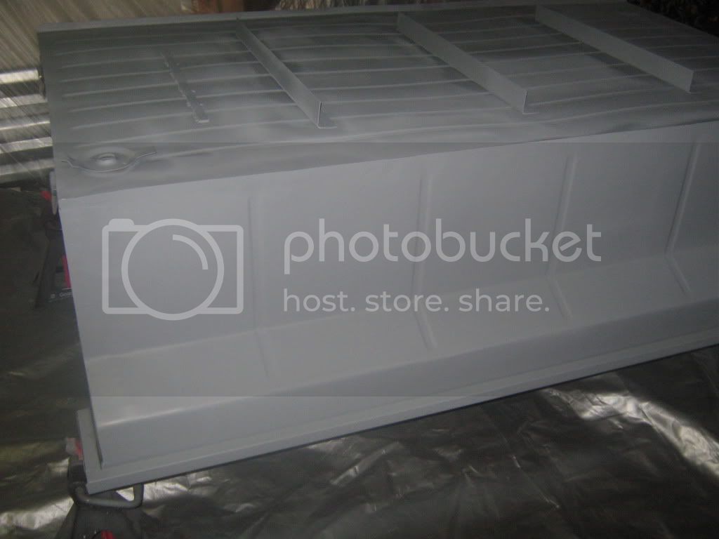

Also, decided the rust on the bed was getting bad, so it was time to paint. So far, just rust removal with the wire wheel. Hopefully will prime this weekend, then body work.

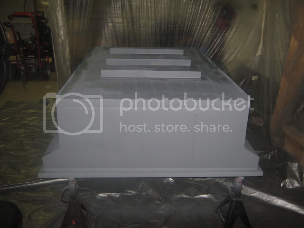

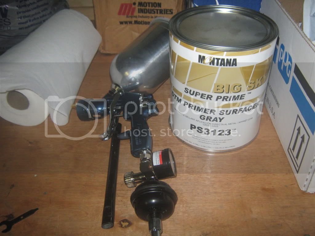

So finally got the primer down on the tubs outside and bottom. I always tell myself, this time Im not going to spill paint and get it all over the place. Never happens. Paint and I dont get along. Anyways, here is a few pics.

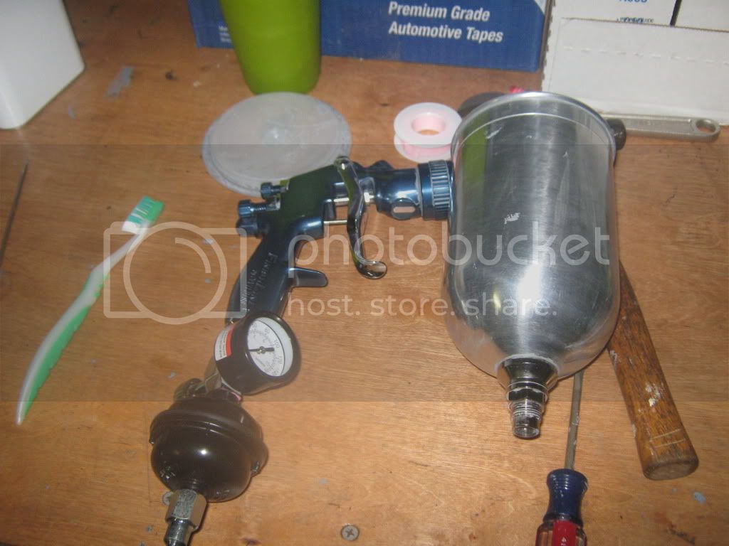

my gun
painted tub
